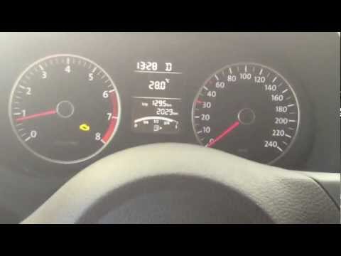

Hey that guy with the Polo TSI (top video). I'm pretty certain he has a problem with his engine - or engine related as contained within the engine control module. Not his DSG...(I'm in no way saying the DSG is faultless becuase mine has its fair share of retardation to annoy me)
But just saying the engine light doesn't come on for gearbox ONLY issues (as far as I know, happy to be corrected though) only the gear position and service light wrench flash - which means the engine control unit is effecting gearbox operation.
By the looks of it, it is not recognising that he is depressing the brake so the brake pedal which could be trippng up the gearbox not allowing to shift into a gear (this has been a confirmed problem) or one of the sensors in the engine that are required to make the gearbox shift with the engine timing is playing up.
You have to remeber these gearboxes run off of over hundreds of position sensors. If one plays up its either the engine or gearbox that will go nuts.
Also when I start my car it goes from 0 right up to 1100rpm and then down to idle. With his you can see it hover at 50rpm until it starts then go up to 900rpm. Could be different software displaying the revs but I think it could be using a different engine speed sensor.
What's with the flashing gear position indicator? Also my MFD shows a fully formed gear position indicator, but some of these videos show a 7 segment LED/LCD character display.

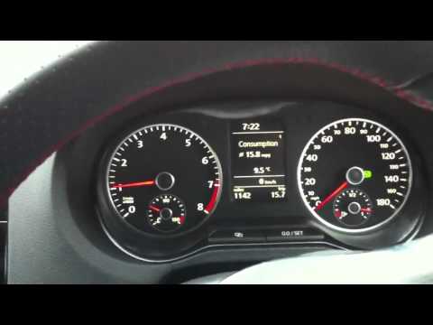

Only 1840km. And it doesn't look like heat is much of a problem with this one, as the ambient is 9.5c and the water temp is <90c

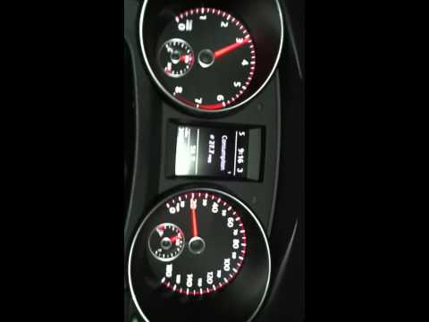

As for the flashing gear, I've not experienced this kind of false neutral (flashing light, or standing still, but have seen the one in the third Video), does hitting the brake help? Since the sign is up for him to do it, but he's not actually hitting it.
I had the gear number/letter flash when the issue would affect my polo TDI. It required putting it into park and restarting the engine to move again. It seemed to happen mostly in 'manual' or 'sport' but 'drive' didn't do it as much. I think I saw this video when I got home after it affected me then I realised I wasn't the only one...
