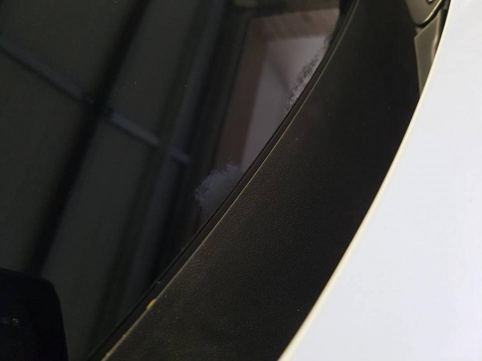

    New Golf R Wagon received a typically horrific predelivery that was sorted out by the detailer when ceramic pro applied. One thing the detailer couldn't/wasn't keen to attempt to sort was some unidentified black crap at the bottom edge of the front windscreen. See attached image. Anyone know what this is or how to get it off? Clay does nothing, neither does IPA.

      Can I ask can you feel anything on the actual surface of the glass , because to me it looks like moisture has gotten between the layers of glass . Windscreens unlike side glass and rear are made up of several layers two glass and a clear sheet of some sort of plastic , if water gets in between thats the effect you can see . Also try and use a razor blade to see if it is on the surface, if not then back to the dealer for a new windscreen under warranty .

        It's definately on the glass, in fact all the glass right at the edges, almost like black paint. I'll see the dealer has to say about it.
