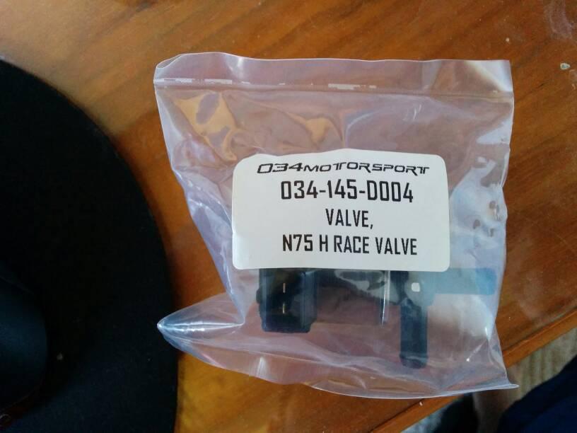

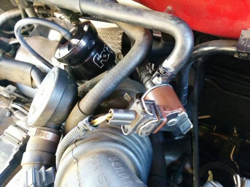

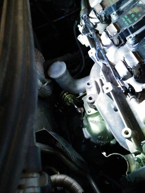

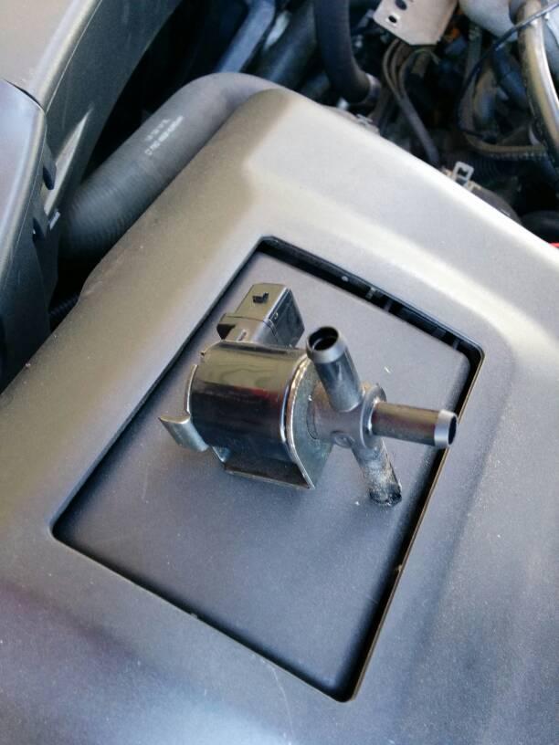

                        N75H race valve arrived today unexpectedly from 034 motorsports. 4 day shipping from the US. But anyway I put it in and took it for a drive, and boost comes on a lot faster than the stock n75. Something I'd definitely recommend for all chipped 1.8t guys.
                        Old n75
                        New one in

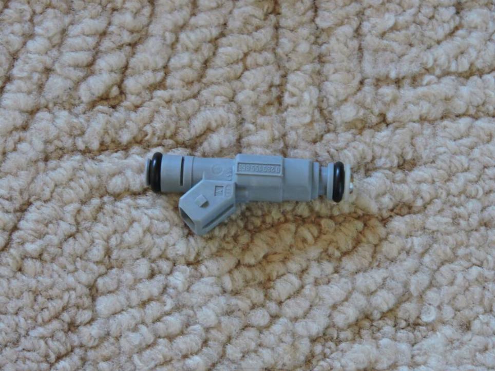

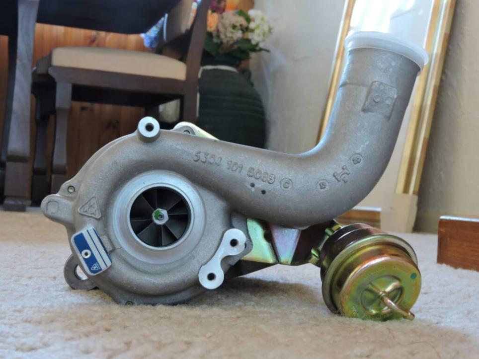

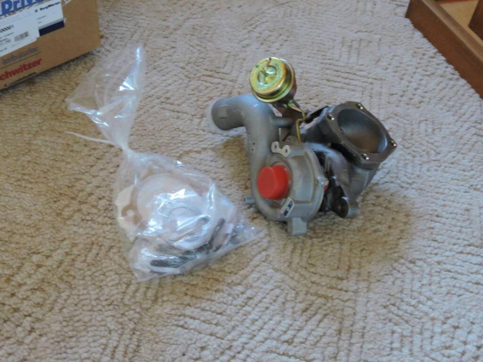

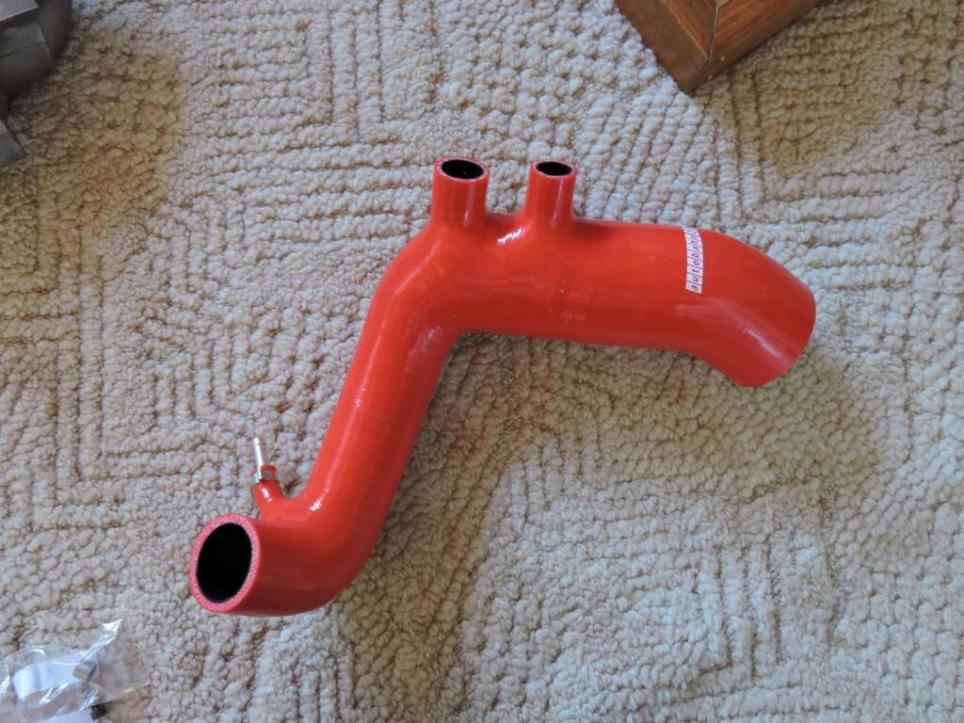

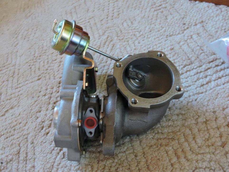

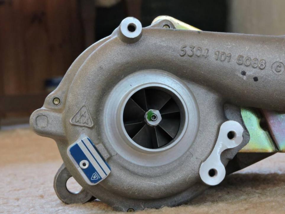

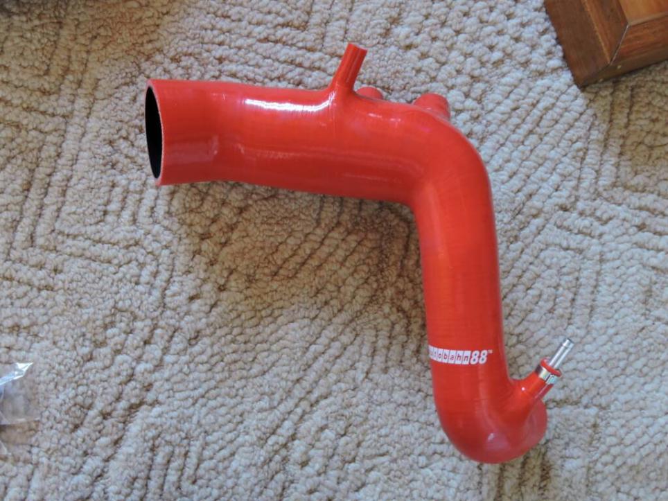

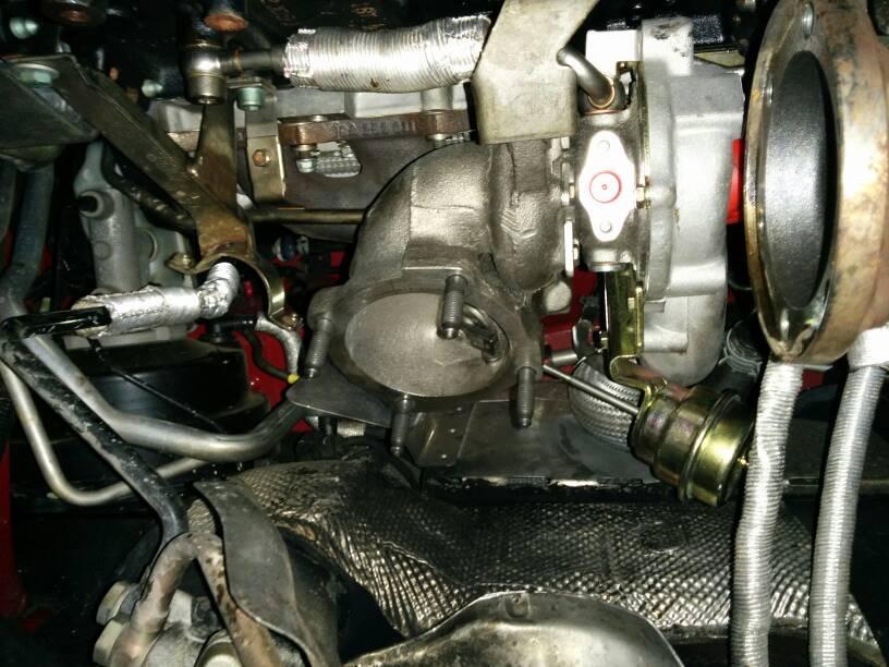

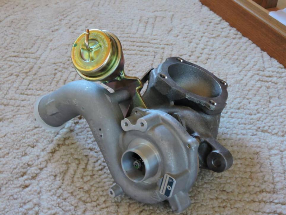

                                So I finally pulled myself together and assembled what I needed for a k04 upgrade
                                A little 380cc injector (1 of 4)

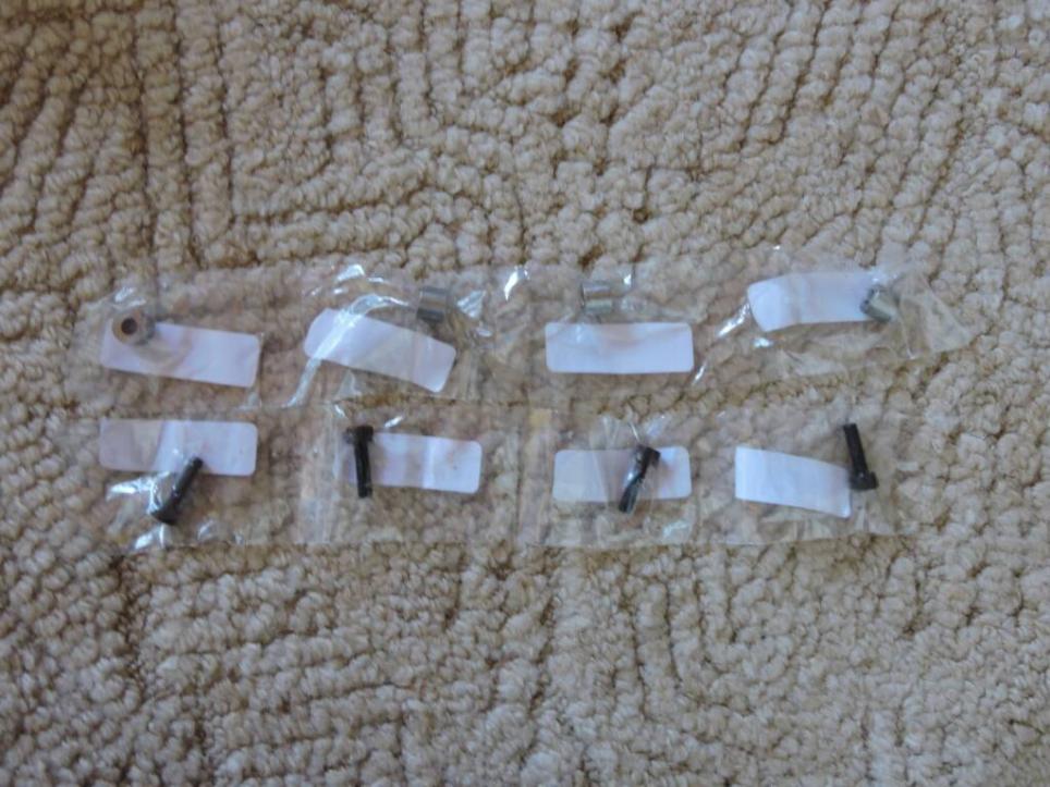

                                Spacer kit

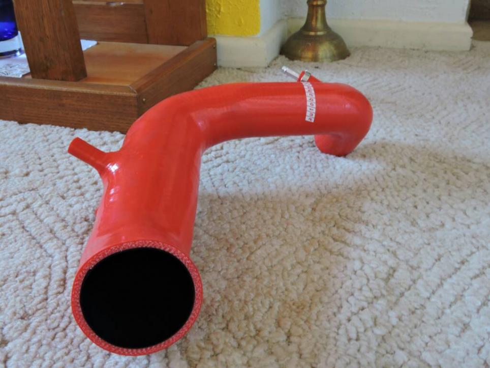

                                Silicone TIP from eBay
                                And finally the turbo itself. The k04-001 which came with an installation kit from ecs

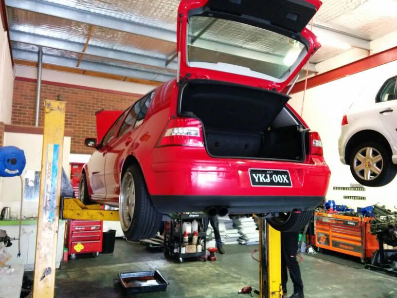

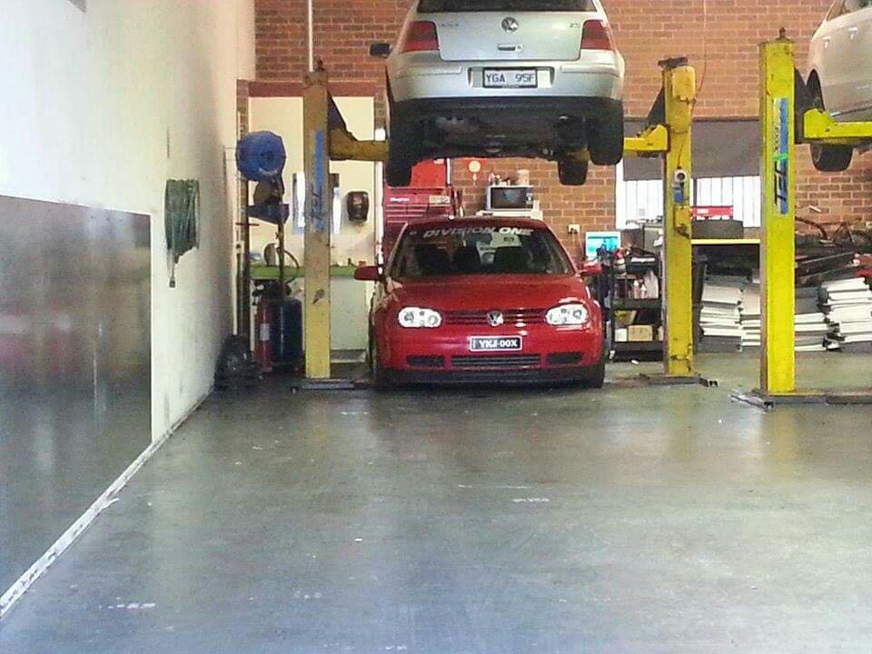

                                The turbo went in the following week which I got it, and I went in the day after I dropped it off to get some stuff that I left behind. I got some potato shots while I was there too. Thanks to Gareth from north side European for the install
                                Spotted by my mate while he dropped his car off for a service
                                My mechanic was going to tune my ecu, but as it's an old ecu he couldn't communicate with it, due to his software that he deals with (quantum tuning). So I've been driving without the tune, and I plan on sending my ecu to Exoticars and get a giac chip.
