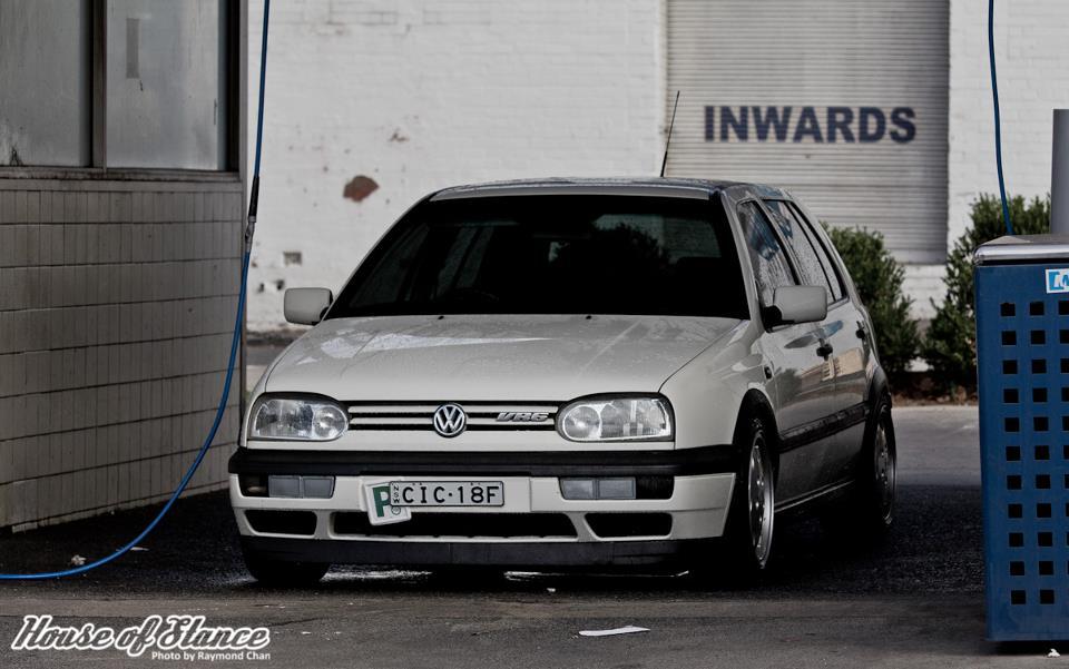

    Hey fellas, thought I'd make up a thread for my white 1994 mk3 vr6. Some of you are already familiar with the car as it was previously owned by Bima (mrVR6exy) another form member and a top bloke! Wasn't actually in the market at the time but had met Bima previously and loved this car so when I saw that he was looking to sell I jumped on it.
    Probably the two most noticeable modifications made to the car prior to my ownership are the mk4 gti recaro seats front and back (my favourite thing about it) and some fk coilovers. Am very happy with the car as it's been maintained to a high standard meaning everything works (ac, heater, airbags, abs, all power windows) which can't be said for a lot of mk3s
    This is pretty much what it looked like when I bought it.

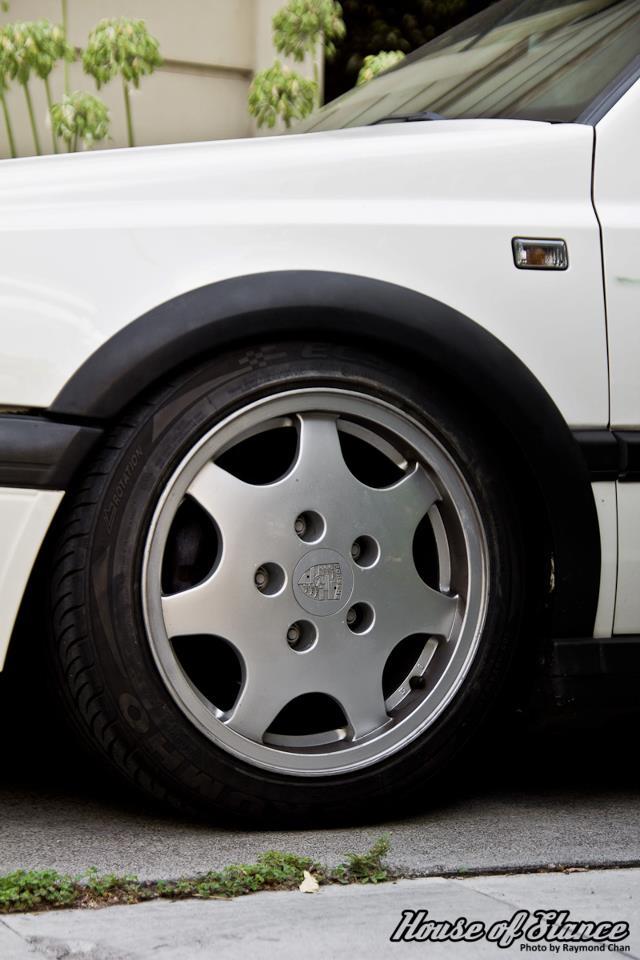

    Throw some Porsche D90 wheels on, wind the coils down a little, got some white plates and this is what it looked like when I went down to Melbourne for ILV SummerSun2013 show. (thanks for the pics Ray and Lee)

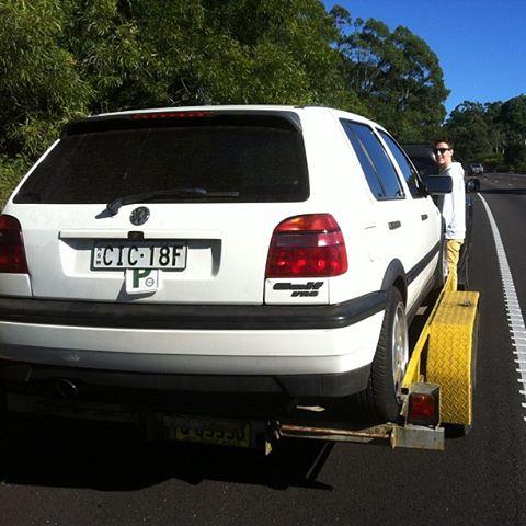

            Recently got some brand new Hella all red tailights and installed airlifts autopilot v2 air suspension kit. Had a few issues leaving me in awkward positions one being yesterday morning leaving home at 9am for the ALL STARS 'stance off' show at Silverwater park when my exhaust made contact with my rear air line burning a little hole in it and consequently dropping its arse at 110 on the freeway. Safe to say there was a lot of tyre burning smoke flowing out the left rear guard as I pulled over very suddenly (apologies to camry driver behind me).
            Luckily my girlfriends dad came and got me with the car trailer (only just fit with the wheel widths, now have yellow trailer paint on my lips) and a couple hours later ran a new line with some more protection (exhaust wrap / braided hoses) and made our way back down again. Arrived around 2pm as a lot of people were leaving (was meant to be there at 11).

                Is this stock height?
                How did you get Porsche wheels on there?
