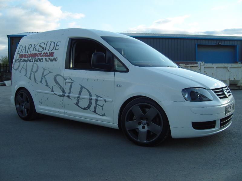

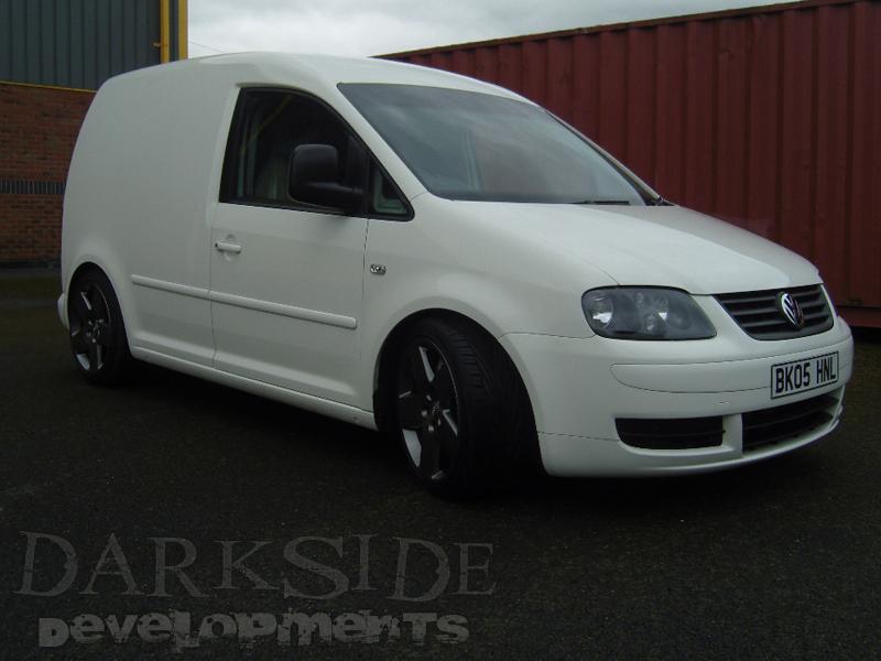

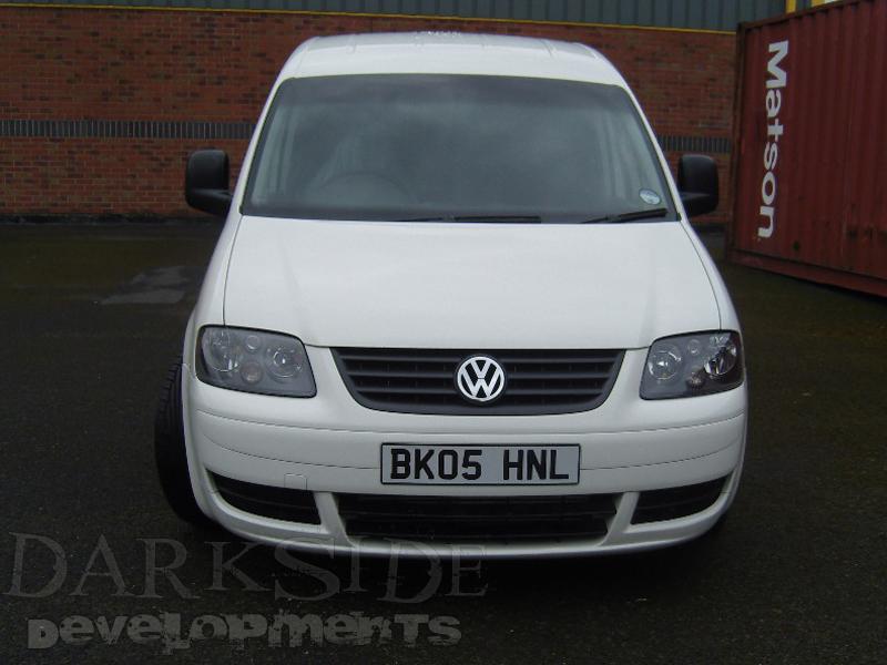

Thought it was about time I posted a topic about my other project. Its just about finished now, getting the stickers on today and drag racing on Sunday at Santa Pod, anything in the 14's will do me as its a heavy bugger!! Taking the Jetta too with a few tweeks so hope to beat the 13.8 we did last year in that!
(steering wheel changed since!!)

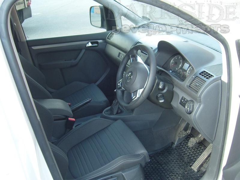

Bought it as a Boggo 1.9 TDI 105PS 5 Speed with a blown engine. Over the last few months when I have had time (only a week or two work in it really) I converted it to a 2.0 16v BKD Engine, 6 Speed Box, big turbo kit, widetrack etc

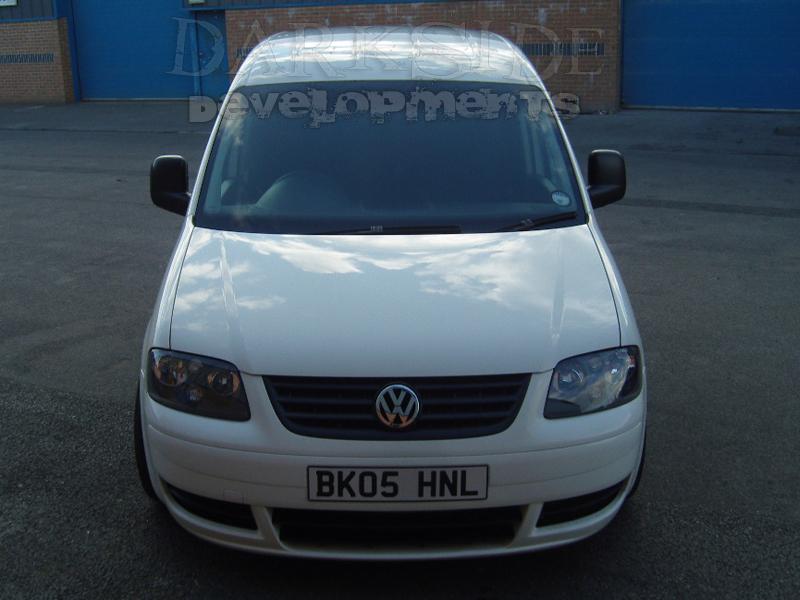

Touran Front Bumper with Non-Fog Grilles
Touran Black Upper Grille
Touran Sport Black Headlights
Sliding Door Rail Cover with R.A.D Bracket
Colour Coded Bumpers and Mouldings
Electric and Heated Wing Mirrors with LHD Spec Drivers Mirror

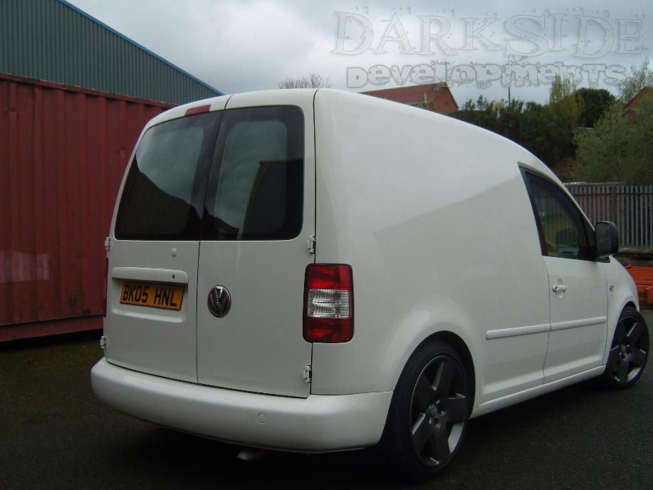

Black Rear Windows with Genuine Rear Window Guards
Rear Wiper Delete
Pressed Numberplates

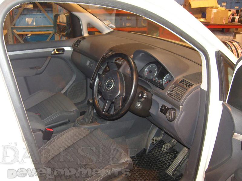

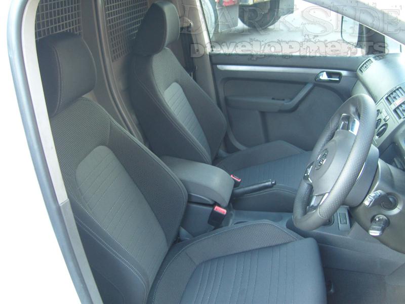

Scirocco Cloth Front Seats
Touran Seat Consoles with Storage Boxes
Golf VI R Flat Bottom Steering Wheel
Touran Black Dash with Glovebox
Touran Sport Half FIS Clocks with Temperature Gauge
Touran Centre Armrest, Leather Handbrake and Centre Console
Touran Black Carpet and Plastics
Golf GT Gearknob
Cruise Control Stalk
Parrot Bluetooth Handsfree Kit
Interior Light with Map Lights and Microphone Port

It will eventually get a GTB2260VK turbo and Race PD Injectors so 300hp+ the same as the Jetta now, but I like the way the smaller turbo spools instantly so its staying like this while I use it for picking parts up!!
