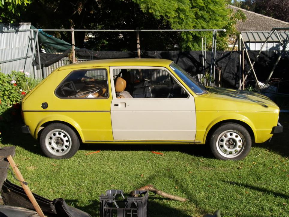

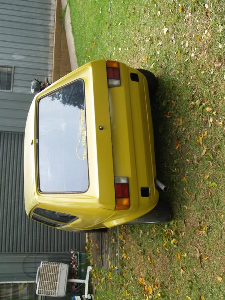

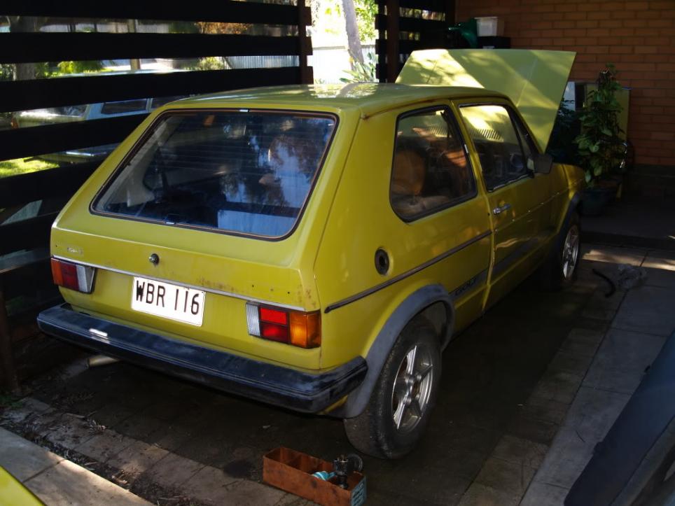

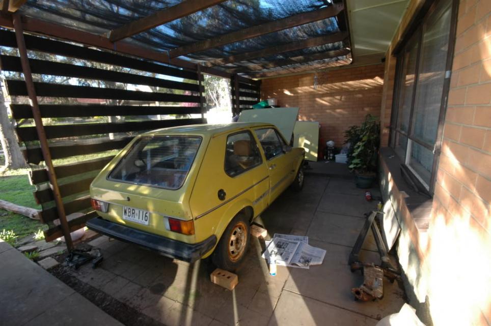

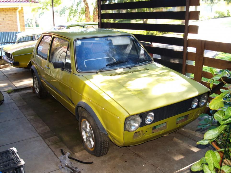

    About 4years ago when i got home from school a couple of weeks before my 15th birthday, there was a trailer out on the street with 1976 mk1 golf LS sitting there. later on dad told me that our family friend had it sitting out the back of his work shop and asked us if we wanted it. we accepted, because it was going to be sent away for scrap metal.
    as it looked a couple of weeks after it arrived (looks a bit sad and run down)

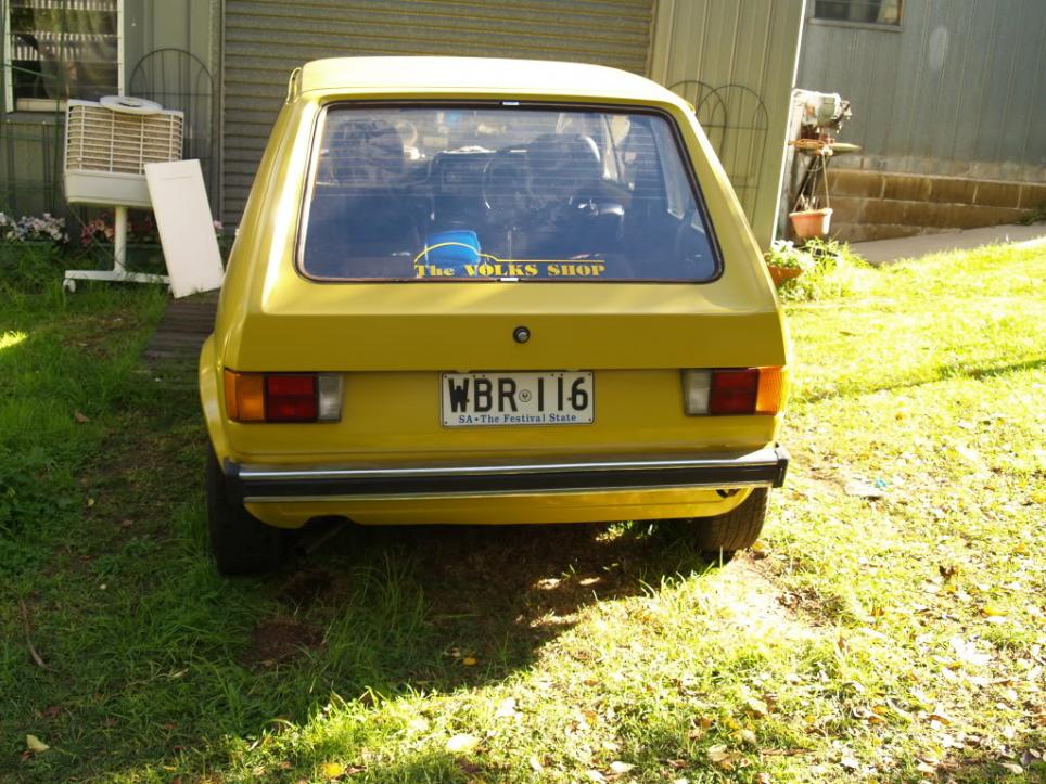

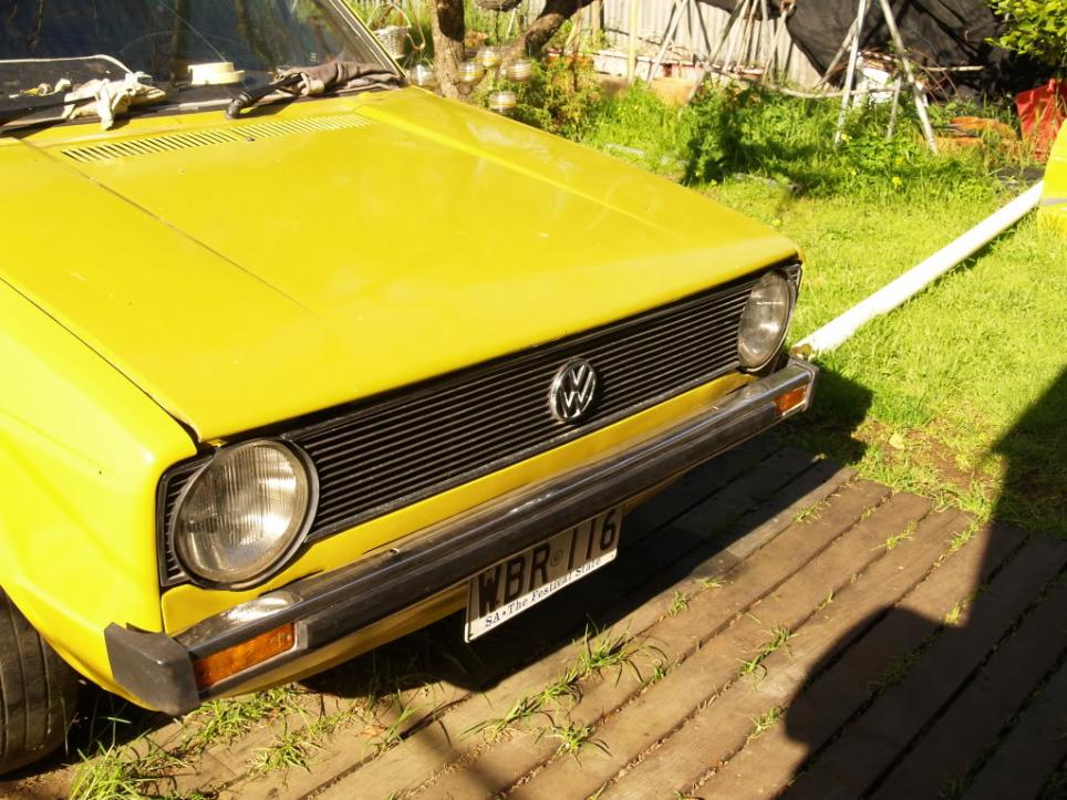

    it was then moved to our back yard due to the fact we were extending our house. when it found its new home for the next 3 and a bit years, i gave her a well deserved clean

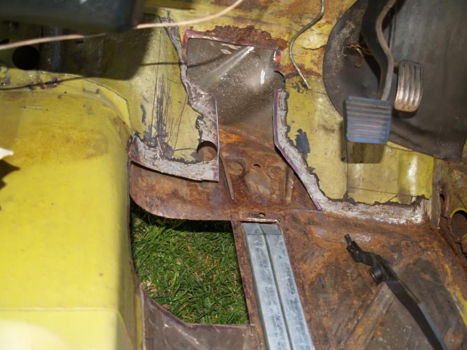

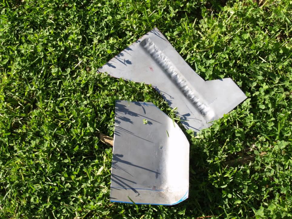

    this is were the story gets a bit sad. i pulled the seats and carpet out to see if there was any rust in the floors and how bad it would be. it turned out to have few holes in the floor. nothing me and some help from my dad wouldnt be able to fix. i didnt get any before shots of the rust but i got some after i cut it all out.

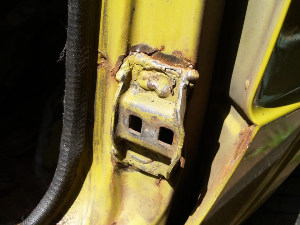

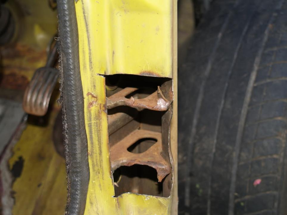

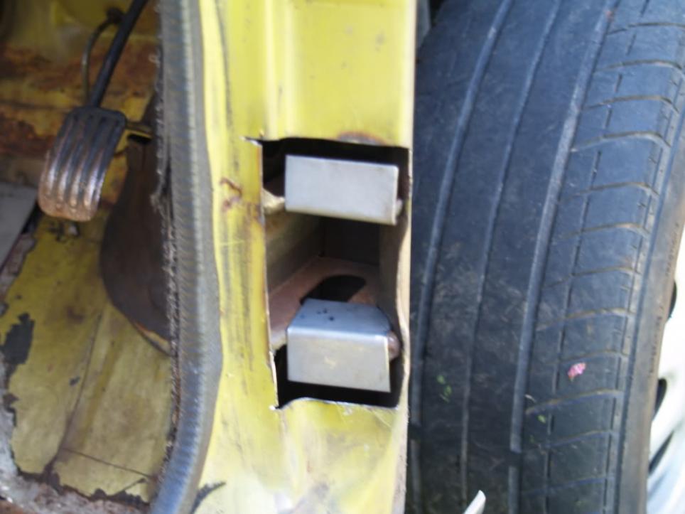

    i then took the drivers side door off. for 2 reasons. easier to get into the car and weld the new pieces in, and because around the hinge mount was rusted and cracked because the back end of the door had been hit. bent the door slightly and cracked the mount.
    new pieces to weld in
    hinge mount, before repairs
    hinge mount, during repairs

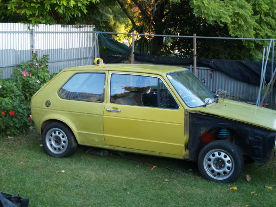

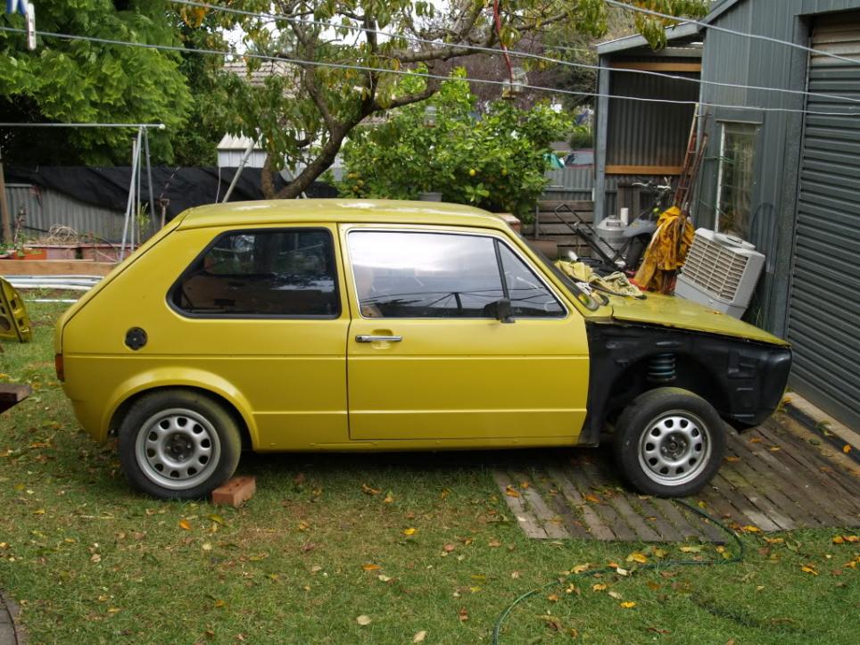

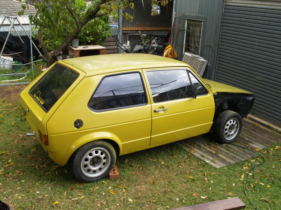

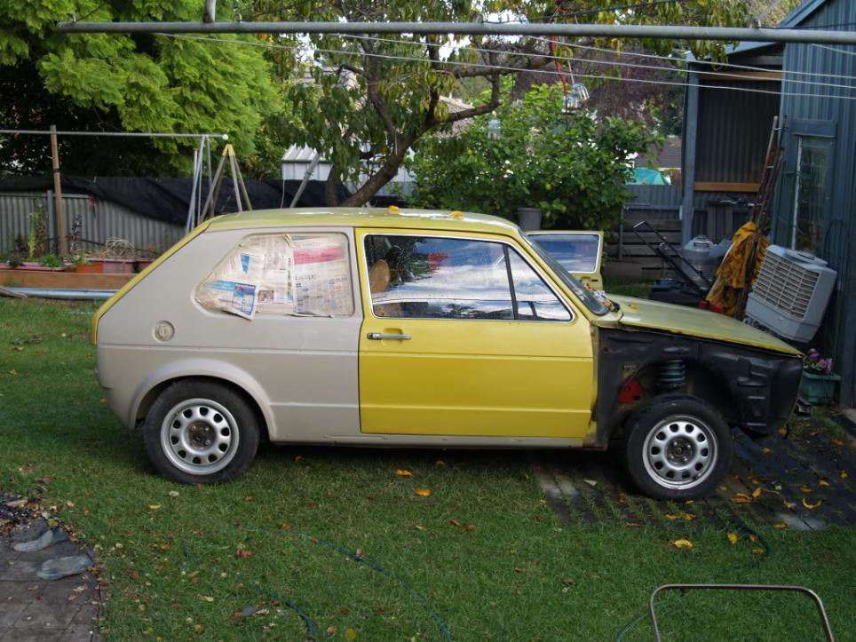

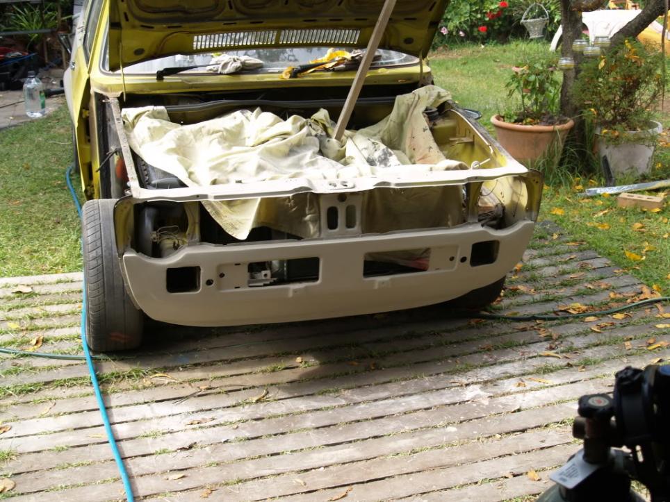

    I sourced some better condition doors and a fairly rust free boot lid. Original one had rust all the way along the bottom. So once i had finished making up all the repair pieces for the hinge mount and the floor. it was time to put the new door on (after about a year and a bit), it had been sanded back and primed ready for colour.

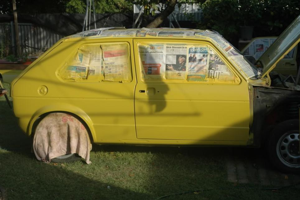

    next step was to paint the doors and boot lid in colour. so my brother took the paint code from under the bonnet of the car and went to the local paint supplier.my brother then painted the drivers door in colour. the colour the supplier gave us wasnt the same as the rest of the car. so it ended up being a long week of sanding. early mornings, dry hands, paint dust up my nose and completely covered in it every day for a week.

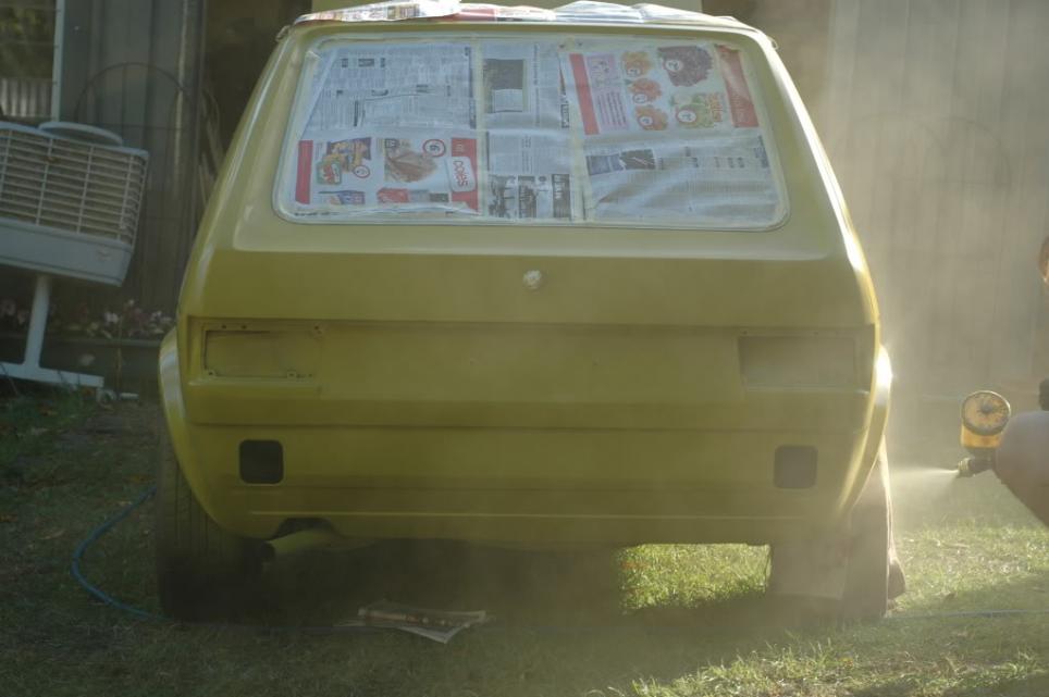

    my brother then layed down primer on the rest of the car. apart from the roof and bonnet, we're gonna tackle that at another stage.

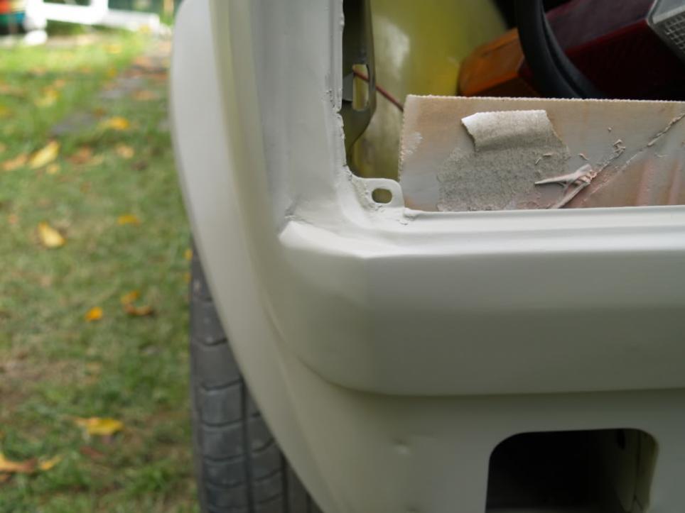

    there was a small amount of rust under the passenger side tail light assembly so that was repaired and reshaped. and while we were putting the small amount of bog we did put on the car we removed some of the ugly join lines between the rear arch and rear valance. personally i think it looks a lot nicer with out them
    next up is colour 4 coats of it

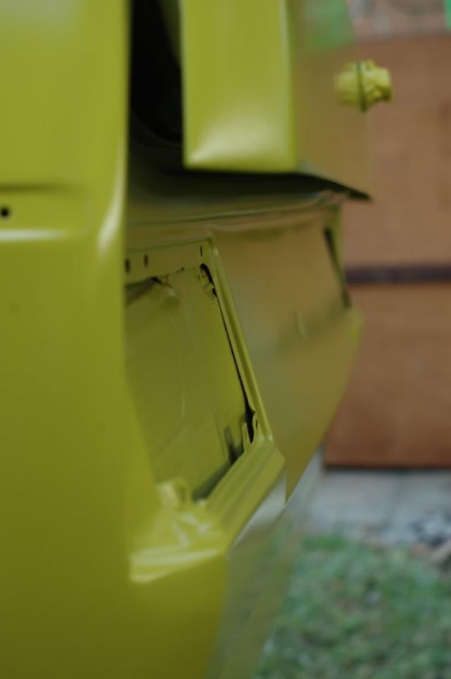

    this is my favourite shot i took while it was being painted
    it then had another 2 coats of clear and colour mixed 50/50. came up beautifully

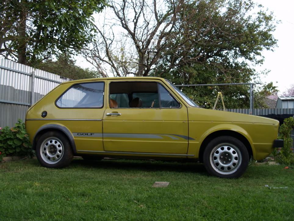

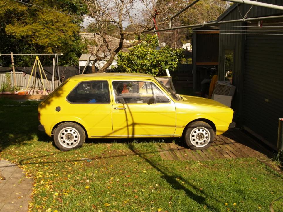

    its pretty much back together now. front guard is on, chrome bumpers are on, grill is on. just a few more things and it will be on the streets of adelaide.

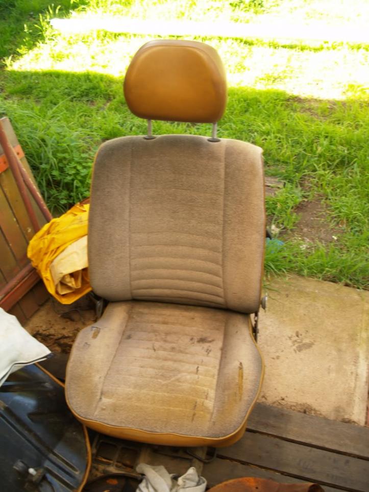

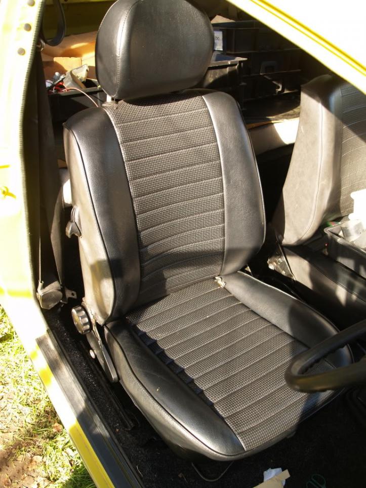

                        i also got some better seats from a friend of mine.
                        original seats
                        new seats
