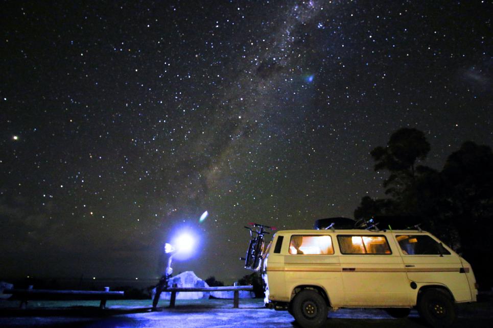

 I have just come back from an overseas trip. Before I left I did have time to do a trip in Harold though!
 We went up to Mansfield and Mt Buller for the weekend to watch Targa High Country rally, it was epic fun!
 Car drove perfectly fine, was very good on fuel and the gear ratio wasn't too bad. Still a bit to work on though. Overall did 300km as a test for motor. We also noticed that once the exhaust settled in, it was actually annoying loud. So I might add another resonator to make it more drone-less.
 I took some pretty cool shots, but the only one on my phone at the moment is this one.

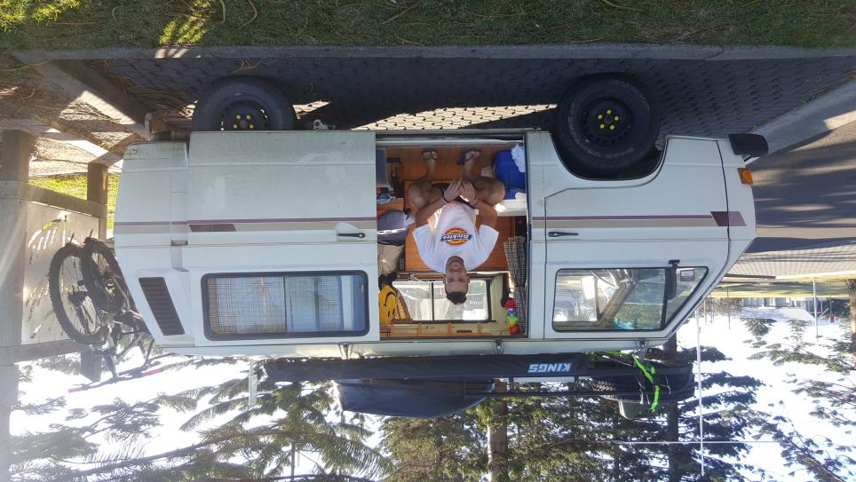

 I recently did a south-east coast trip from Melbourne to Gold Coast over a short period of 3 weeks. Had some time off from work and thought why not put the van to use!

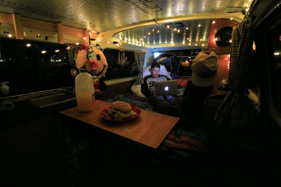

 This was the living quarters for the duration.

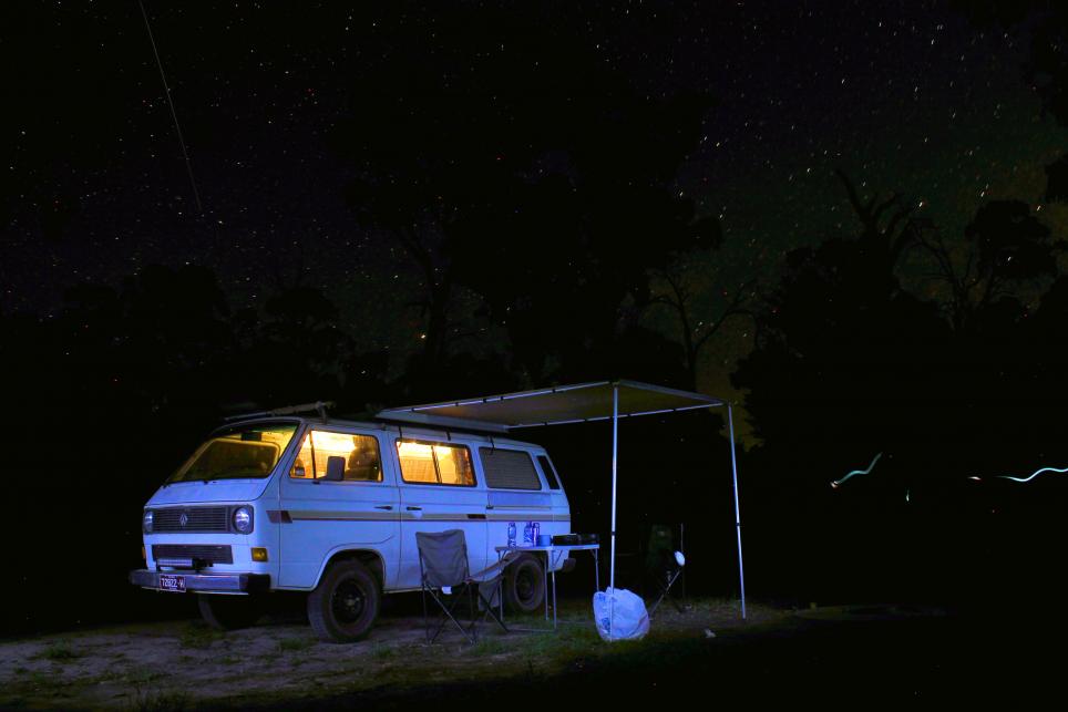

 Did some other cool stuff along the way too, enjoy! =]
 It was an awesome trip with so much cool stuff to see in between. Overall did around 3825km which cost $836.11 on fuel, and funnily enough the day I left, the fuel gauge just decided to stop working... luckily I had a jerry can - because I ran out of fuel twice haha.
 I've also realised I will need to invest in a fridge/freezer as using the esky with ice was just not good enough. Getting a fridge will mean I'll have to get a solar panel and what not - but at this stage I just don't understand the whole concept, so will require more research before I can commit. If anyone has done an install of their own and can explain to me how the system works, ie; solar panel goes to a distributor of somesort, then to the aux battery etc?
 I was also really shocked it made it so many k's with zero problems, I think I was expecting problems considering it was a driveway build, but surprisingly none at all apart from fuel gauge not working.
