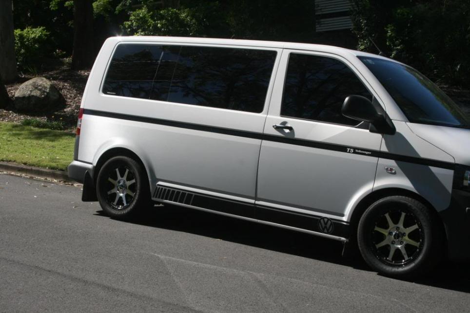

    We are running a complete Bilstein system coil over springs and shocks front and rear on our 2012 T5 SWB van , really happy with ride etc we did lower the van 40mm in the process .

        Well it was around 4 plus years ago I did our van as I ordered the kit from the UK much cheaper than local supply . It is similar to this one as they have upgraded the kits since then VW T5 T5GP Bilstein B14 Coilover Suspension Kit For T32 1BH Chassis 47-222564 We have never had a bottom out situation even fully loaded with trailer 3 MX bikes and bucket loads of camping and riding gear and 3 passengers on board . Only the slightest bit of stiffer ride than standard but its hard to pick .
