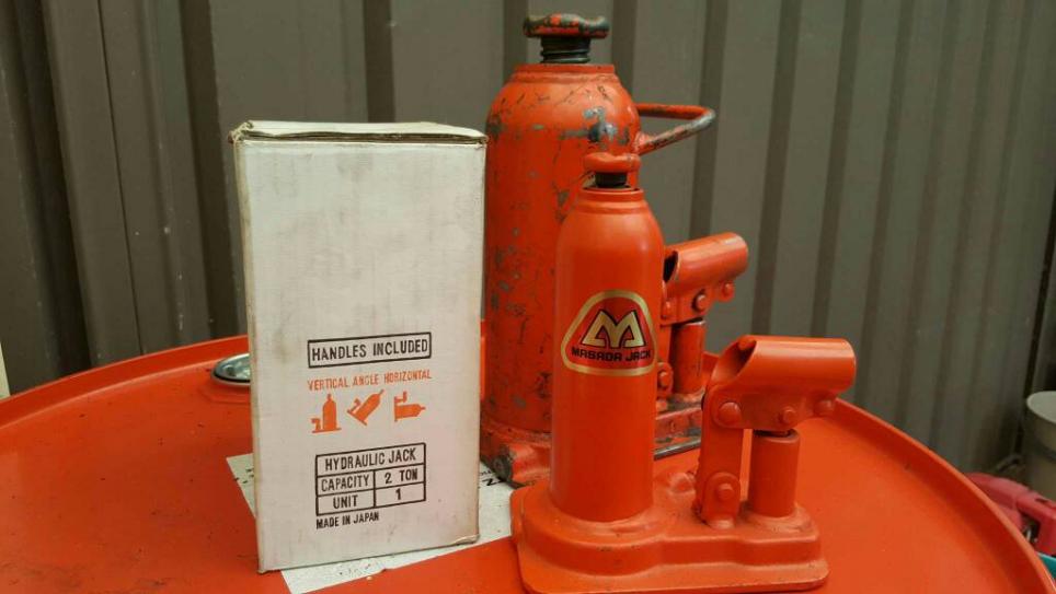

      The Seikel jacks are 189 euro, so around 400-500 to get it here, I'm just inclined to find something cheaper.
      Wooden block are gold out there, they have come in handy before.
      There should be 2T, 5T and 10T Masada at SCA.
      Sent from my SM-N920I using Tapatalk
      Performance Tunes from $850
      Wrecking RS OCTAVIA 2 Link
      • #18
        Im heading down to super cheap tomorrow, ill have a look while I'm there
        "Made in Japan" you don't see that much these days,
        Cheers
