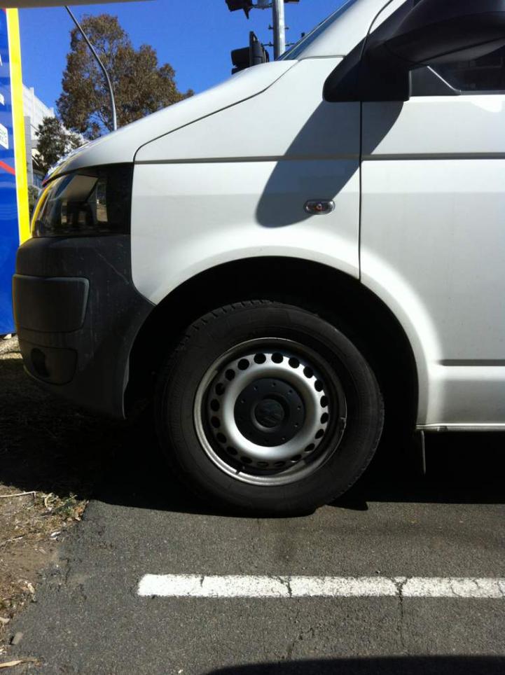

      No matter how expensive the 17" tyres are for my T5 4mo, I like the look of the 17" stock steel wheels. They are inexpensive too.

        Sort of agree Transporter but 16's are a bit on the small size for the T 5 's wheel arches 17's or 18's are going to give a better look in filling out the arches . Cost wise well that's always the owners decision .
          You confuse me now.
          I have the 17"steelies on my van, never had 16" and I agree with you that they look small.

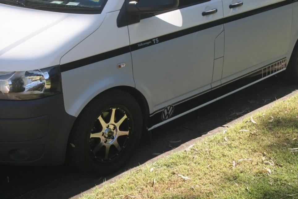

                          i have actually put 20" range rover wheels on mine. Found them on ebay for $300 for the set of 4. They had the required load rating of 850kg per corner. Then went and got 275/40 R20's from Bosman tyres for $155 each fitted. These also had a legal load rating of 106 which is more than the standard 103's. Also had to get range rover conversion bolts from ebay to fit the wheels on.
                          The tyres perform really well even on wet roads. The only draw back is tyre noise but keep in mind it is a really cheap tyre. Am upgrading to a Nexen tomorrow actually as the fronts went out of alignment and wore the inside left tyre bald. Hope that helps!

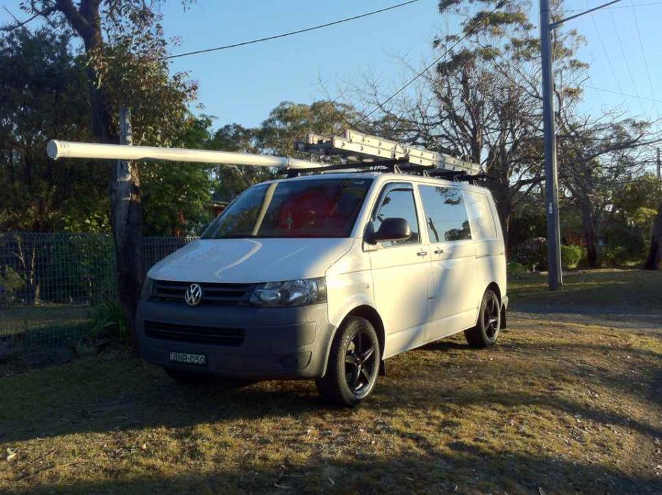

                            Sourcing nice wheels with the required load rating in Australia is a pain, I ended up going with 17" Ronal r41 in trend color from performance alloys in the uk. All 4 wheels landed here for roughly $1300 shipping took 4 days from UK to Sydney.
                            I had a thread here -
                            With some good info from members on sizing pros & cons.

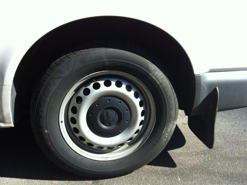

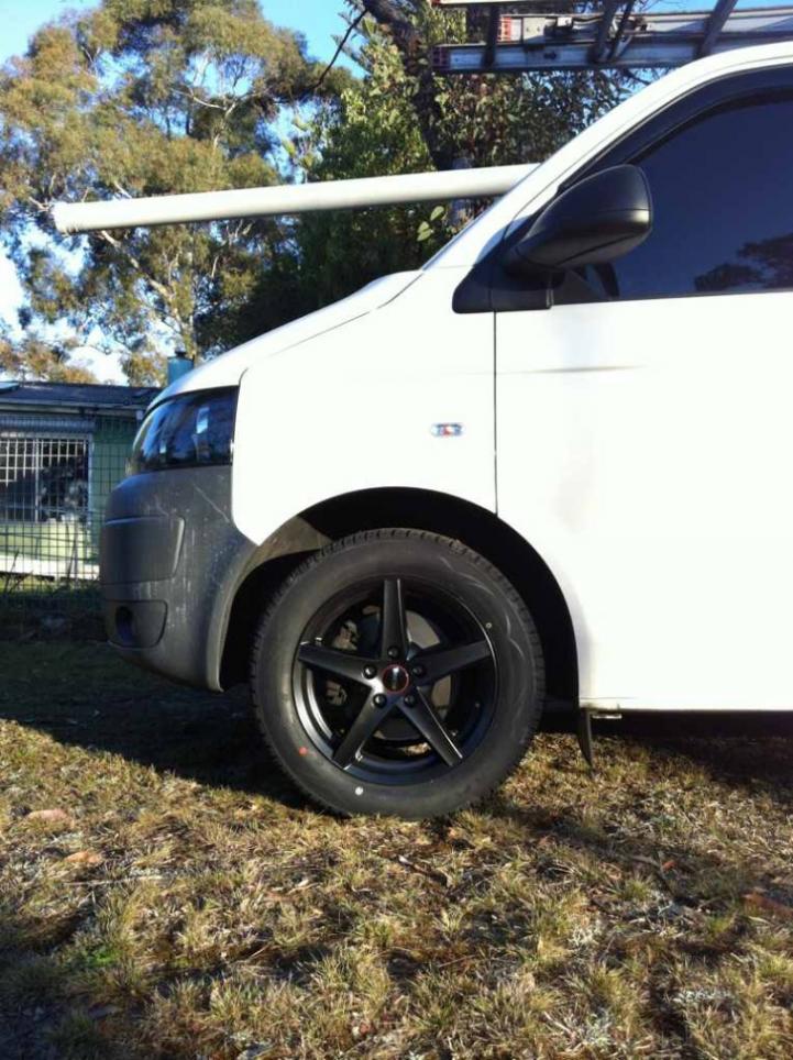

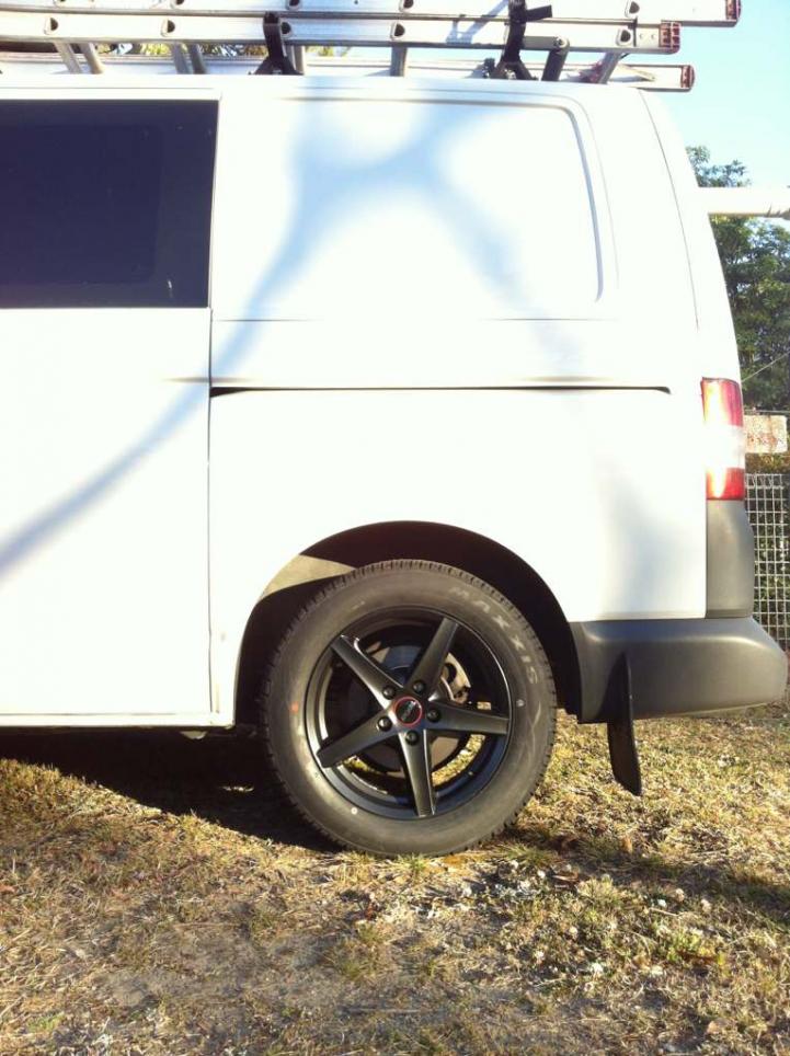

                            Here my 16" steel to 17" pics
                            From this
                            To this
                            Best part about these wheels was the change to where they sit. Much closer to flush with the sides of the van which made it handle much better and sit more solid on the road.
