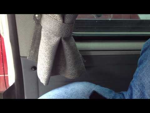

I have used then with great success to hold up the blackout blinds which now stick to metal around the windows. I initially got the idea from here: However in my build the magnets go all the way around the material and there is no curtain rail, so the whole curtain can be easily removed in a second.
I am really happy with the results holding up the curtains. I am using blackout curtain material which is quite thick, but the magnets still stick really well.
