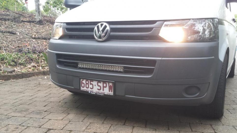

Hi Hayden check ours I fitted the Cree Light bar so bright wish I had one last year on my work van . I was coming back from Cherbourg and a damn deer stepped out in front of me in the dark nearly s*&&t myself . The T5 like yours can be done its a bit harder than the early model because they changed the front section .

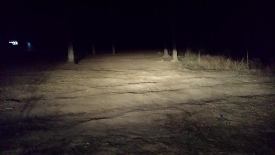

Normal high beam

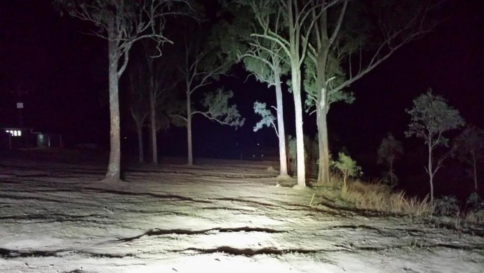

With Cree the trees in the distance are many hundred metres away .
Hi SSG the light bar is only activated when the high beam is on , believe me if you were to have the light bar on with normal lights you would find yourself on the receiving end of an angry mob of blinded drivers !! . This is the one we have on both our T5s the early T5 is easier to fit as the grill is different on the later T5.1 19 6" Inch 126W Cree LED Work Lamp Combo BAR Light Truck Boat Offroad 4WD Lamp | eBay It takes around two hours to fit wiring is easy just fit a 40amp relay and connect to the high beam trigger wire and that's it .

So you reckon this is easier to fit in our 2007 T5 (where the grill slot is about 22 inches wide) which is narrower than the above slot in your pic ?

Am about to buy one of these 20" 126W Cree light bars for my T5.1
I can see the cuts in the plastic that are needed and think I understand the wiring.
But with the T5.1 does the front bumper have to be removed?
And does this light bar attach to the existing front bumper metal frame?
No other bits I need to get?__________________________________________________ __________________________
VW Transporter T5 MY10 Van M 6spd 2.0DT 103kw White. Long wheel base. Standard roof?
Hi again no problems with info first the wiring is easy the light comes with a heavy duty "extension " lead you run this up behind the grill and then into the battery box one wire to earth then use a40amp relay and use a trigger wire from the high beam to activate the relay which then directs power from the battery straight to the bar . Now mounting I just got under mine to see as I cannot remember the exact details , from what I can see you cut the 3 vertical bars but leave about 10mm at the top of each one , then there are 2 horizontal bars again I cut and left about 10mm at each end . I would have to remove the whole bar to give exact details as I did mine about 5 years ago . There is a metal bar just below the place where the light fits so you could make up some custom brackets to locate it on that . I have a hunch I screwed a couple of screws into the each end of the bar to correspond with the horizontal bars of the grill This would have held the bar in position horizontally and then I may have used some more screws to go down through the vertical ones from the top to hold it securely . I am really sorry I cant be more precise as when I did it I just used my ability to see the best way and it worked . Hindsight is a wonderful thing I should have taken photos during fitting NOT after HA HA . Just make sure you measure the bar so as to only cut the bits necessary this makes it a nice tight fit rather than cutting too much . Now if you look at the third photo down out of the four I posted that's my T5 you can see the two horizontal remains of those bars the bottom of the light bar is basically sitting on the lower part of the opening . There is no need to worry if its tilted as the light beam goes in all directions . I am dying to park on a dark road and quickly flick the high beam light to see the reaction as it looks like a speed camera flash going off !Last edited by Sunny43.5; 31-05-2016, 05:15 PM.
