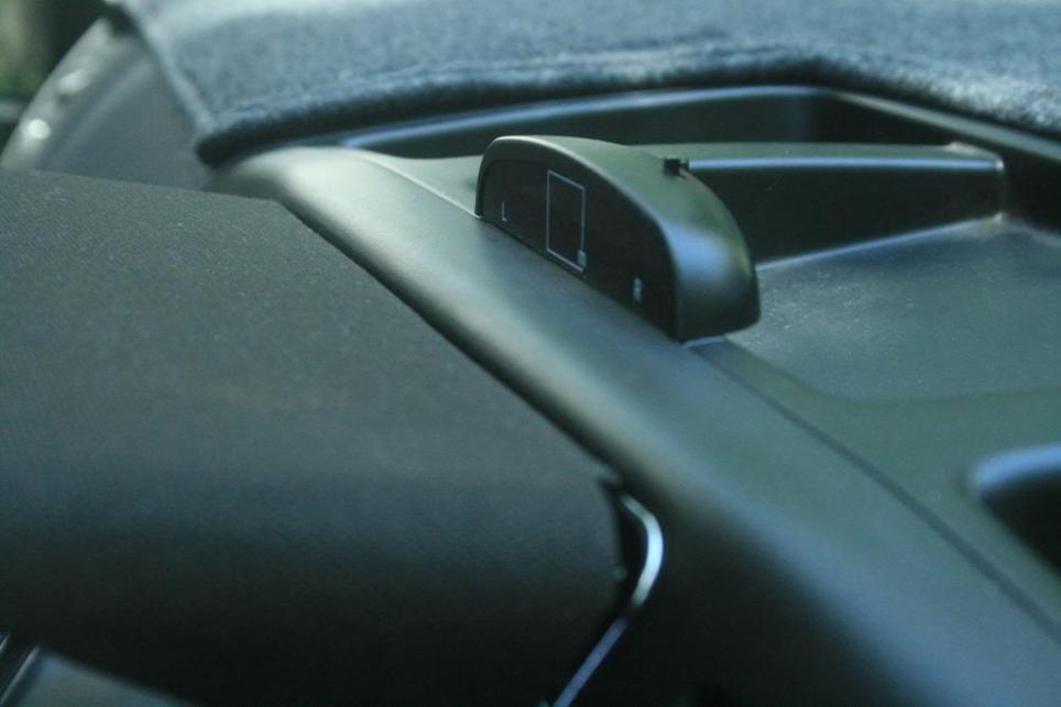

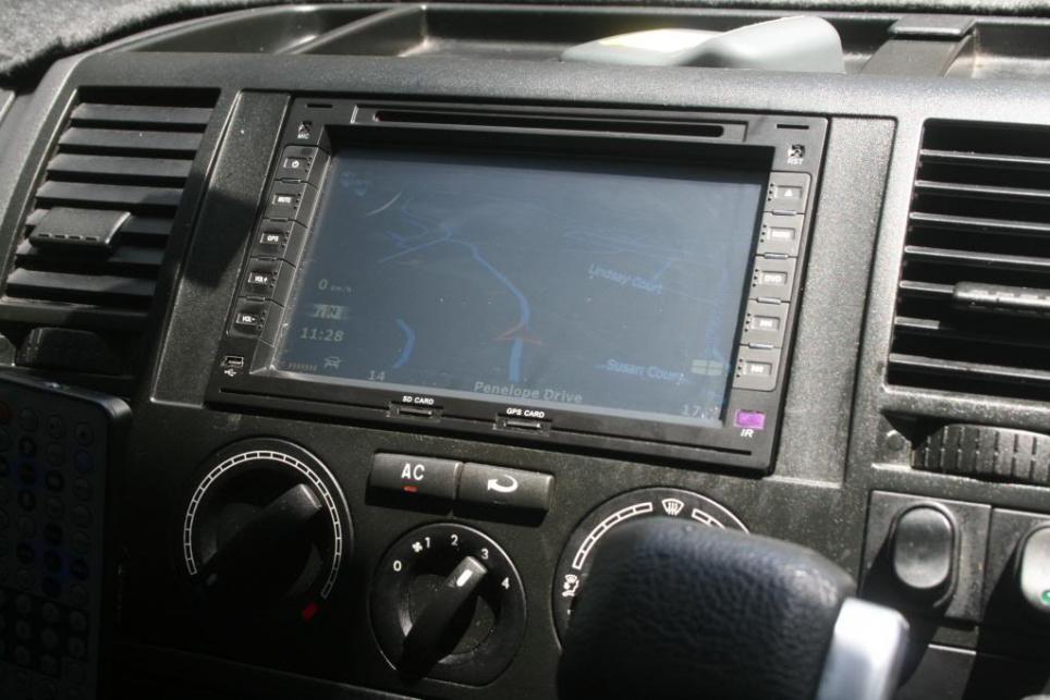

    I posted over the weekend some solutions to shades for head units for T5 and T5.2 apologies to all as I forgot that the original post was for OE radio stuff my mistake . Someone had asked about glare being a problem and I posted some pics but they were not for that one so here we can see them . Both our T5's old and new have shades to make the screens easier to see in bright light so here goes .Hopefully they will be in order . The first one is with the shade in place on the T5.2 .[IMG][/IMG]
    T5.2 fitment along the top .
    Older T5 [IMG][/IMG]

    They look great. I have tried making a smaller one out of plastic but it starts to warp in the summer months from the heat in a locked van.
    What did you make them of?
    Have you any DIY instructions?
      Aluminium its really easy to work with you can cut the thin stuff with scissors and bend it to shape {never warps either }
        Nice... How did you secure it in place? It looks like you may have a small gap at the top of the unit that you have slotted into.
        My head unit is Zanec (worst decission) and there is no real gap around it.
          Oh,... and what is the fabric you stuck to it?
            The alloy was thin enough to fit even with the fabric glued on , the older model the shade is held at the sides it is a tight fit but no problem the T5.2 is held along the top edge again its a tight fit but does work . You do have to remove them if changing a CD .The fabric is roof lining fabric out of the Holden Commodores what I do is peel the fabric itself off the backing foam so its ultra thin then glue it on to the shade .What was the mistake buying the Zanec other than the price I have seen for some .
