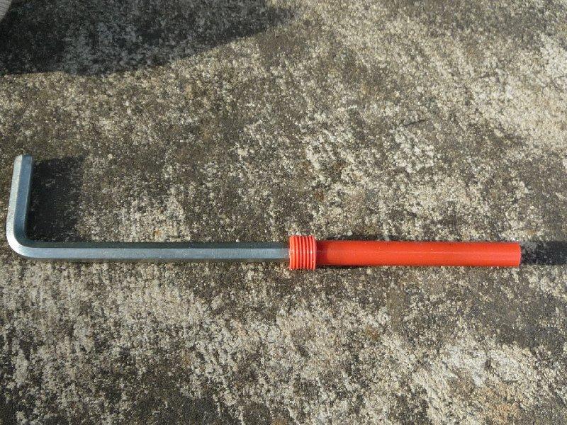

                      Thanks everyone for the info. I usually do all the servicing myself, Is the filter directly above the sump once you remove it? Do you recommend me doing this or giving it to an auto expert? When I was looking under the bonnet I noticed there is no dipstick so was concerned about ensuring the correct level once oil was changed
                        You need to buy or make adaptors to suit the oil bottle and inspection hole in the bottom of the pan.
                        The transmission is gravity-filled.
                        The filter is above the pan.
                        To drain, you remove the inspection plug, then the level tube which is in the same hole.
                        To re-fill, you reinstall the level tube, fill the transmission, run the engine to get the transmission oil up to temperature, and let the excess oil drain out, before re-fitting the inspection plug.

                          I did the above before finding the level tube in the sump pan, so the easier drain is to remove the tube.It is only plastic so make sure your 5mm key is fully seated
