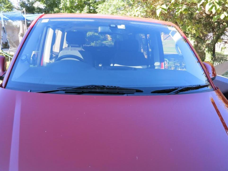

    The old:

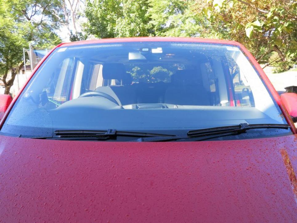

    and the new:

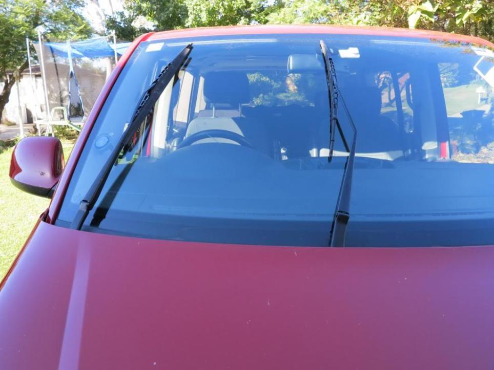

    Put your wiper in the up position:

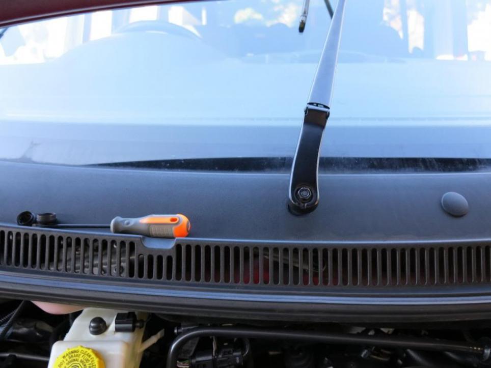

    Pop the caps over the bolts:
    Undo the bolts (13mm socket) and remove the wiper arms. As a safety tip, just like removing a steering wheel, it's worth leaving the nut on by thread or two while you loosen the arm since it can be on there pretty tight and will either come off hitting you in the face or hitting the bonnet and chipping that.

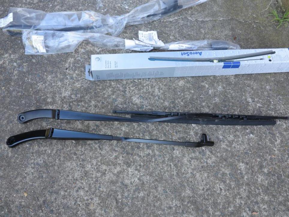

    Old vs New arms:
    The needed parts:
    7H6998002 - Wiper Blade Set
    7H6955409 - Aero Wiper Arm
    7H6955410 - Aero Wiper Arm (not sure which is left and which is right... but you need both )
    (It looks like you can buy the blades individuals too: 7H5955425 - Wiper Blade (each))

    At a shade over $200 from the dealers (even at the fleet rate) they weren't exactly cheap but you end up with a lower profile wiper which I think looks better than the stock unit or the aftermarket aero blade which fit the stock arms.
    Pretty happy with 15 minutes work
