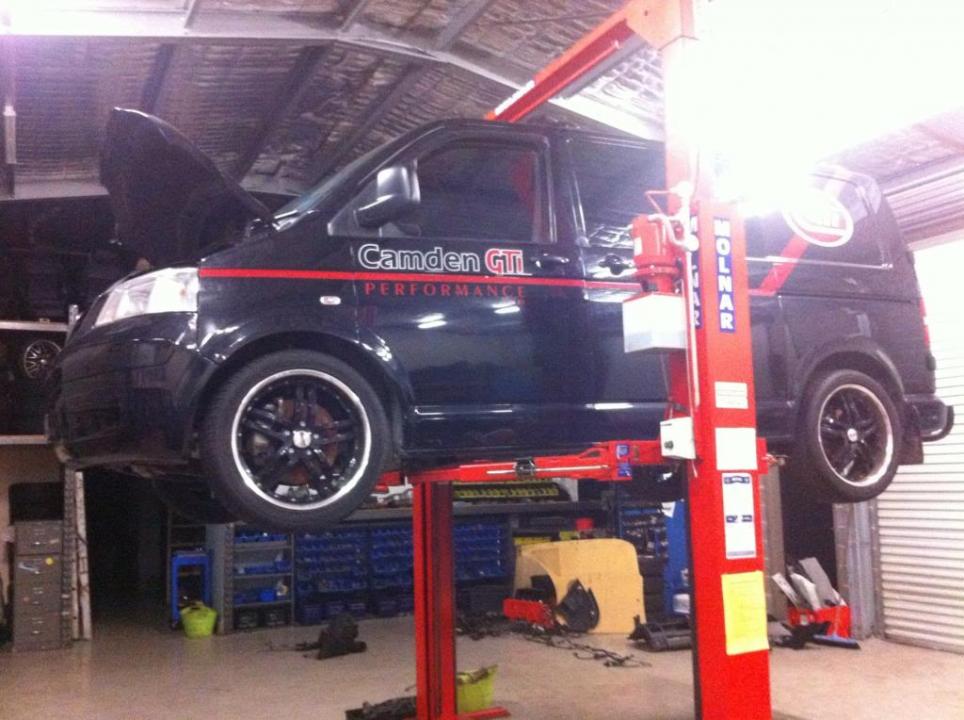

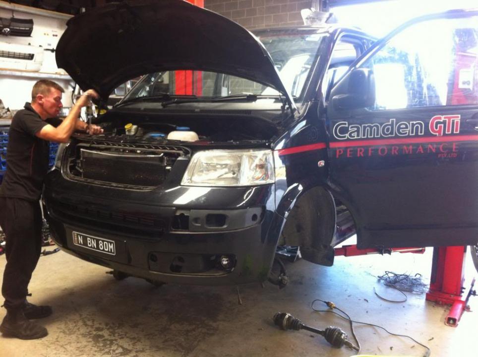

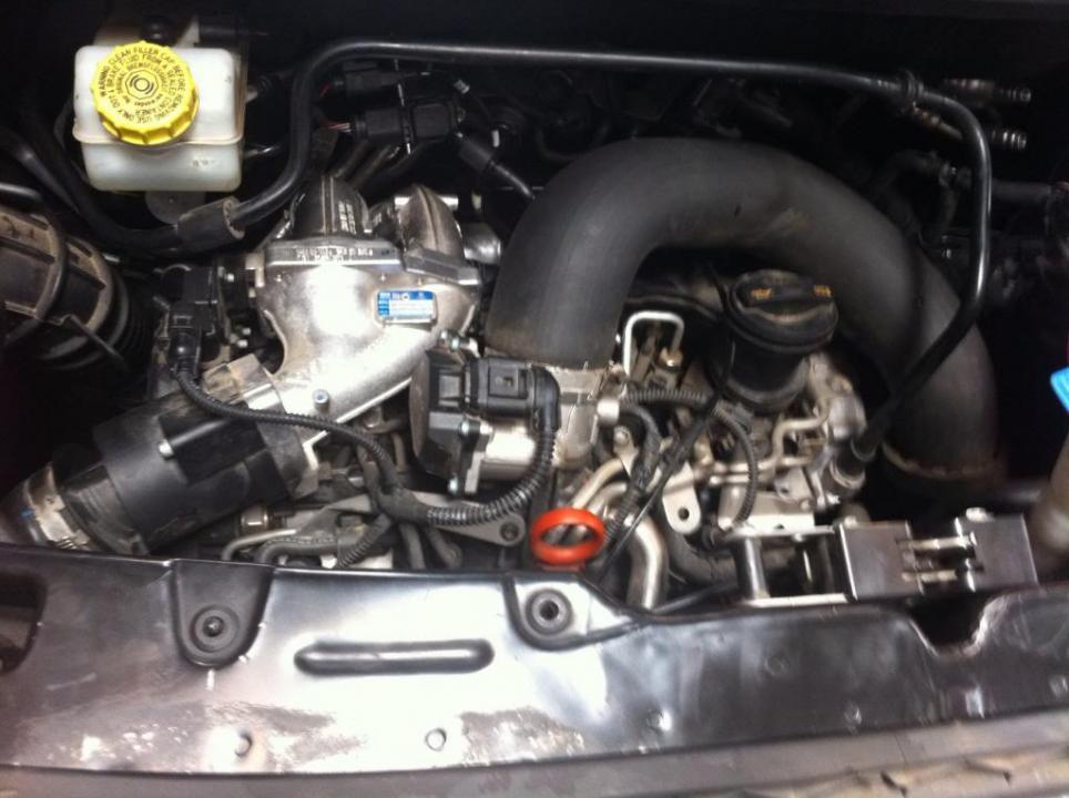

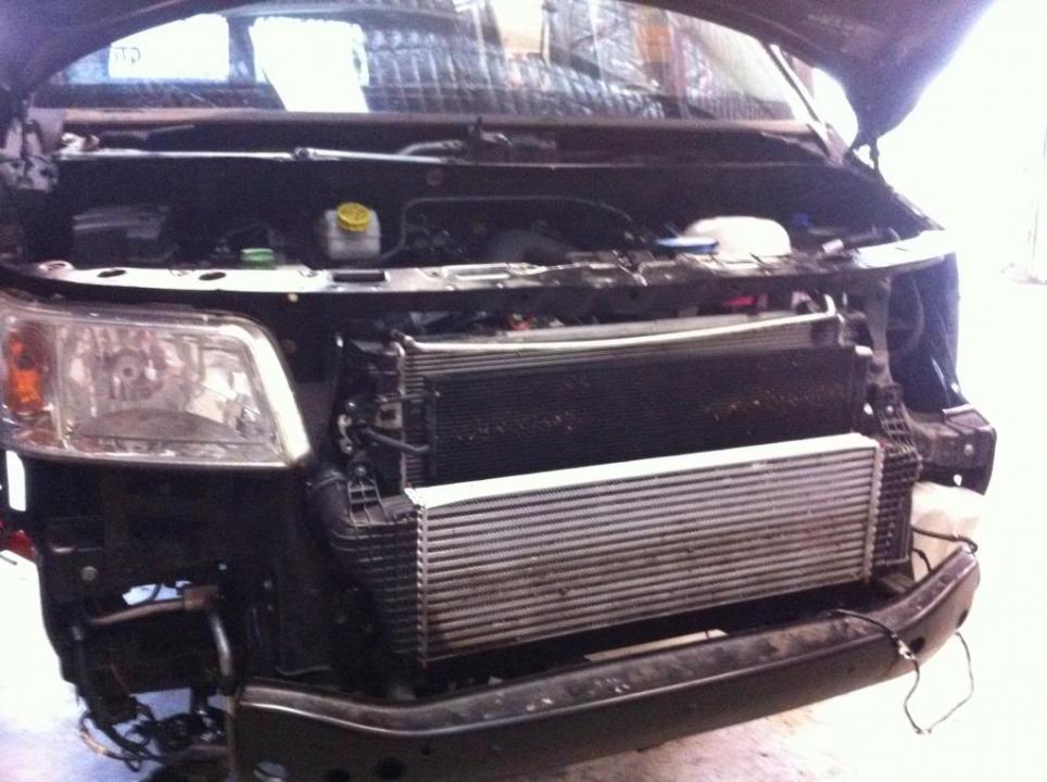

            Few progress pics
            front going on
            Engine looking snug
            URL=http://s158.photobucket.com/user/matwhi/media/image-23.jpg.html][/URL]
            Looking like a van again. Gary beavering away.
            some wiring progress. Rear lights, front lights and blinkers now working, with some judicious splicing.
            Kneebar and steering column in inside.
            Central locking works on both front and both sliding doors. Just the back to go!
            untold stuff to go back together. Will try to put hubs on tomorrow and bleed brakes so it can go on the floor and we can reclaim the hoist.

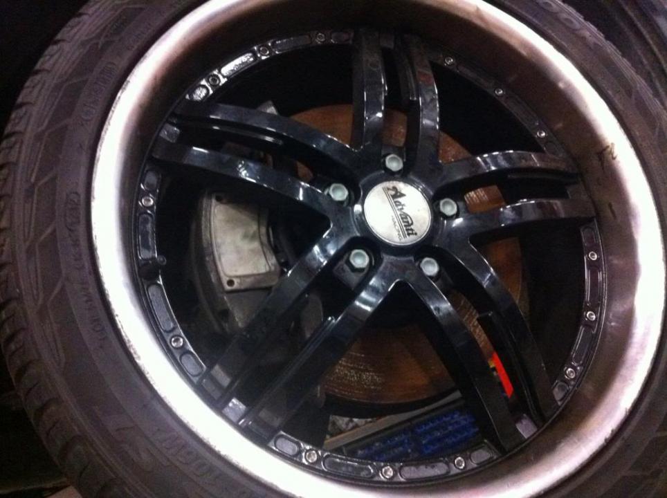

                    Big manly brakes and hubs. These are 20 inch wheels if that gives some perspective!

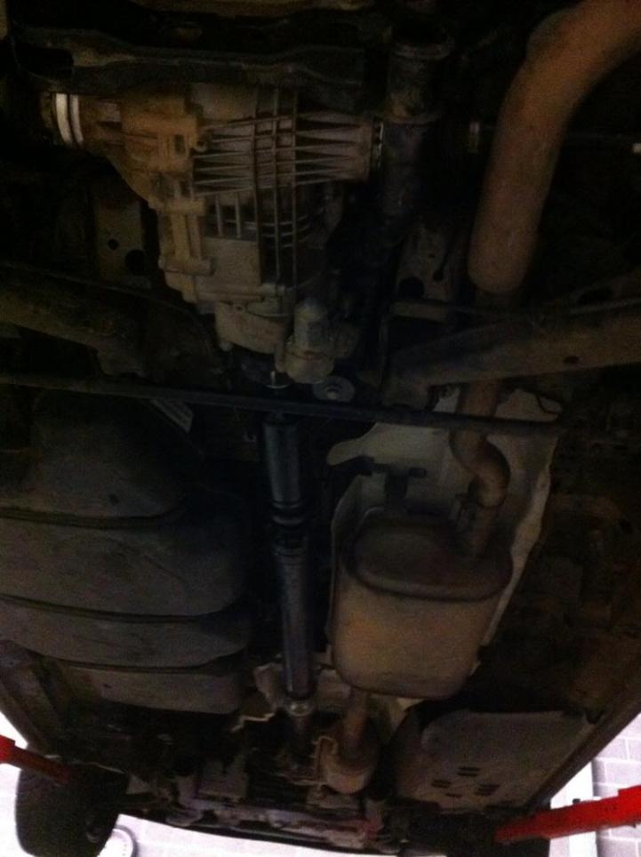

                    mounted up propshaft with hangers and shortened piece. Exhaust and heat shield looking the part. Part van part ute part custom.
