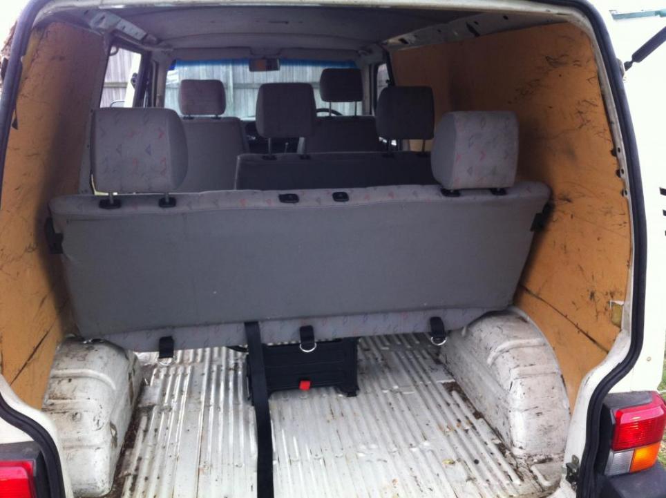

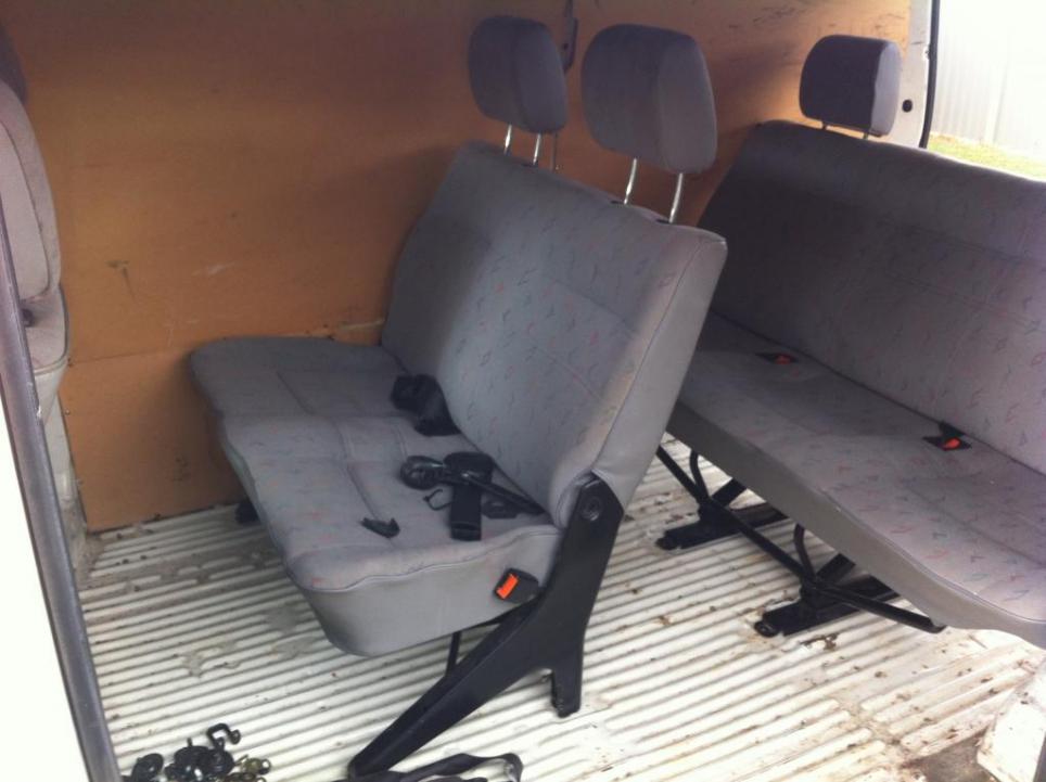

    I recently bought some seats out of a caravelle off ebay. I am on the Gold Coast and the seats were in Sydney so I couldn't check the compatibility but they were super cheap and I bought them straight away. I got the 2 and 3 seater, the single seater had been sold before I got to them. I got everything for $150.

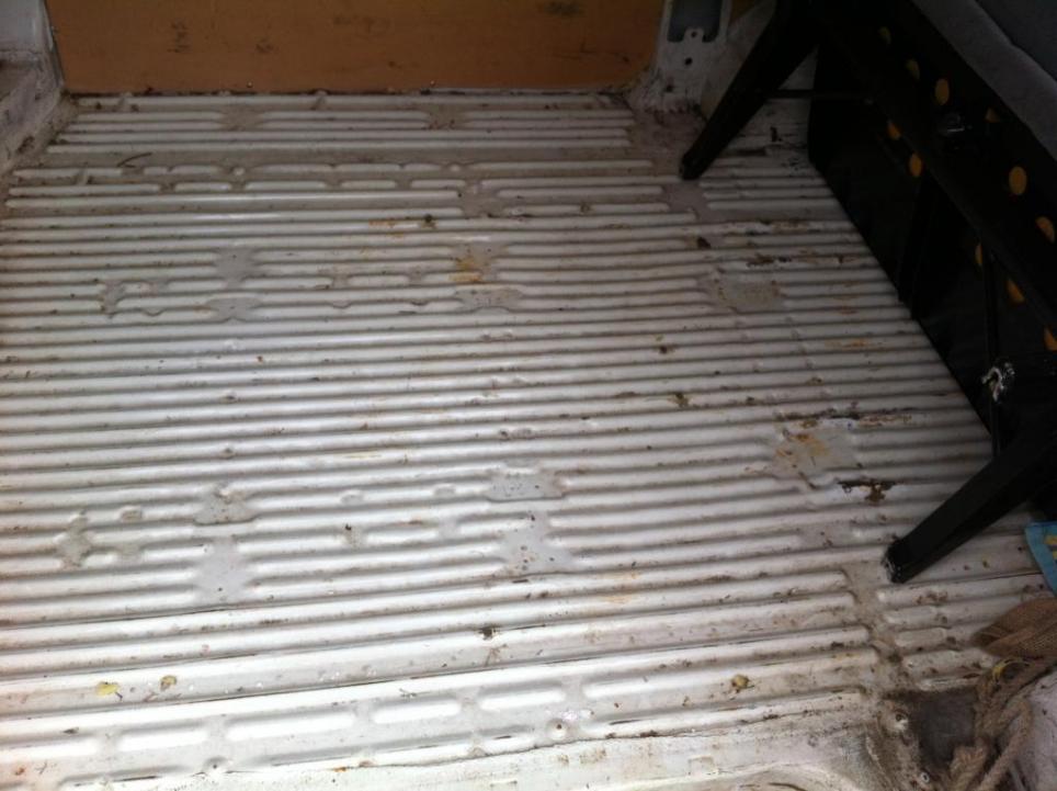

    I have since realised that my van doesn't have the fixed mounting points that would have been in the van that these came out of. My preference is to have 3 seats across the middle and leave the rear of the van empty so we can have the pram/bikes etc in there.
    My problem is that the mounting points for the 3 seater dont line up with the support rails under the floor.
    I looked at my friends caravelle and saw that the fixings that the mounts screw into slot into these rails, a relatively simple thing for me to setup.
    If I am to install the 3 seater in the centre I will have to make up mounting reinforcements under the floor and also mount the brackets that the top of the seat to the pillars where they aren't suposed to go. After that I'm not even sure what the requirements are regarding compliance for NSW registration.
    What is my best move??
    Try to install the 3 seater in the centre position, or try and find a single seat so I can have 3 across the middle.
    Does anyone have a single caravelle seat they have for sale or would like to trade for my 3 seater?
    Any other thoughts on what my best options are would be great.
    Thanks.

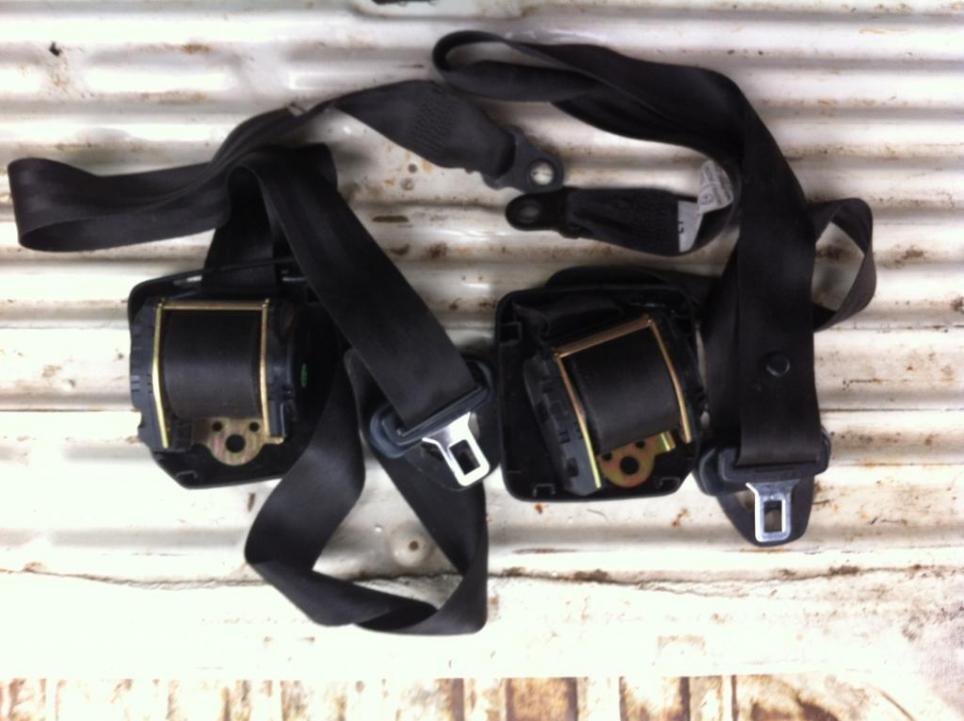

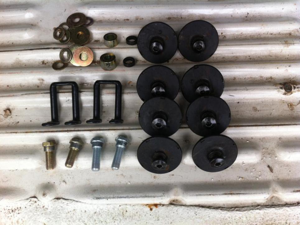

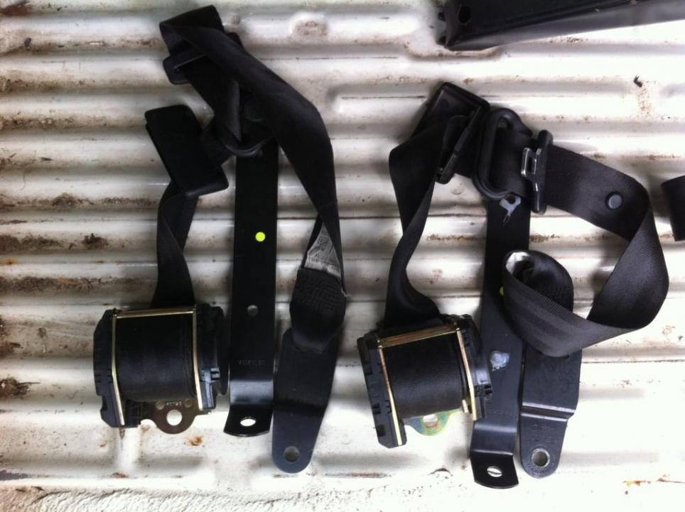

    Here are the pictures of all the stuff that I got with the purchase.
    (Im looking to convert what was my work van into our family vehicle so if you know of anyone selling interior stuff that will make this a bit nicer let me know. I already have a window for the drivers side)
    (Pics are linked to another post I did on the uk t4forum)
