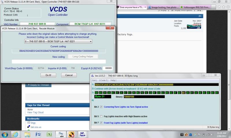

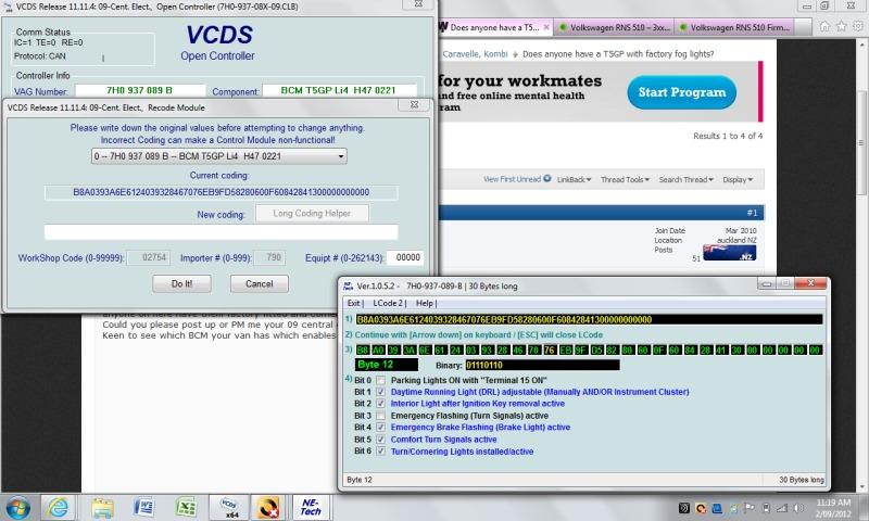

    I retro fitted front fogs and have them wired up / enabled with VCDS but no go so far, does anyone on here have them factory fitted and cornering lights working?
    Could you please post up or PM me your 09 central electronics scan?
    Keen to see which BCM your van has which enables fog lights / cornering lights to work.

        I'll post it later today, need to do a fresh scan. Have a 2011 Multivan with factory fogs.
          Hope this helps ...
            Hope this helps ...
            It does thanks, interesting that you have a "light" BCM yet it still supports this function.
