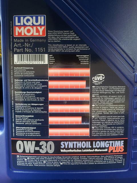

The Penrite actually recommends HPR5 now, NOT HPRDiesel5. Also keep in mind that only oil that has VW approval in Penrite range is Enviro+5W30.
Use anything else and you may regret it later. It takes long time to clog the rings with the deposit. You could use LIQUI MOLY 0W30 SYNTHOIL LONGTIME PLUS that is VW approved for T5 and I stock it as well as the Penrite oils.
Penrite aren't approved any more. They weren't bothered for two engines only!
