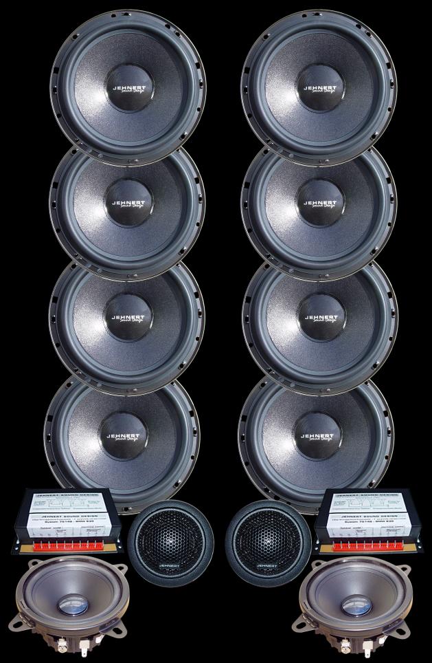

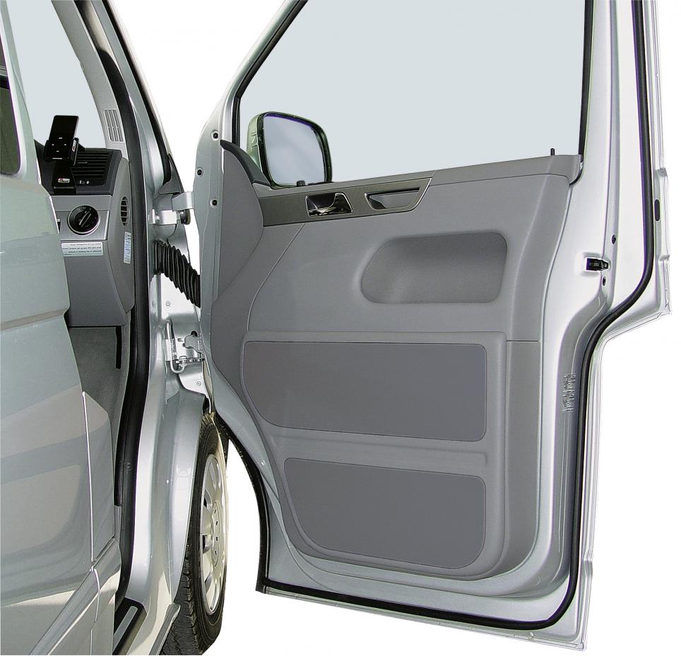

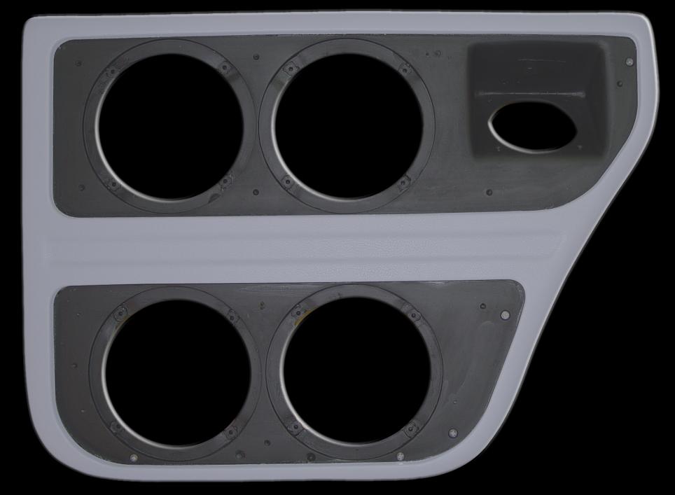

              Of course you could just go for...but I do like my door pockets
