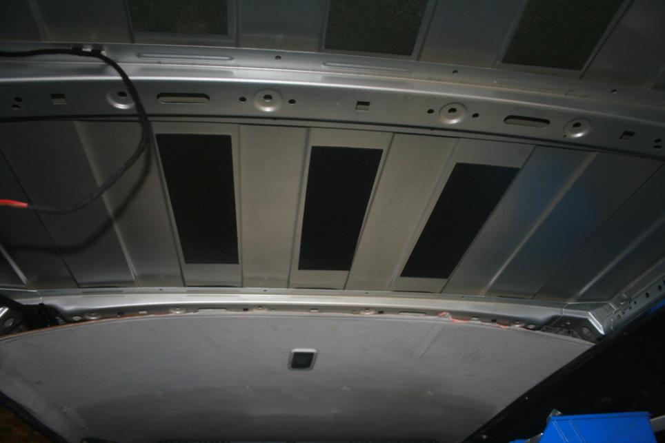

            I took a quick photo - a thousand words etc...
            This is looking from front to back. Where I would like the dvd screen is between the two sets of lights/vents. The problem with this is the approx 10cm gap between the roof and the lining there.
              ah i see, all the ones ive seen fitted have been just behind the front seats, so well in front of the rear lights.
                As I have fitted some roof mount DVD players I have not done one to your model as ours have been upgraded Transporters . If the roof trim is able to be removed I think you will find that there would need to be a bridging bracket fitted that would span the gap between the two braces , this would then allow you to mount the DVD player between the rows of lights /vents .Naturally you would have to see if there is any air ducting in the same area . Some installers I have seen only fit a metal plate behind the hood trim unfortunatly this is not always a stable mount and you will probably find the DVD player will bounce a bit on rough roads . As Buzuki has said may be the better option to fit it further forward to avoid the vent area . This is ashot of the internal showing just the second rear section but its the same right through to the front .
