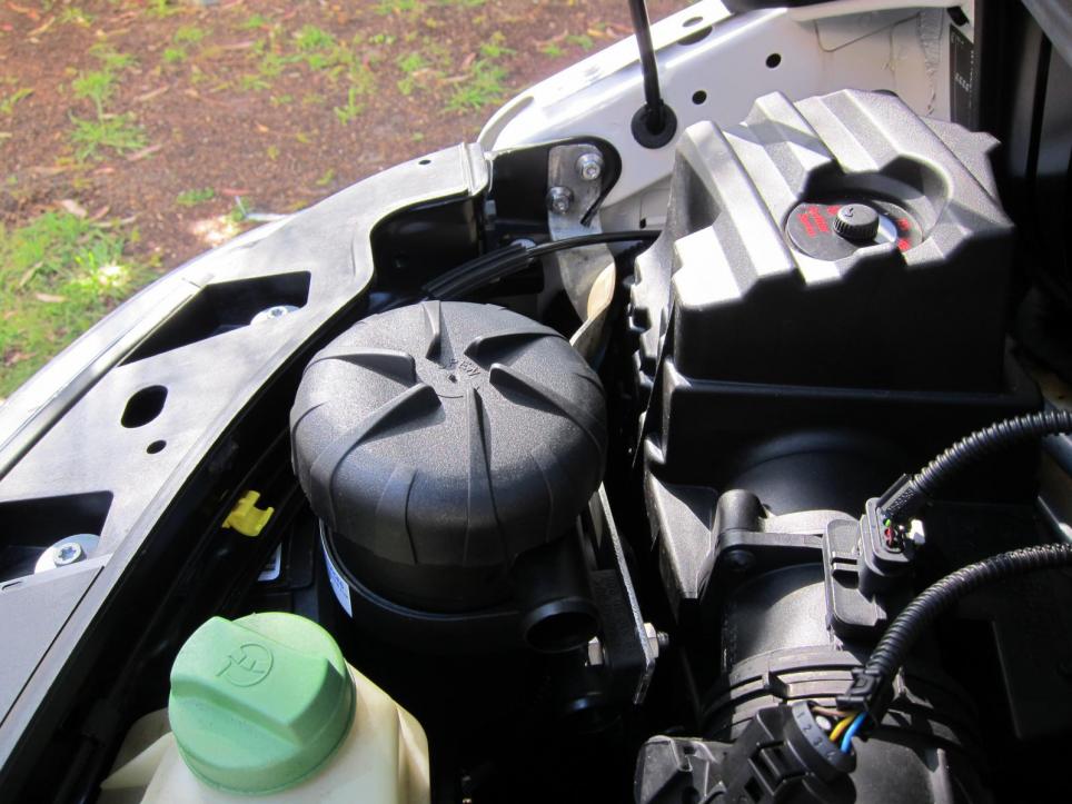

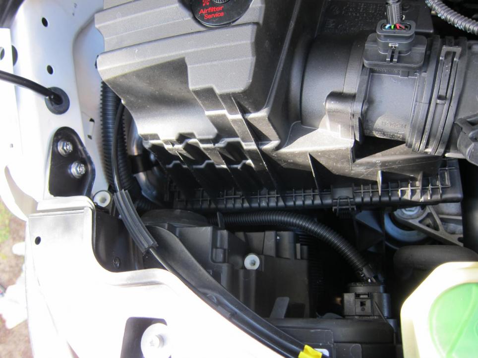

    Hi folks. Whilst I am going about the install I figured I might as well document it, particularly as I have mounted in a different spot to transporter, and my van has a slightly different engine cover. I haven't finished it yet, waiting for the bracket paint to dry and will finish the install tomorrow with the final few pics.

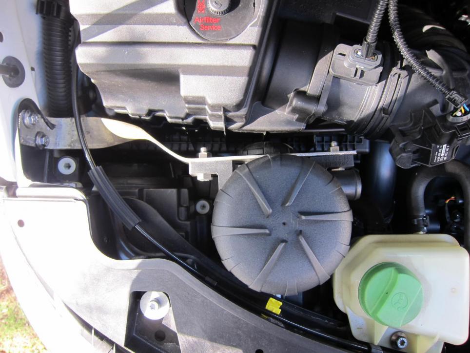

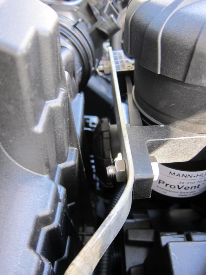

    This is the position I chose, between the headlight rubber cover and air filter box. Its a pretty tight squeeze with just a few mill each side. You can see the rubber needs to get squished inwards for it to fit. One reason I chose it is so that I have two bracket screws so it's hopefully fairly stable.

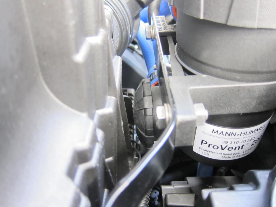

    Hers it is with bracket installed. I'm a little worried it may resonate forward and back, but i'll see how it goes with the hoses installed. There is a screw at the top of the firewall that looks like it would be a good point if i need to mount a small brace anyway.
    As you can see, only about 3mm between the pro-vent and aircleaner box. I'll probably stick some high density foam in between the two to make sure they don't wear on each other.

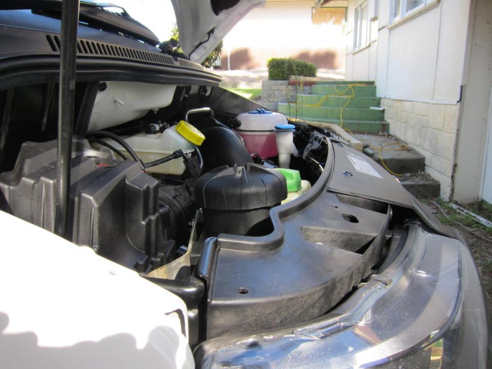

    Plenty of room under the hood.
    Its about level with the washer bottle, or whatever it is there. (Heh, still finding my way around this engine. I've never been so confused as to what is what with a car before )

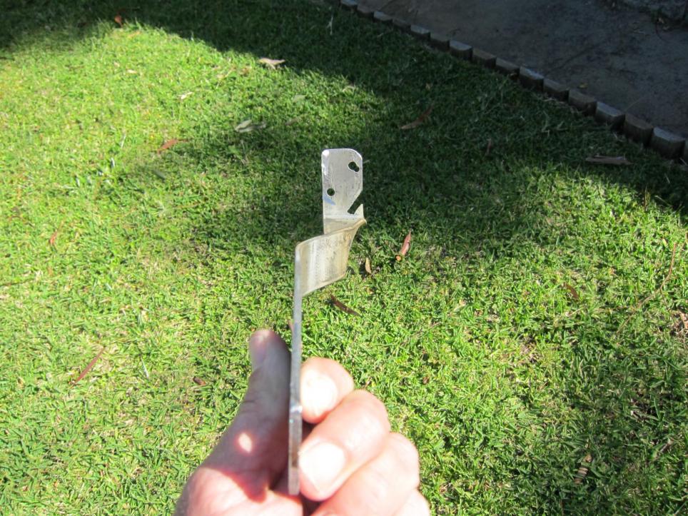

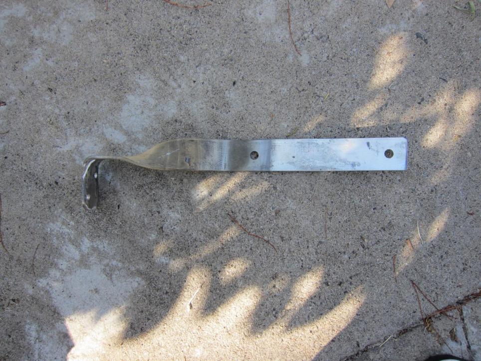

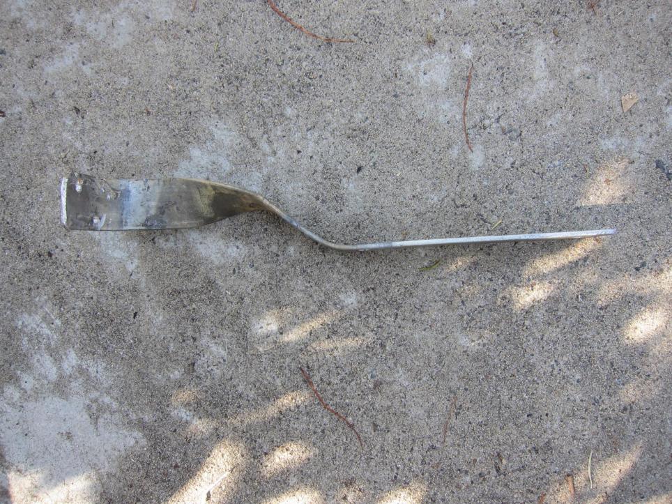

    The bracket is just 30x3mm galv strap. Some blacksmithing was required, and it can be a bit fiddly getting the bends and twists right and straight, but the only tools required where a vice, blowtorch and hammer plus a big shifter for the twists.
    Oh, plus an angle grinder to notch out the corner where there is a bit of a lip on the bit of metal around the screws.

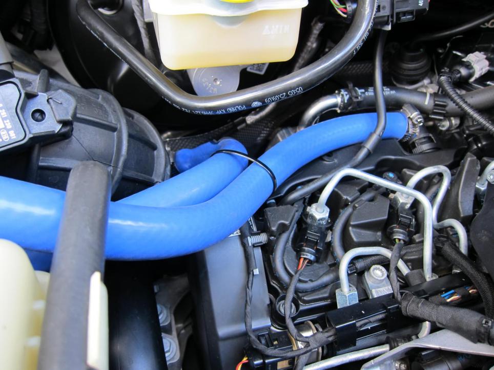

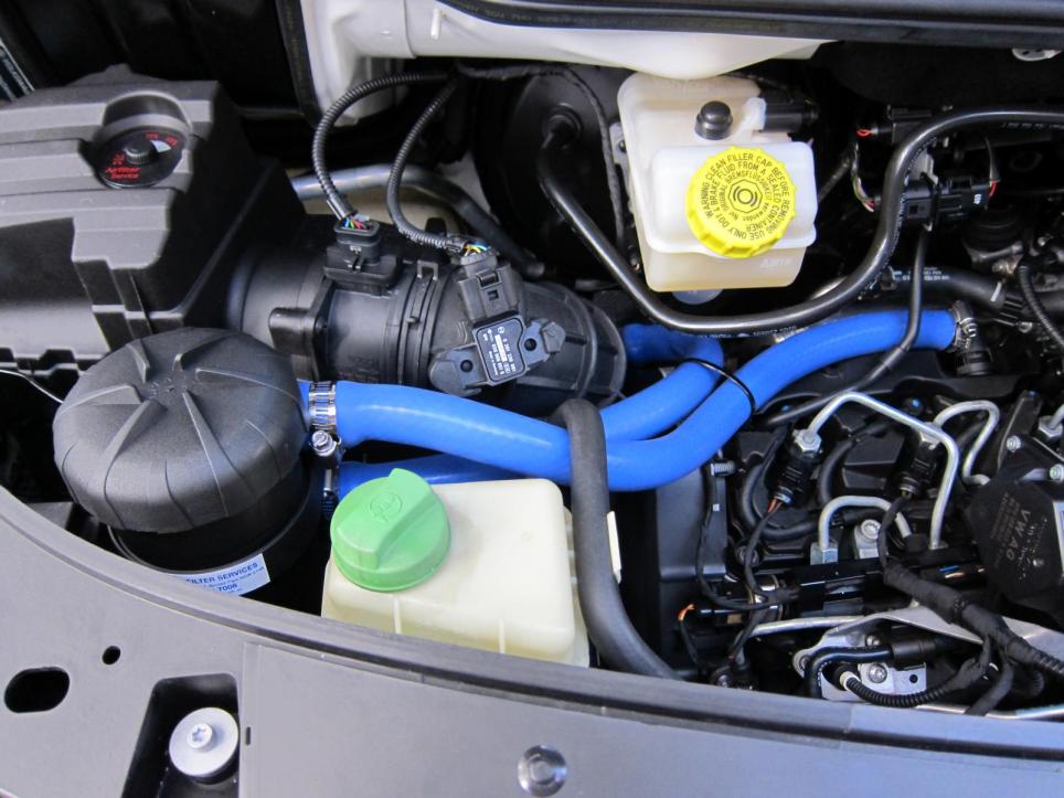

    OK, job complete! Happy enough with the brackets strength and provent clearance. Hoses all route pretty well, though getting the hose on the inlet side of the air intake was a bit of a job.
    Nothing rubbing to any extent. The power steering hose is touching, but there isn't any pressure on it. Will see how it goes if there is any rubbing, though I don't really expect it to be an issue.
    Happy with the clearance here, I don't think i'll bother with foam. With hoses installed and it all tightened up I managed to jag the bends just right! The front doesn't appear to resting up against the headlight rubber either, so, very happy.

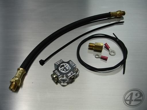

                              With one of these blocks into the stock pressure sender hole in the side of the oil filter housing. Allows you to run the stock pressure sender, an aftermarket pressure gauge ( or a blanking plug ), and a return for the Provent with the Provent one way valve.
                              Seems to be working a treat, and I don't miss the mess! I wouldn't suggest this for a car where you leave the oil 15k between servicing though, I'm timid enough leaving the condensed oil in the system for 7k or so when I swap the oil and filter between services.
