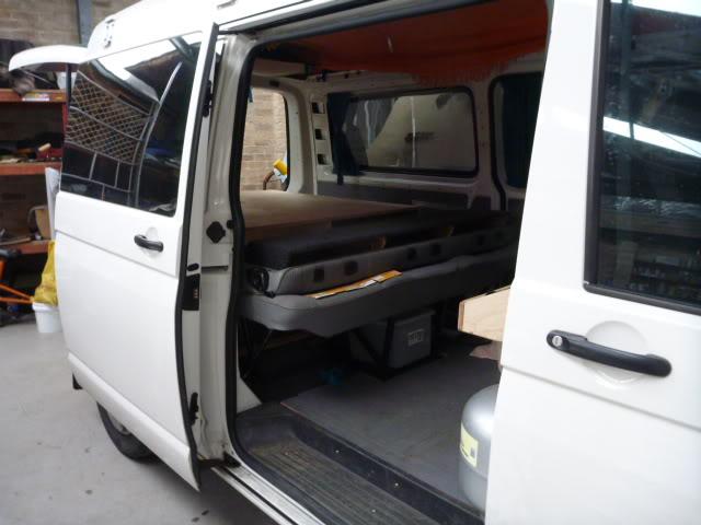

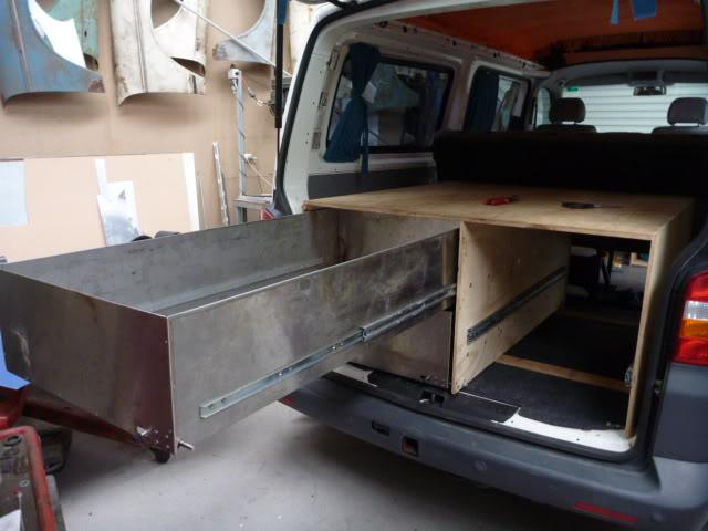

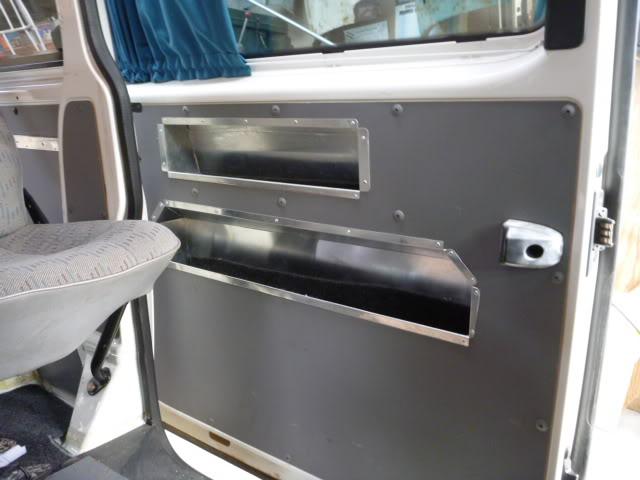

    sliding door storage

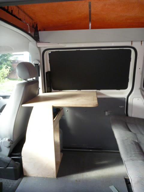

    storage and table behind drivers seat

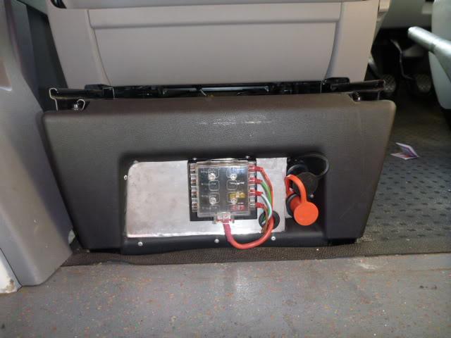

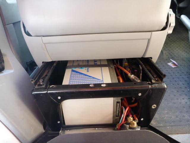

      120ah aux battery under passanger seat with 12v fuse bank and charging posts

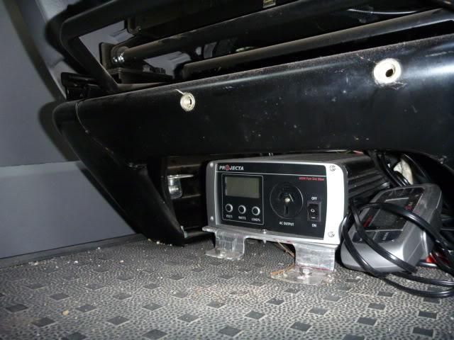

        Inverter under drivers seat

            Storage drawes, there is another one in the hole next to it for the fridge and BBQ
            T4 rear seat modified to suit my needs, more storage built onto the back fold down section. We are using a thin latex matress that folds in half easy so we can relax inside if the weather is no good.

                  Can the gas bottle be where it is? Thought it had to be in a sealed compartment?
                  Is the inverter any good? Price and where from please?

                    Last year we went around the block in our kombi beach, I think you will have a very interesting experience out of your trip. One question, I see you have fitted a 120A/hr battery on its side under the seat, can you tell me which brand and model it is. I recently spec'd a Ritar 120A/hr AGM deep cycle and I think it would fit under the seat on its side, so I am curious what you have used.
                    Thanks
                    Brian

                      Gas bottle only travels there it sits outside when its being used. Projector pure siine wave 600w inverter was from Ebay so far no problems, around $400 not the cheapest but a long way from the most expensive.
                      The battery was again from Ebay picked it up from the guys shop just near cambelltown they are a no name battery that he imports himself, ticked all the boxes for what I wanted came with a warranty and was nearly half the price of the same style at battery world was the absolute maximum I could fit under the seat.

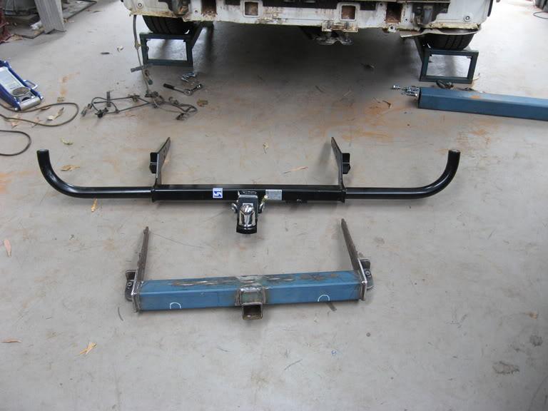

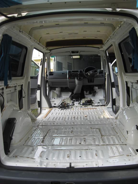

                        This is how I started striped everthing out

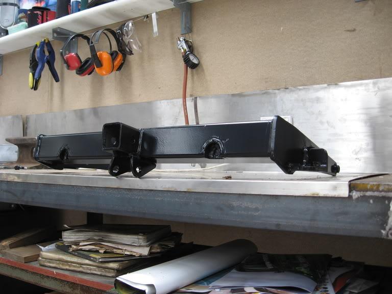

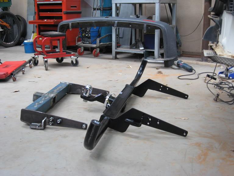

                          The tow bar that I made after fitting a heyman reece one and not liking it.

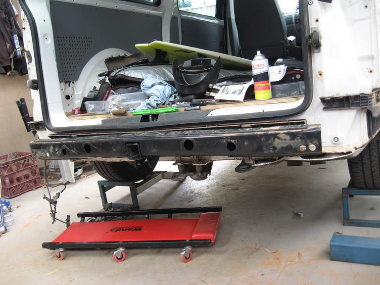

                          With the hitch removed there is only the square hole left in the bumper
                          Could even fit the standard inner bumper that the heyman reece instuctions told me to discard

                              Augie, I admire someone that's handy with a bit of fencing wire!
                              How do you lock the hitch in if it's concealed in the bumper?
                              And are you able to have it engineered certified and stamped?, just considering insurance in case of an accident whilst towing
