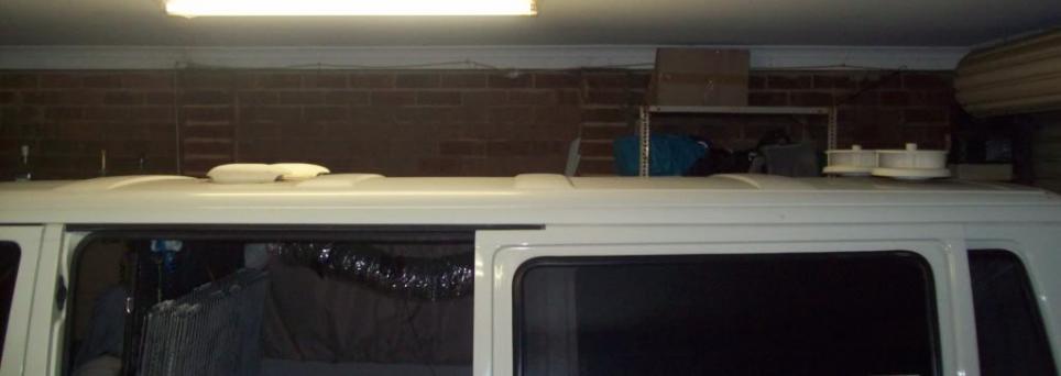

                          Here is a picture of the roof showing where the vents are located.
                          I can't see it properly on your photo.
                          The large opening of the Muller Vents should be facing the front.
                          The work on the ventury principle as mentioned before and operate when their is air movement over the vehicle.
                          The move air out of the vehicle.
                          I hope this helps.

                              Originally posted by GlowPlug View Post
                              Howdy!
                              I take my dogs for rides in the van often, the problem I have is venting it properly.
                              I have 2 muller vents at the front - apparently they let the air in.
                              At the back I have 2 whirly gigs - apparently they let the air out.
                              The guy at the caravan place said this is the way to go.
                              The problem is it doesn't seem to be working. When you open the very back of the van up you are met with warmer almost stale air, This can happen if the windows are up or down.
                              Is there a better way to do it?
                              Muller Vent at front of van
                              Whirly Gig at back of van
