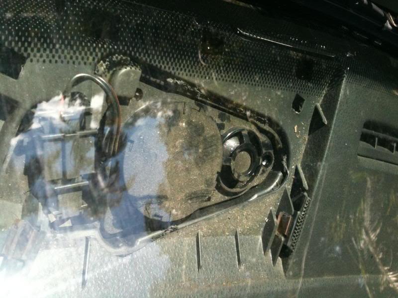

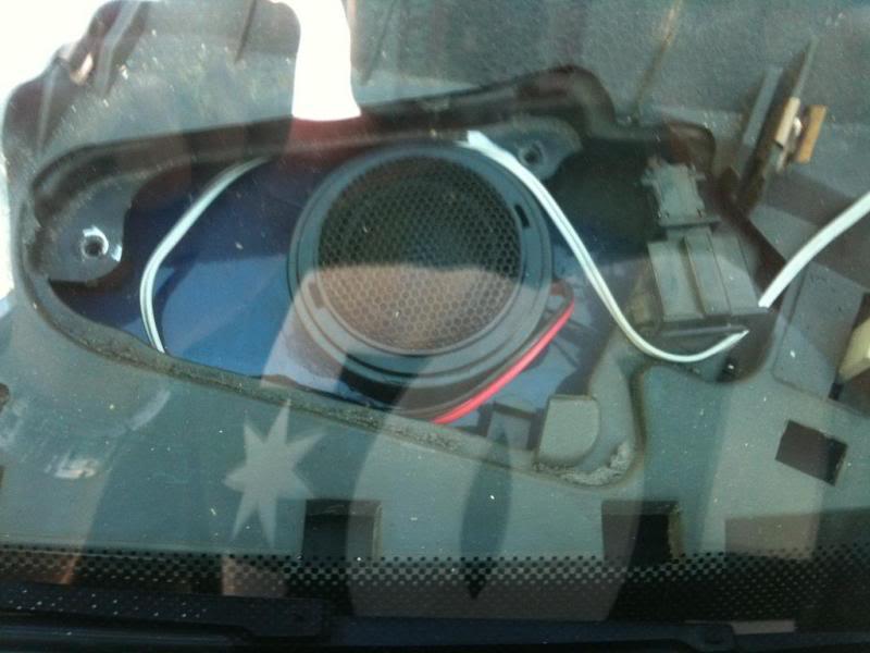

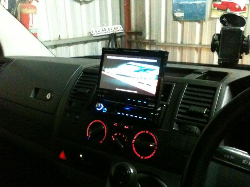

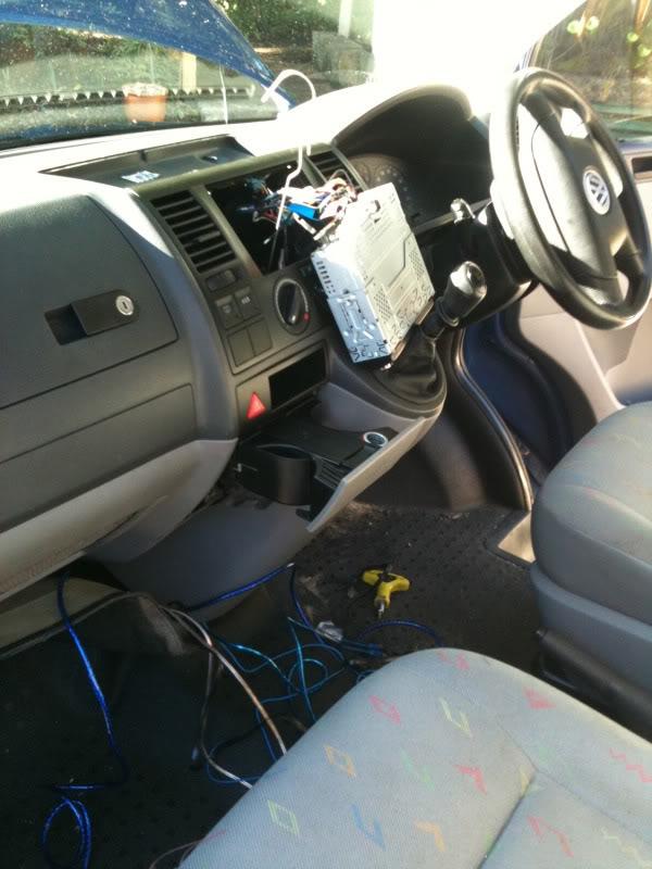

So far all my stereo has arrived from the US and i have started to install that. I'll try get as much photos along the way as i can.

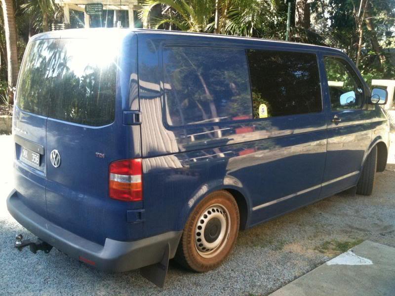

This is how it looked when it first arrived,

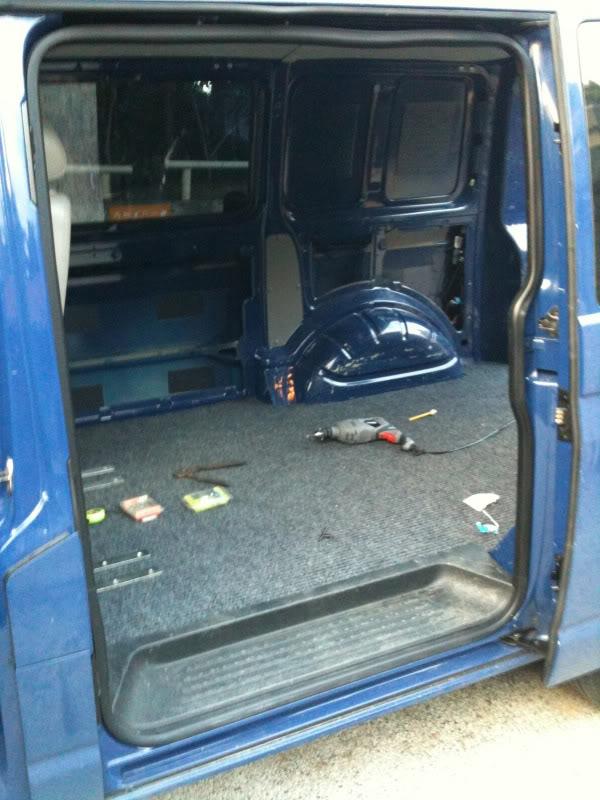

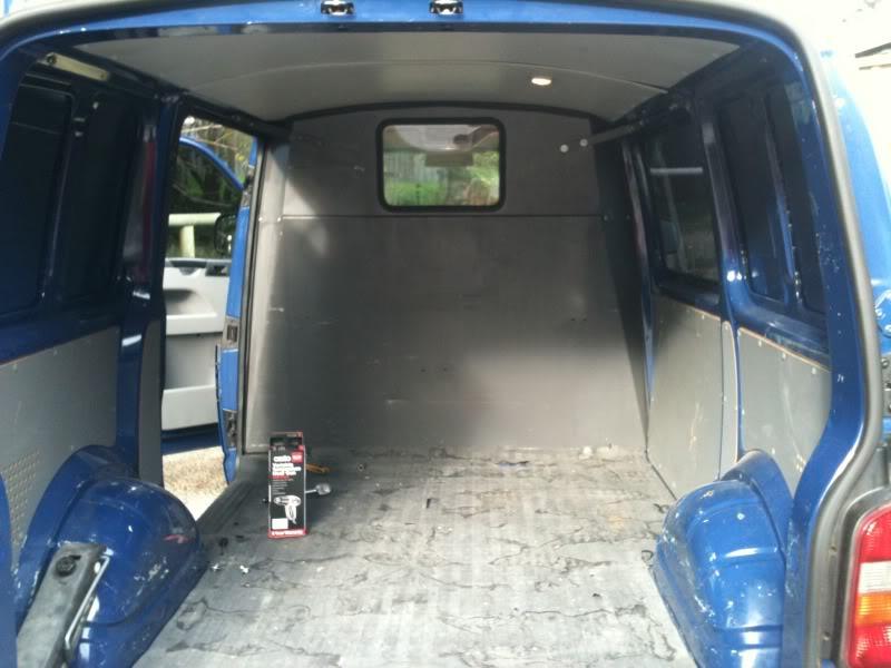

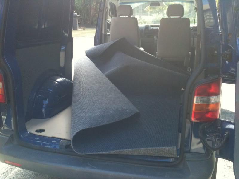

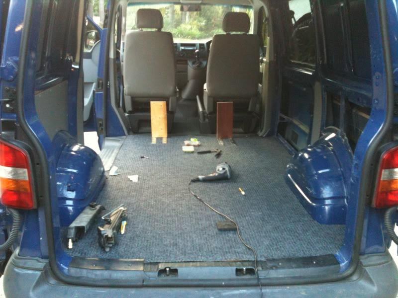

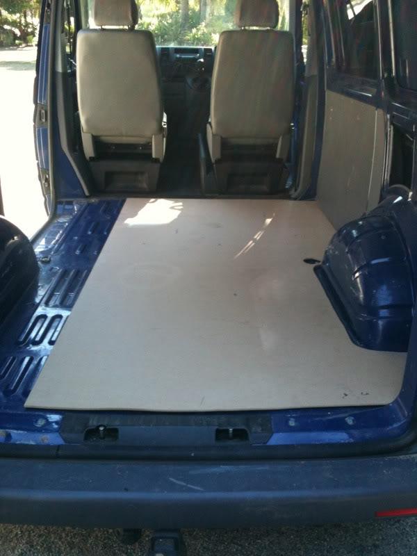

I stripped the back and put in a 12mm MDF false floor as i didn't want to carp[et over the corrugated metal floor, plus the MDF will help with sound proofing the cabin.

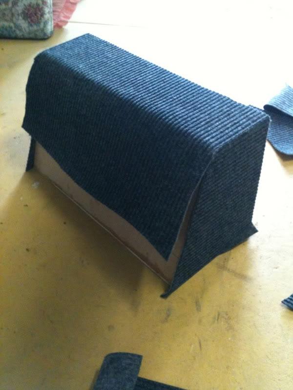

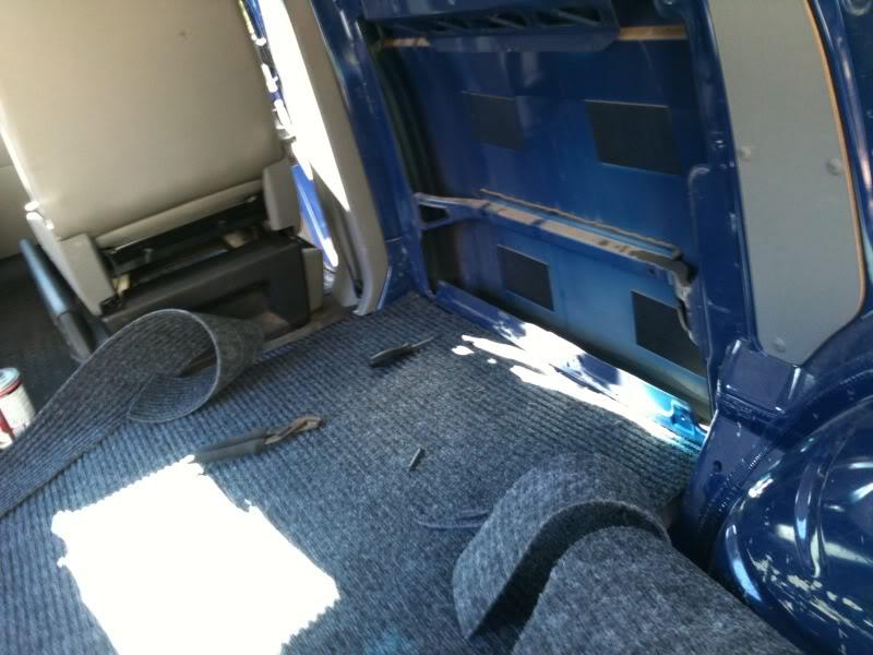

I chose marine carpet to put in as its hardy stuff and is easy to clean and doesn't show up dirt and sand easily so will suit carrying muddy motos back from races.

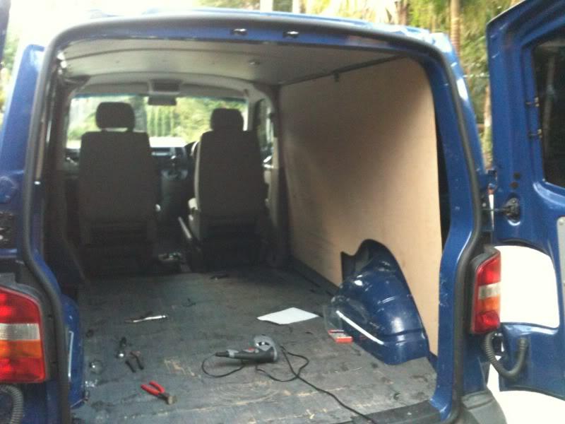

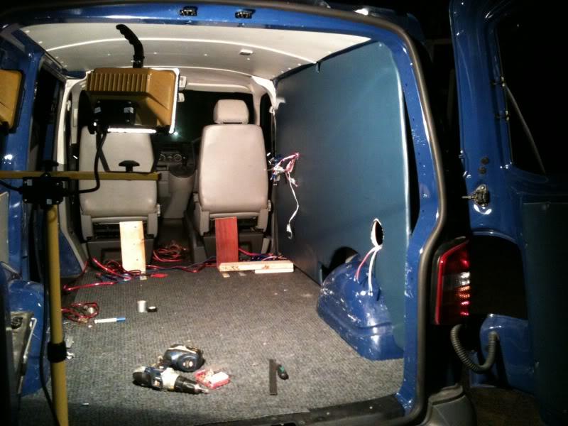

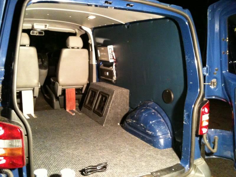

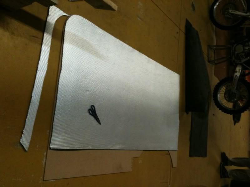

Next on the list was to trim and fit sound proofing to the wall panels.

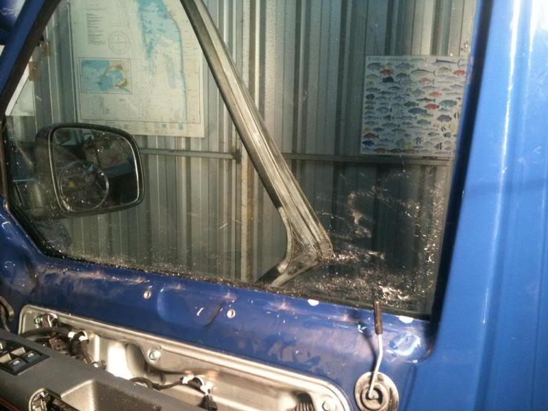

I re-cut 12mm MDF for most of these too as the standard trim is thin, and i want to board up the whole right hand side and block off the B pillar window on the right. (dont want to smash it by putting a handelbar through the window).
The window has 10% tint and inside of MDF is painted black so from the outside it looks like a black window.

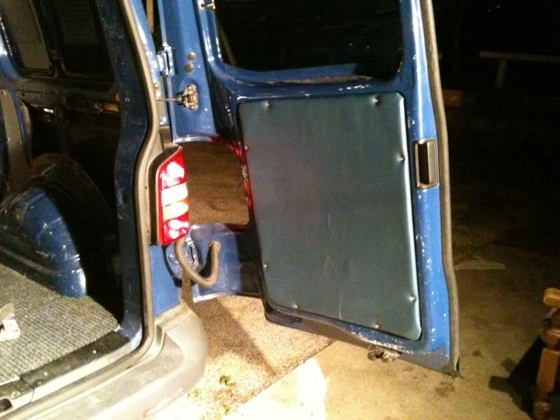

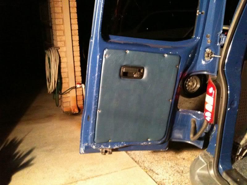

Rear doors re-trimmed

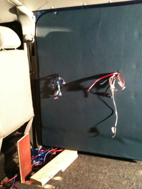

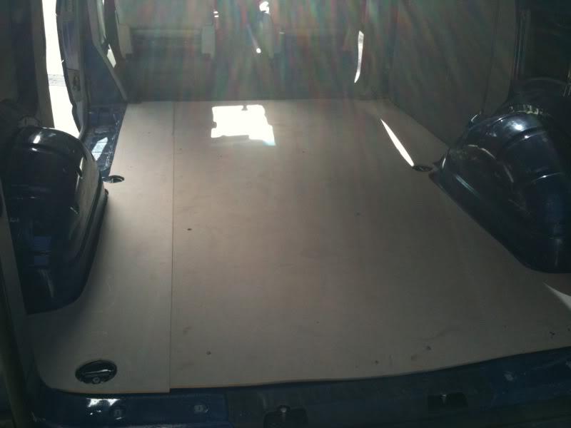

Sizing up the RHS wall before trimming
