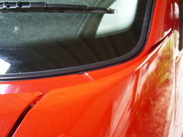

                  No, the windscreen has never been replaced (no chips either). The spot I am thinking is starting to rust is a join. It's very small at the moment (looks a bit like a split, about the size of a grain of rice) but I want to get it checked out before its too late. I'll try to take a photo tomorrow..just tried but its too dark
                  "One is too many, three's not enough" Harry's Reasons - V Spy V Spy

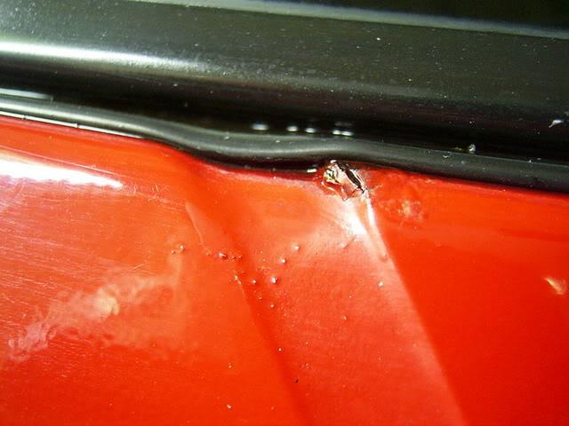

                    Now With Pictures!
                    The close up probably makes it look worse ....

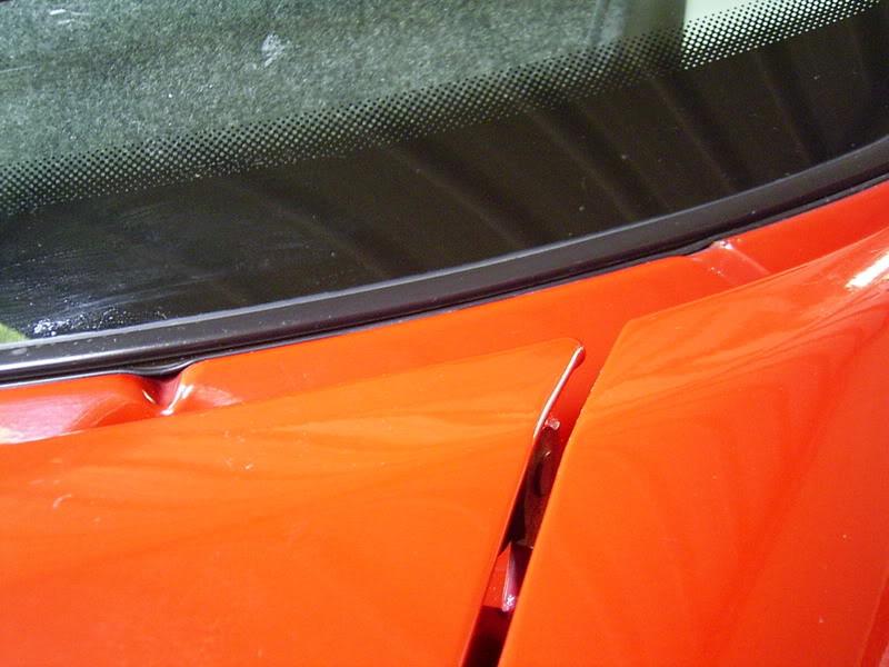

                    This should give you an idea of where I am talking about..

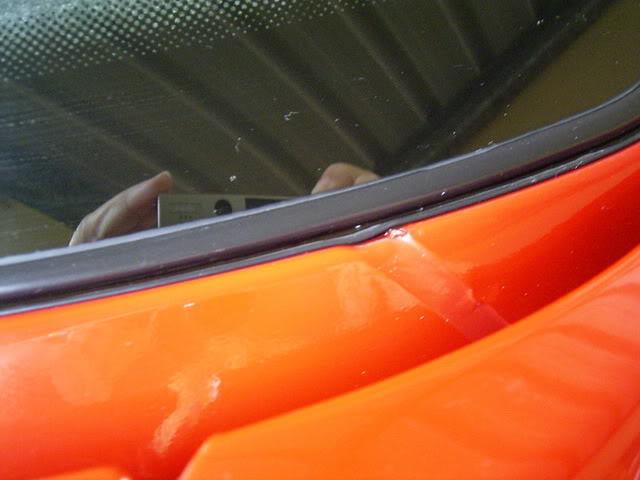

                    Another shot...
                      That rust looks like warranty to me.
                        The rust in my van is in exactly the same position[LHS ONLY] but yours looks more advanced than mine. If VW won't repair it then I would either repair it yourself or get it done. I understand the rubber trim is easily removed & at this stage probably with the right procedure an easy permanent repair. Don't whatever you do let it go. In the end it would be a windscreen out job & lots more money.

                            Those small indents are to help water escape from under the rubber/plastic trim. Late models had 3, one each end & one in the middle.
                            Dietrich the Green T4 only has the two (one each end), and so far has no rust. Two years ago we had to have the windscreen replaced, and I looked at the recess where the windscreen sat with great interest, luckily there was no rust.

                              Thanks for the reply Maris. My Kombi has 3 of those little "V" shapes across the front but this rust spot is on the right of the "V" in the photo below..
                              As you can see, its small for now...and when my hubby finds out he is NOT going to be happy...I've kept it secret from him so far... he has never really liked my Kombi...could have something to do with trading in the 85.. he has never gotten over it...it's always been "Too red" or "no soul". Every time I have had to take it back to get this fixed or that fixed he has said "should never have gotten rid of the 85 "
