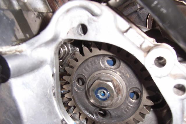

          It's easy to check if the w/pump is leaking. There is a small dia. black hose on the side of the engine block closer to the gearbox that can be seen when looking from below (side of the engine closer to the firewall). That hose will have pinky looking coolant deposits at the end or could still be leaking from it. It's still easier to remove the w/pump cover (only 3 bolts) and check for the movement at the w/pump gear, rather than removing the oil cooler. If the gear moves you know for sure that the w/pump is shot.
          That's the new pump fitted in my T5, showing the gear.

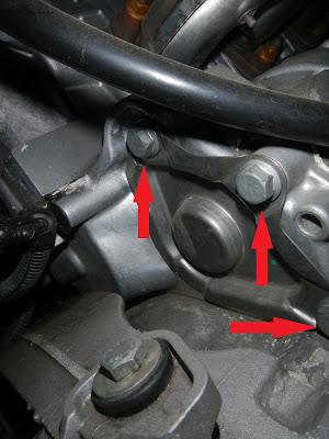

              I agree with you mate, when you pay for the new part, there is no deposit to be charged to you, as long as you're getting a brand new pump not reconditioned one. The pump can be replaced in 1-2 hours with the new coolant filled in and cooling system bled. However the time to clean the mess in the engine sump can take 1-2 hours, since the oil/coolant needs to be flushed from the engine lubricating system. So, it is indeed very expensive job. Replacing the w/pump at 50,000km, if it lasted, could save a lot of money. I will definitely check mine at 110,000km and replace it if in doubts.
              If you want to check the w/pump condition;
              Only go to the next step when you detect coolant loss and you had to top up the coolant in the coolant reservoir (the system is closed needs topping up only if the coolant is disappearing somewhere)
              Remove 3bolts (red arrows) and pry off the w/pump cover (it has rubber gasket, don't break it)
              Push on the side of the w/pump gear, to feel for any excessive play in the w/pump bearing
