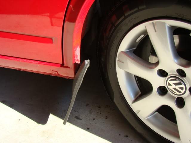

      My mudflaps have been scraping when I drive in and out of my driveway - it has that horrible scooped gutter all the way round the culdesaq - so I have been keeping an eye on them. The drivers side came unclipped today...

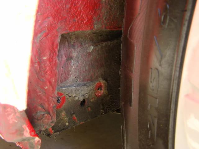

      So I have taken the two screw out that were left holding it on....
      My question is - Should I just leave these holes as they are or put the screws back in? The screws dont seem to want to go all the way back in.

        Leave the holes or put a blob of silicone if it worries you.
        I reckon you are better off without mudguards, everytime I take em off, you get a fist sized clump of mud and detrius that has been kept moist and against your inner guard. massive rust trap.
        Sure they keep your paint clean, but really its just moving the dirt to a worse place.
        Just my 2c worth.

          Thanks Matt - I agree about the mud - there is a big lump of it there. I will just dab some silicone on the holes after I have cleaned the muck away.

            Be careful with using silicone!!
            It contains salt and will rot the metal very quickly
            Friend used it to fill a couple of hole in the roof of his T4 and its worse now than before he filled the holes....
            (it was meant to be temporary)

              Holes in the roof? If they were rust-edged already no wonder they got worse, the silicon would have sealed in that Mancunian moisture.

                I might give it a squirt of fish oil first, then wipe over with silicone - I just dont want to encourage rust.
