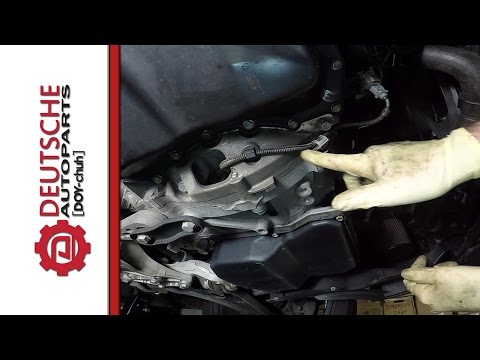

    Maybe this might be of some help?
      ^^ Wrong engine.
