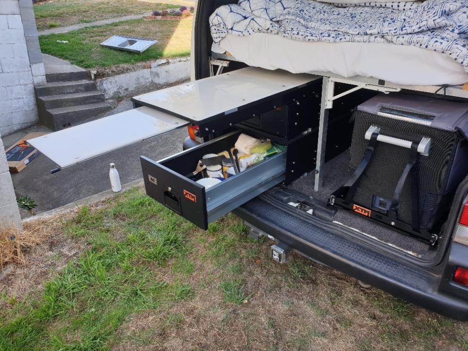

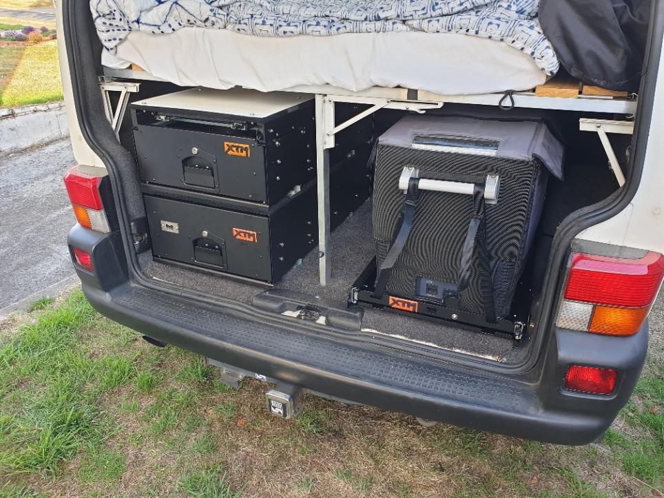

          Few new additions! We have been away a few times now since my last post and have gotten really sick of lifting the fridge out, the camp box and also getting the solar panel out when needed.
          First thing was splitting my fold out solar panel in two, with one half now permanently mounted on the roof, and the other still with a 5 metre long cable and can be moved around, just in case we are parked in the shade.
          Next was fridge slide, and some drawers. I used the sheet metal from the window to make a table top. The top drawer has a fridge slide on it that is now a table and also a little chopping board. The lower drawer is just normal. Works a charm now and makes storage so much easier, very happy with the outcome.

            Nice work, very clever re-purpose of the old sheet metal, colour matched too! Might have to look into those XTM slider bases, need a few in my build and not sure I can be arsed building them out of wood....
            • #36
              Cheers mate. Yes it caught my eye in the shed and thought it was a great re-purpose. I actually really rate the XTM stuff so far, I think they are great quality, both the fridge slide and drawers. For a bit more money, definitely a quick and simple process.

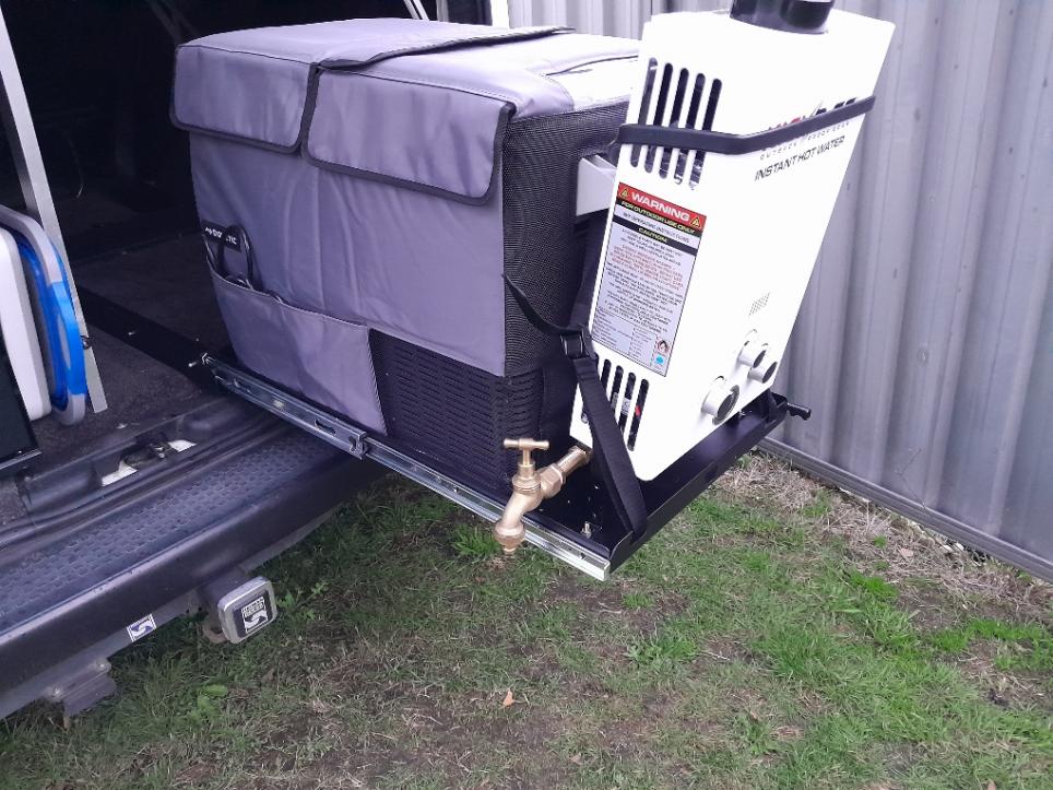

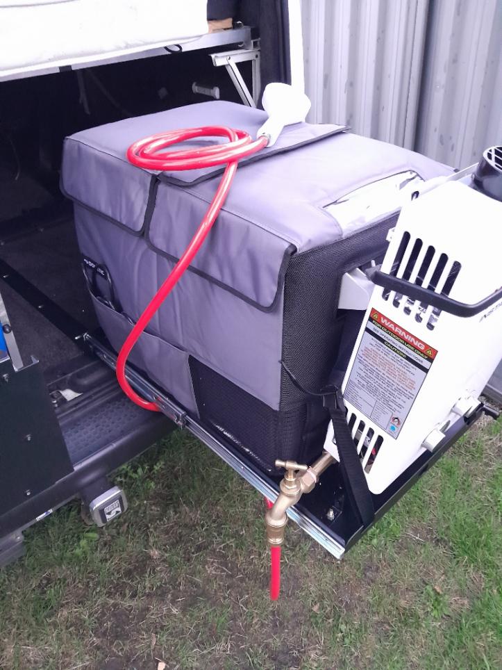

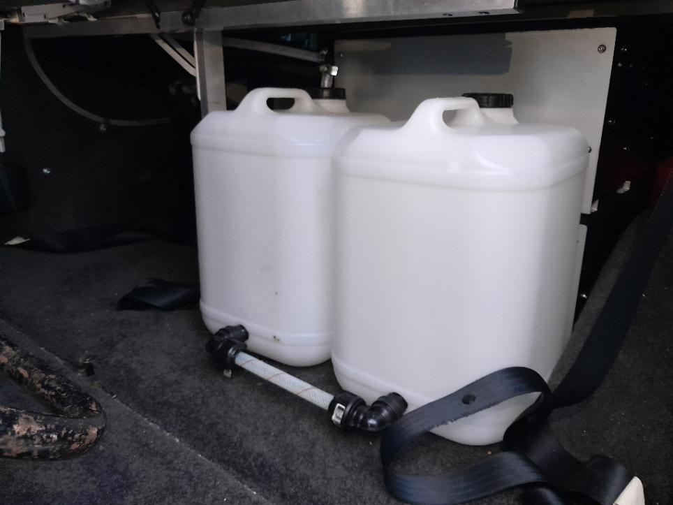

                      I've been fiddling around with my water system for the van and finally got it finished. I was gifted the KickAss hot water unit from a mate as he struggled to fit it anywhere in his Amarok, I also struggled! With a lot of thinking and ideas thrown around, I finally fixed it to in front of the fridge by strapping it to the handle and rivnutting and fixing some 'feet' to the bottom of it. Works a charm!
                      Starting from the water source, I bought two 25 litre cubes that I then plumbed together with a few random bits and bobs from Bunnings. These sit nicely in behind my backseat. This gives me 50 litres total which I'm certainly happy with. Buying water tanks to mount under body was just too tricky to get to work and cost too much for my liking.
                      One of the cubes has a filter attached to the inlet pipe and this feeds around to the water pump (6 litre/min) which I fixed onto the wheel arch. This then feeds to the hot water unit.
                      I modded a brass tap to fit to the hot water units outlet so I can leave the waterpump turned on and turn the tap on to get cold/hot water. This also means I can add a quick connection to my shower hose for easy attachment. Works a charm, very happy with how it worked out!

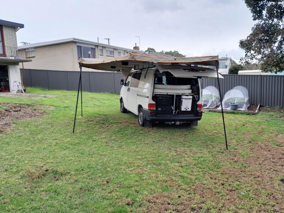

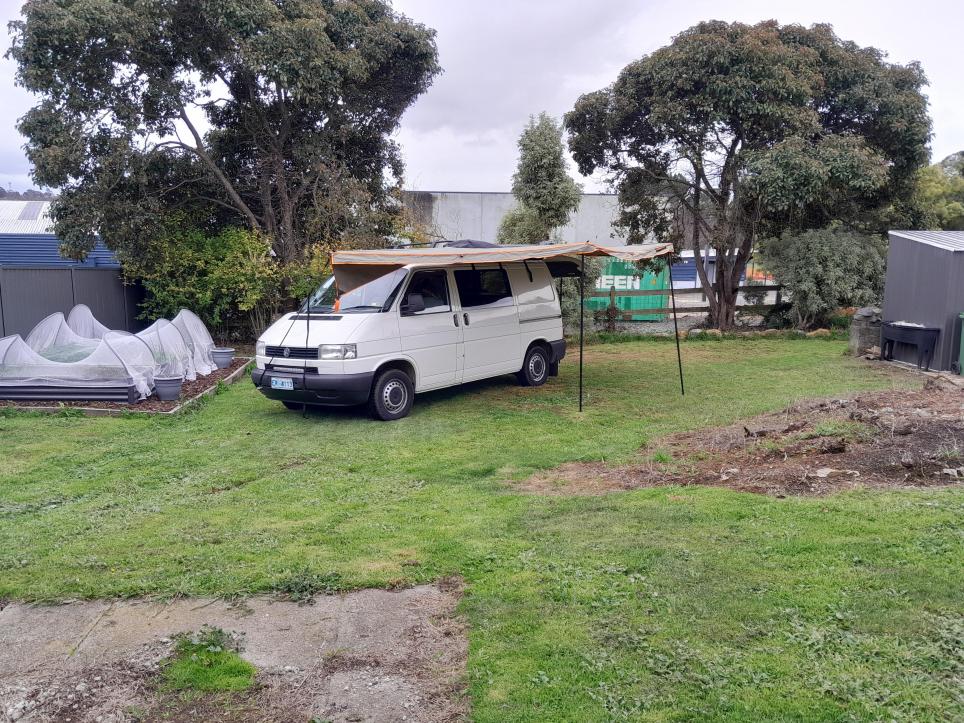

                        Installed a Darche Eclipse G2 270 awning today. Heard great feedback about them from some mates so pulled the trigger on one thanks to the recent tax return! I'll need to make some additional brackets for it as it sits a bit too low that the tailgate doesn't go high enough. Went for a trip away last weekend and it drizzled most of the time so looking forward to a bit of shelter next time!

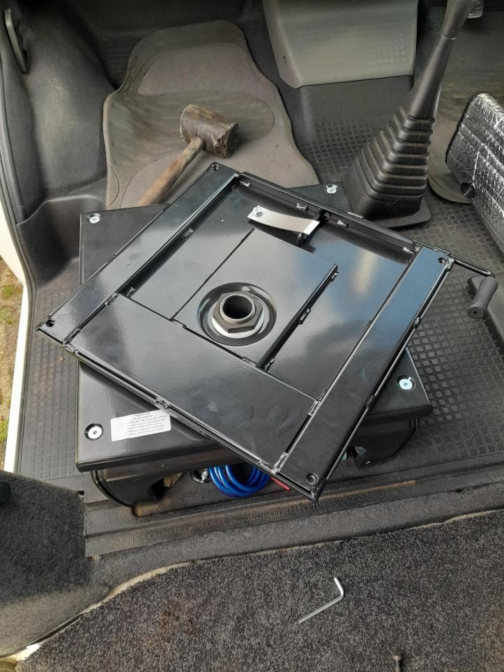

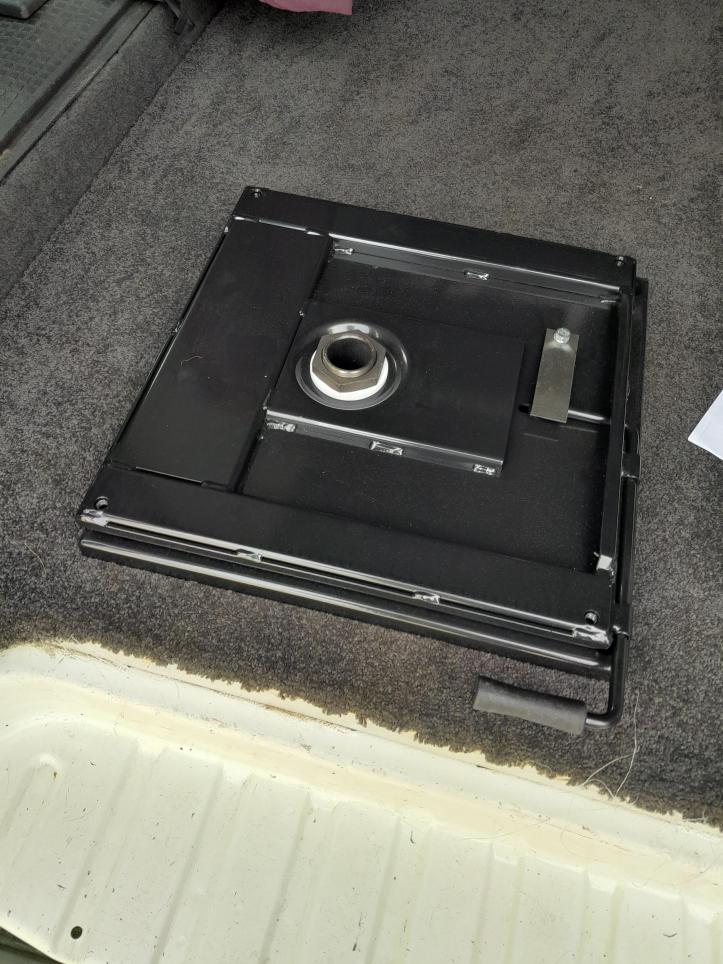

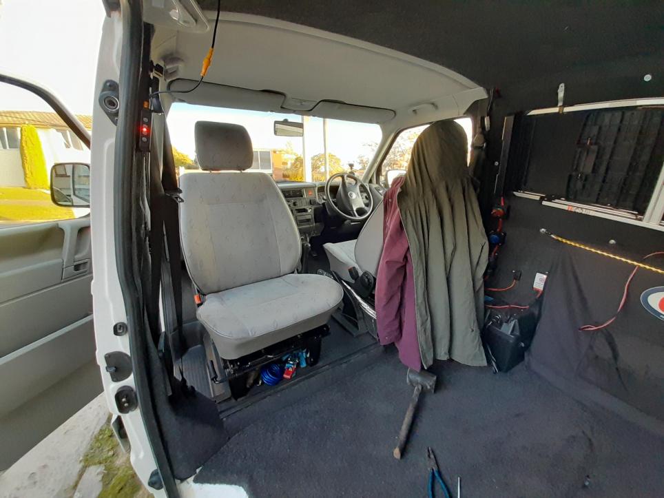

                                Swivel seat base installed to passenger seat, giving a bit more space to the inside now! I can see why they come with a big price tag, they are a solid piece of kit.
