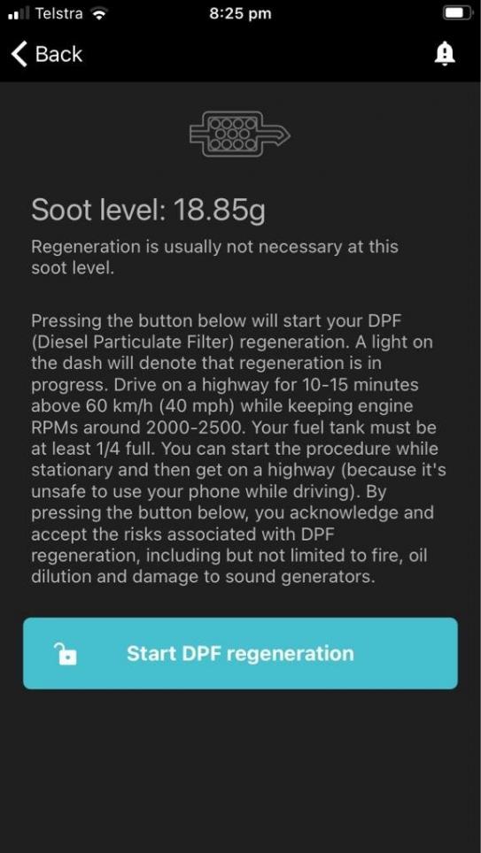

                Bugger - that's a shame. It does work on my 6 cylinder though. Strange that it wouldn't work on a 5 cylinder engine.
                Another option (although not as good as the VAGDPF app) is the Carista app + OBD dongle which you can see how full your DPF is. In my case I know that if the soot level is about 20-21 grams that its very close to needing to do a regen.
                Also, as the image below shows, you car manually trigger a regen if needed using the Carista app + OBD dongle.
