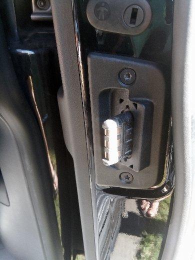

              I have cleaned the contacts on the close contact 3 copper fingers. Also cleaned and lubricated the rollers and drive wires.

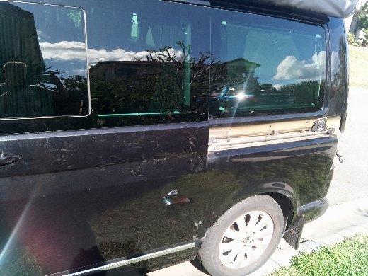

                  Had time to look at my faulty electric sliding door again today, left door will not open with outside handle or dash button, will unlock with inside handle but must be pushed open Armstrong method, once open it will close by all three means.
                  I noticed today that the outside handle does not tighten up halfway when pulling it open, noticed outside handle does not release back door lock, the inside handle does release lock.
                  I checked the other side and outside handle starts pulling firm halfway out and unlocks the door latch.
