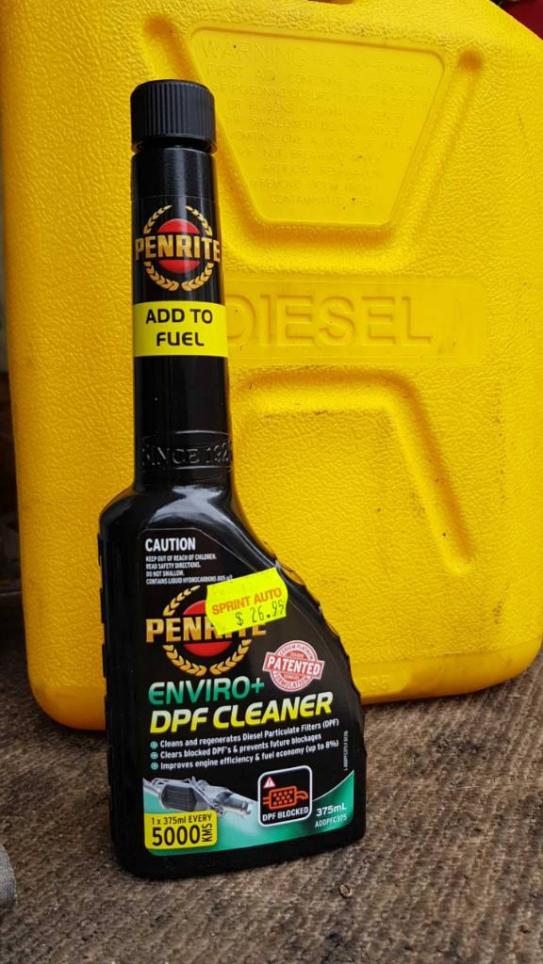

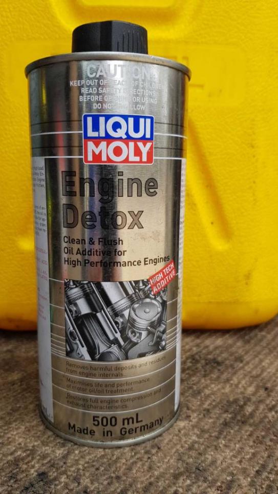

          I use LiquiMoly Engine Detox as an engine flush in the dirtiest engines, Penrite Engine Oil Flush is good too. Penrite makes an excellent DPF Cleaner, it’s a bit more expensive than equivalent LM product, but it’s very effective. Good to carry in the vehicle with you in emergency when you DPF light comes on, 1 bottle is for 30L of diesel, can be used every 5,000km as preventative maintenance.
            Does that mean that with my 80 litre tank, I should use the best part of three bottles?

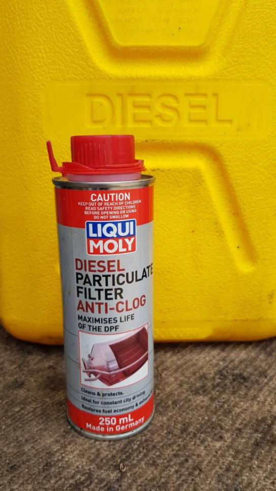

              It depends, you might have less than 1/2 tank when the DPF light comes on or if you use it as prevention just wait until you have less than 1/2 the tank. Alternatively you can use LM DPF Anti-clog it's good for 70L of diesel.

                    Thanks T, I’ll try Detox, I’ve never had a car with such smelly engine oil, do you have best practice recommendation for flush ! I service every 10000km but also burning 2L1000km. Are VW filters better then parts shops ?
