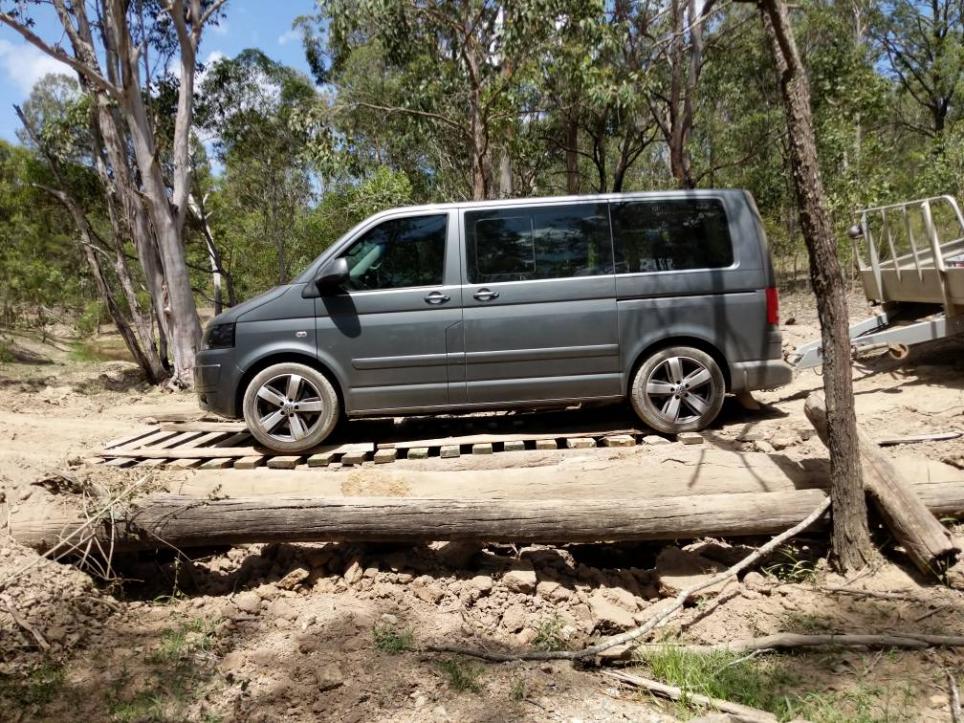

    These are the amarok 19s.. No scrubbing. 255 45 19 I think.
    Sent from my Pixel 2 using Tapatalk
      I run 255/55/18 no problem

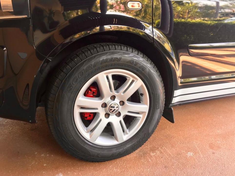

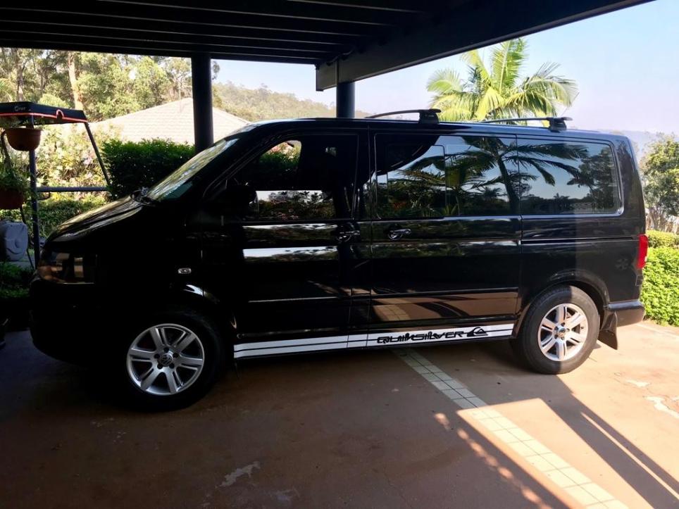

            Hi Guys got a set of 215 Amarok Alloys 6.5 x offset 51 PCD 120 ......................the original steelies wer 6.5 x 0ffset 52 PCD 120.
            The alloys fit nicely on the rear but the front brake calipers touch slightly and the fitters tell me that the slight touching would skim off some of the alloy and would weaken the wheels.......so it would appear the Amarok alloy rims are not suitable for a T5. SFP.

                Only partially correct. You need Amarok wheels larger than 16" (so 17" and up) to clear the callipers on the T5.1 400TDI and 350TSI Vans. 16" only fits the 340TDI
                Reason is the 340TDI has smaller brakes than the 400TDI and the 350TSI.
                Same applies to FWD v AWD on the earlier models. AWD had/has larger front brakes I believe.
