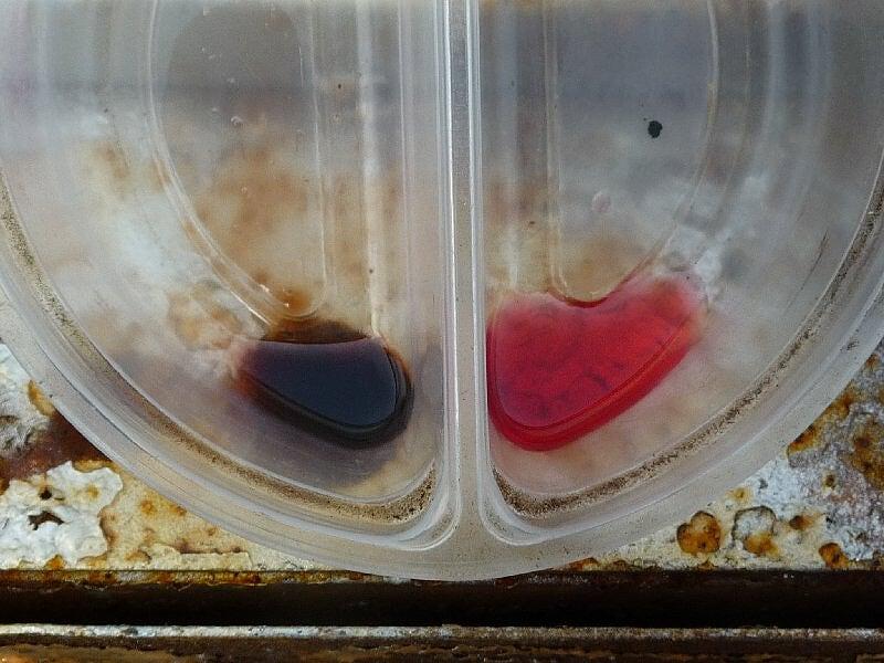

    oil level checked out ok, BUT...
    for 23K since last partial change, doesn't look real good to me.Old on left, new on right
    So, i've opened it up and doing fluid again.Decided on Penrite ATF FS for refill, after emailing Penrite, as DXVI isn't available anymore

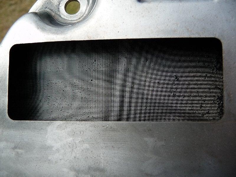

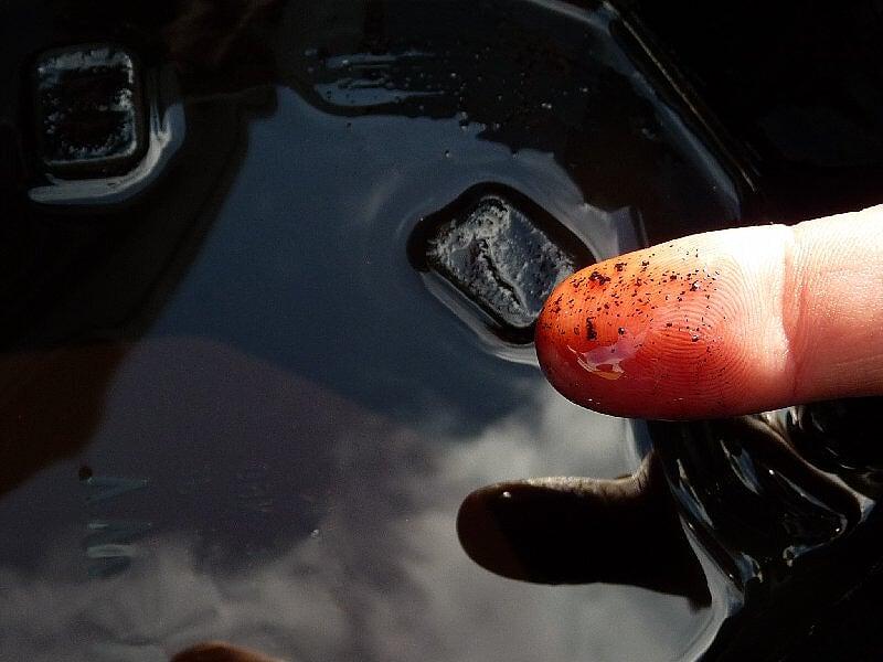

          Pan has a little more junk than i would like, filter is mostly clean.

            doesn't smell burnt, magnets have a little fuzz.More concerned with the junk in the pan, like little blackish specs, not solid or hard, maybe it's some of the fibre plates.Don't remember much like that from the previous changes.

                    Anyway, have finished my oil change.Still clunks at first into Drive, maybe not as bad. If i then go straight back to Park, then Drive, doesn't clunk.Almost as if it needs to build up pressure on the first selection or something
                    Gearchanges are definitely smoother.
                    This is the pieces i found in the sump.On closer inspection they feel like small rubber particles or something.
