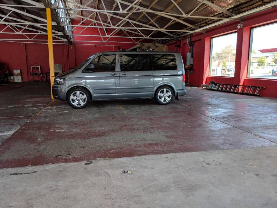

    I have a T5 with 18x8 wheels but would like to go bigger.
    Does anyone have 19" wheels or larger?
    If so, do yourwheels and subsequent tyres have the required load rating?
    Or do I not really need to worry about it?
    thanks for your help.
    I have amarok 19s with 102y rated tyres.
    Sent from my Pixel 2 using Tapatalk
