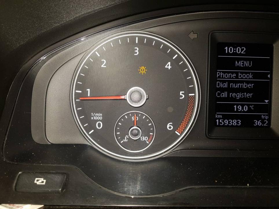

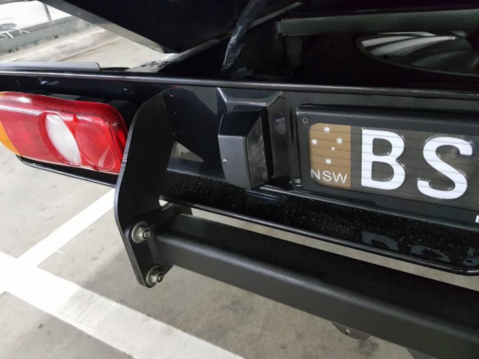

    I had a light com on the dash last week, telling me I had a blown bulb. After looking I found the Number plate lights out, I took the covers off and checked the bulbs, all good.
    What I found was the left housing had cracked slightly causing the positive bulb housing to break and become loose causing a short. I checked the fuses but could not find a blown fuse, I also ordered a new housing from VAG and have installed it, but still not lights as I expected.
    I took it to my auto electrician today to have a look, he said they were getting no power, and no fuses were blown, so he said I need to take it to VAG as they have the means to fix it, amd it could be a body control module .
    Every other light on my T5 works, any ideas on how I could fix this small issue cheaply?
