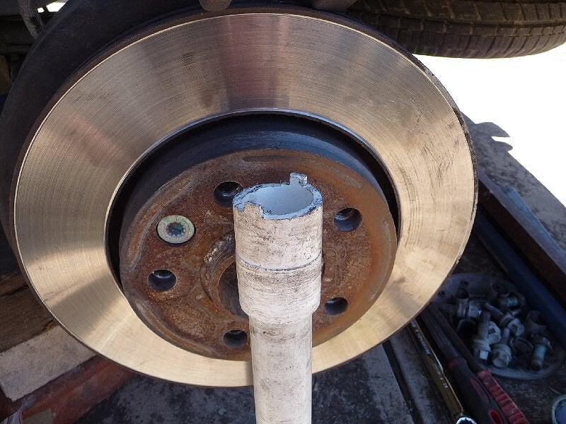

      I used this on mine
      IIRC, was reasonably tight to turn, took some effort and time
      I actually ended up taking the caliper off the van and put it in a vice, as it was too hard to apply inward pressure and turn it with it still on the van

        You really need one that pushes the piston in as it turns.

            I made a similar tool from an old socket has the two lugs after some grinding . What I then did was place the socket over the piston and then used a "G "clamp to put pressure on the socket while simultaneaously using a pair of vise grips on the socket to wind the piston back in , now not sure but I think form memory it winds back in in a different direction to what you expect like a reverse thread .
              I used one of these: Right Handed Brake Break Caliper Piston Rewind Tool Dual Pin Q5J4 | eBay
              I've since modified the lugs slightly, so that it works with calipers that have smaller diameter pistons, such as Golfs, etc.
