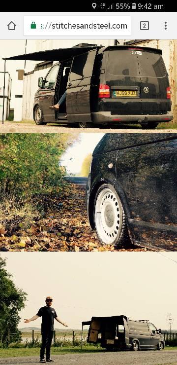

    Hi does anyone know of 18" steel wheels available in Australia for a Transporter?
    Found some in UK for about $850 without tyres.. Stitches and Steel – STITCHES + STEEL
    I like the stock look but the bigger wheels fill out the wheel arch better

            I think you'll find that these wheels are actually a spare from maybe a Range Rover/Land Rover and Stitches and Steel just buy 4 to make a set and add the appropriate size tyre.
            Maybe contact them and ask?

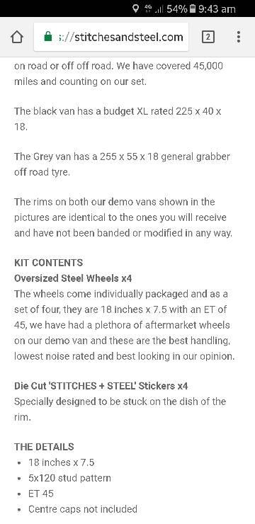

              These wheels, there are 7.5" in width, whereas the genuine Multivan 18" wheels are 8". I have my Multivan on the genuine 18"x8", and handling feels great, much better than it was on the previous 17x7 genuine wheels. 7.5" width will be too narrow for 255 width tyres from the handling perspective.
              Amarok wheels ... the offset is a bit different. I also used tried out the 17x8 Amarok wheels, it was not a pleasant experience, probably due to their different offset.
              If I could find 18x8 steel wheels for Multivan, I'd buy them my self, as I expect them to be lighter than the alloys, as the genuine allows are the power-pressed variety, and thus are very heavy in some designs.
