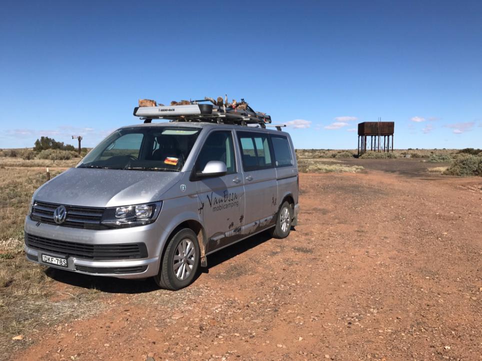

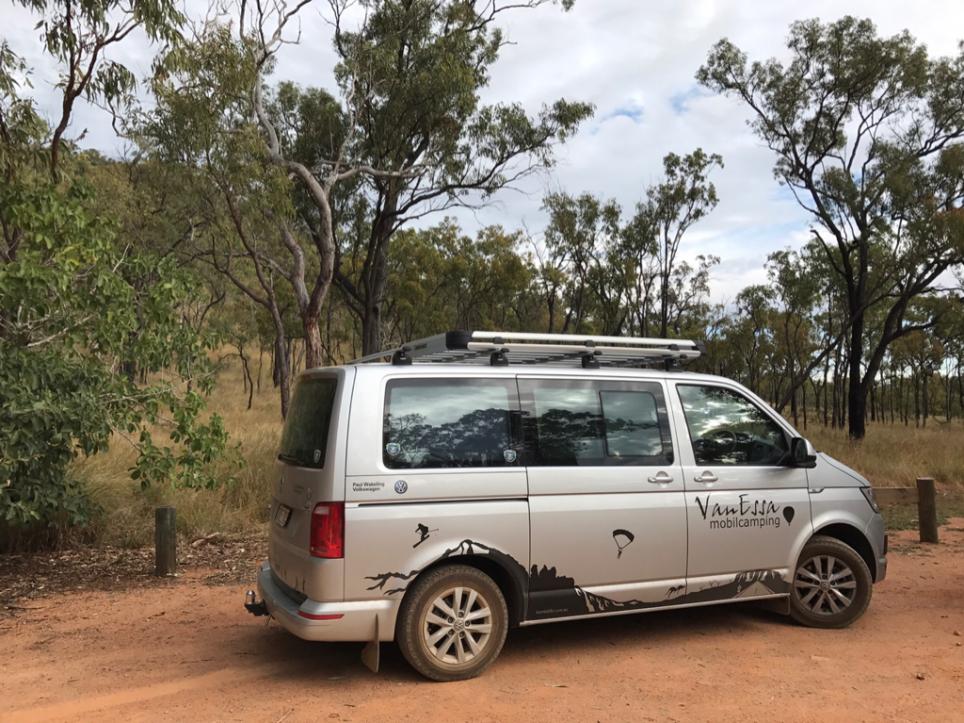

          Hi Paul - we also used Rhino Racks on our T5 4-motion and then the T6 as well. Also put on the light alloy platform rather than the steel. It worked extremely well and preserved more payload from the 100kg maximum allowable (dynamic).
          Became very useful for firewood!
          A couple of photos of the T6
            @goldcoaster @syncro91
