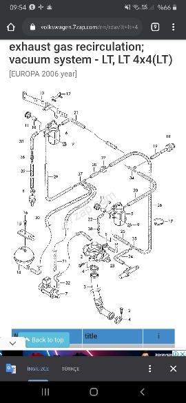

    I have a 2006 LT35 2.5 diesel, would like to replace the N75 valve but there are two valves side be side
    that appear to be the same. Can somebody please tell me why? do they do different functions?
    thank you
    Vic
    Hi vic vic
    my previous car is LT35 LWB ANJ engine, there are 2 n75 valves in this car, they both do the same tasks, one is changing for as much as I know for the other for turbo maybe this picture can be useful.
    SM-M315F cihazımdan Tapatalk kullanılarak gönderildi
      Thank you gokhanyakin
      I guess that means if in doubt replace both.
