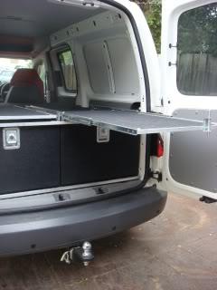

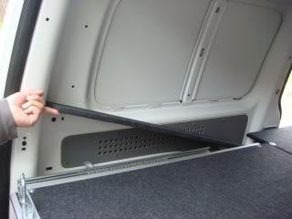

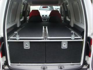

    Hi guys, Only new to the forum and thought i would put up a post of the first stage of the conversion i am doing to her.
    I fabricated a set of drawers that fit into the back of my long wheel base and have cut a piece of foam that is the same size as the back. I am in the process of making a kitchenette that comes out of the side drawer and i have a roll out awning really easily that i attach to the roof racks when i go away for the weekend. I have bought a ten t that i can clip into the awning for when i don't need to use the car but in all honesty i don't know how much i will use it.
    Bought a Hayman Reese style tow bar and fitted it myself and also fitted the module into the wiring harness. All up i did the towbar for under 400 bux with the module.
    I bought the car second hand from the original owner with really low k's and not even a mark or car park dint. He fitted the Audi rims and fat tyres and am slowly fitting it out the way i want it.

                any further info on the drawers ?
                  Drawers
                  Hi Johnny,
                  What did you need to know about the drawers?
                  I made them myself out of 20x20 Gal SHS
                  Rollers i just bought 60 skateboard wheel bearings from China for 26 bux delivered and made the runners myself.
                  each carrier has 2 bearings and there is 2 bearings on the slide that is attached to the drawer on each side.
                  Has 12mm Ply on top and rubber matting on top of that.
                  Locks were only cheap FleaBay items.
                  It has dampened the noise considerably so now i only have to fit insulation to the inner guards, walls, inner door panels and roof.

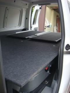

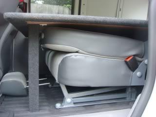

                      If you don't mind me hijacking your thread a bit I'll post up a couple of pictures of my drawer setup. I contemplated building them out of 2mm gal sheet but in the end couldn't spare the time so had a set made to suit and installed.
                        cool, i was going to make mine higher too but it took into consideration the mattress thickness and decided that there wouldn't be enough head room when we sleep in it.
                        Everything i need fits into the drawers and the kitchenette for the side drawer and is nearly finished.
                          ah i see. i didnt need that much room as i did it for a work van, so i made it as high as the wheel arches in the back
                            Pics of my drawer setup and the false floor that bolts over the rear seat when folded down. Also a pic of the wing panels over the wheel arches.
