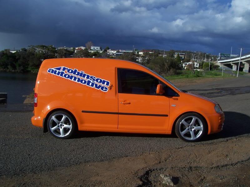

Mine has H&R coilovers in the front and Fulcrum reset the rear leafs. I fitted Koni Mk2 Caddy gas shocks as well and the handling would rival my GTI which has the Koni coilover kit and Whiteline bars fitted. The ride is perfect.

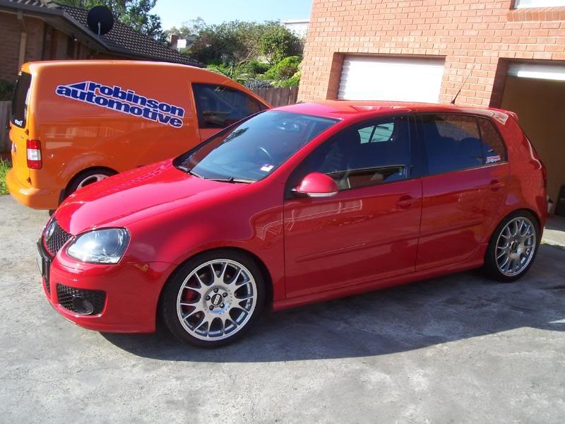

Thanks heaps fellas, I love the thing and because of its great fuel economy the GTI rarely leaves its garage. Its a weekend car until I decide to move it on.
This is the van on the Golfs BBS's.
Still cant get over winning the best watercooled VW from 2000 on at last years DoVW in Vic, though I think a lot of it is in being such a nice bright orange.
