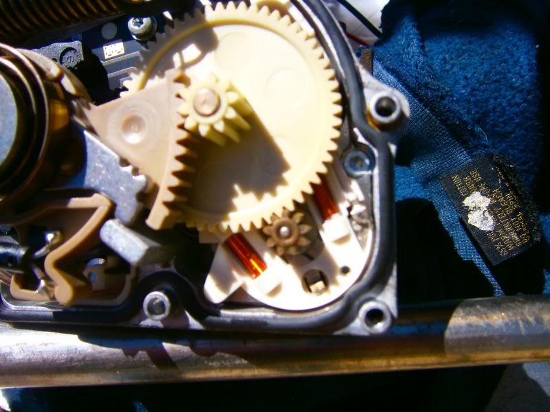

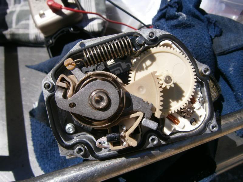

                Here's a view inside the end cover.
                And here's another even closer on the end of the motor.

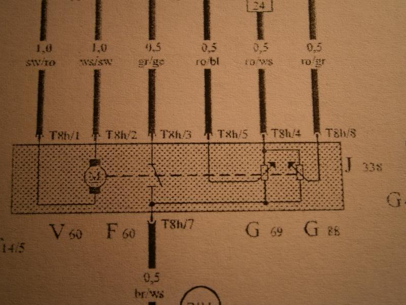

                  I removed the TB again to do some resistance readings. Here is a snapshot of the circuit diagram J338 Throttle valve control unit.

                  I thought I would take the end cover off to see if the contacts on the switch could be cleaned. Inside everything looked identical to the VDO unit except for the switch which has changed from open contacts to a sealed unit.[no chance of cleaning]
