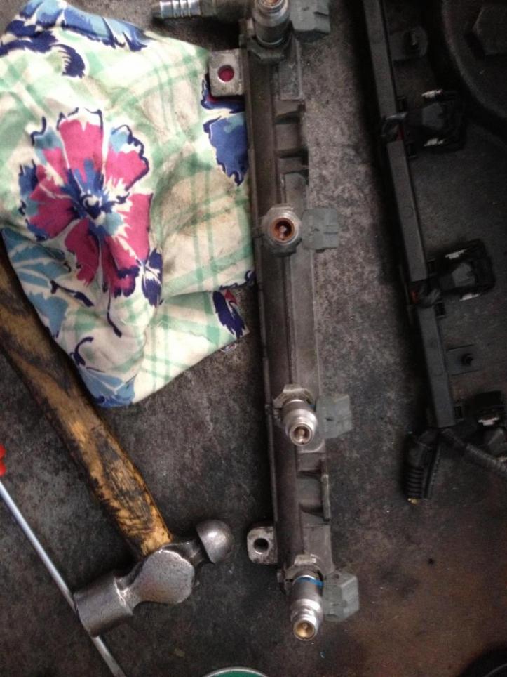

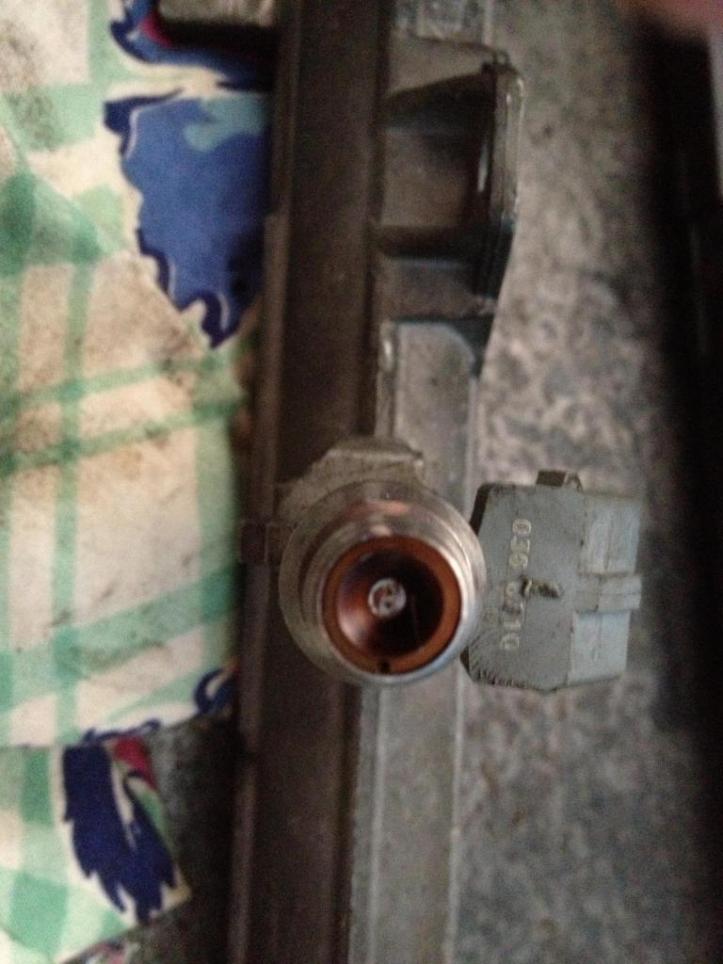

        Hi again,
        I took off the Injectors to see their condition. I think they need to be replaced right?
        What do you think of these Injectors?
        Thanks.
          How was the fuel pressure??
          Alba European
            It's less than 3 Bars. My mechanic told me to have a go by replacing the 4 injectors as these do not look really nice.
