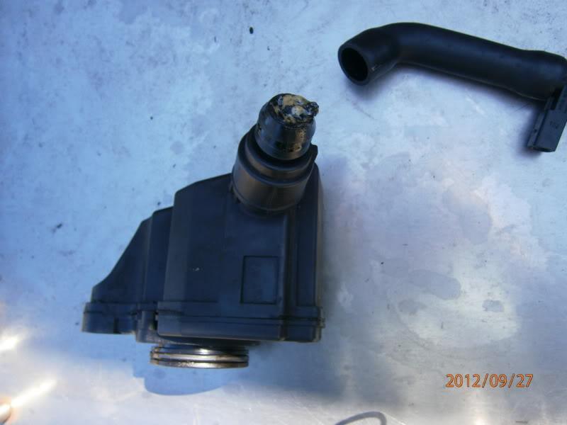

This is a pic of the breather box after a cleanup & removal of the bracket that supports the cable to the starter.

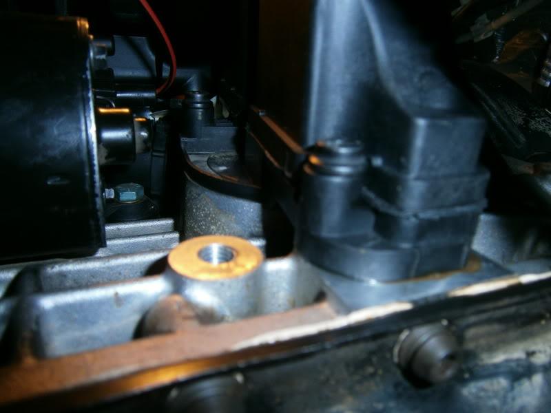

After removal of box[three screws with 5mm allen key] I found the hose & box completely blocked with oil mixed with water, sometimes referred to as mayonnaise.

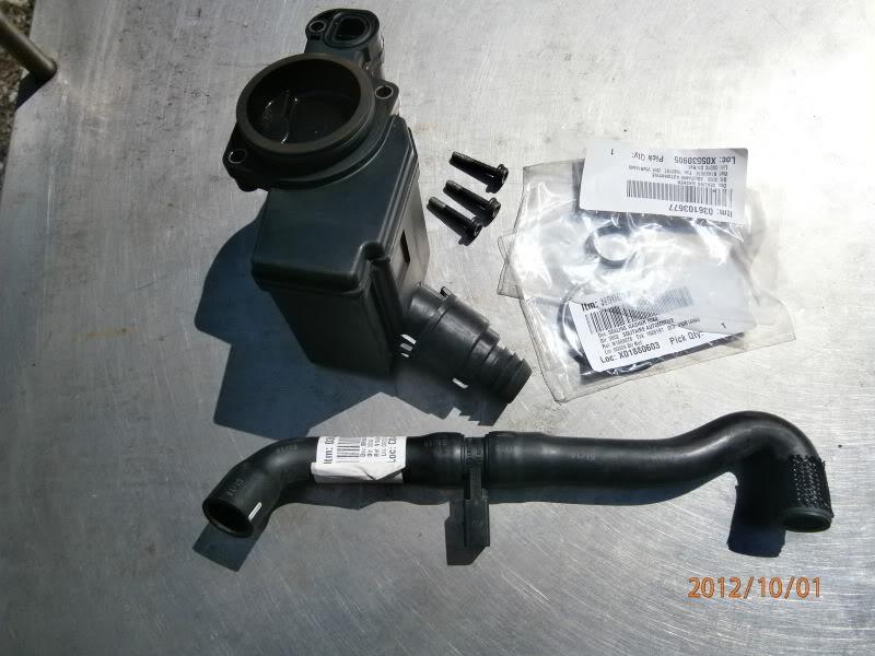

I bought a new hose assy for just over $100 that includes the heating element that was no longer working. I believe it is there for cold climates to stop iceing & blocking the breathing. The rubber hose had gone very soft & when squeezed stayed distorted.
