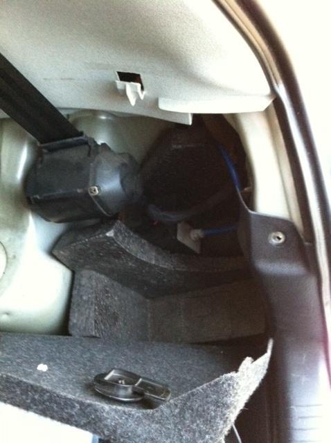

          There actually some gems of information on the Polo in that post. Where is the vacuum pump located on the Polo?
          Cheers,
          Steve
            The pump is located in the boot on the drivers side where the first aid kit should be (neither of mine have one).. here is a pic. Its made by Hella.

                Hi Paul, Pontiff,
                I'm just wondering how you tell if it's the vacuum pump causing issues with the central locking. I really should try and find a workshop manual I guess. Paul, if you have a working Vacuum pump, PM me, and we can strike up a deal. Otherwise, any ideas on finding them, or is VAG the only option?
                Cheers,
                Steve
                  If it is just one door, its either the vacuum box on the locking mechanism or the vacuum hose to the door. If all doors dont work then its probably the pump, but could be the hose running out of the boot.
                  Either way i would not worry too much about it, its not going to be expensive to fix, just somewhat trial and error.

                      Is the VAG dealer the only option for the Vacuum pump? Or are there alternatives? Also, the vacuum hose seems quite tight. What kind of fitting is it? Any easy removal method you can recommend?
                      Cheers,
                      Steve
                        If you can establish that a new pump is required & you don't mind buying SH, they should be available from the wreckers. I had a quick look on ebayUK & they seem to be around 15 pounds.
