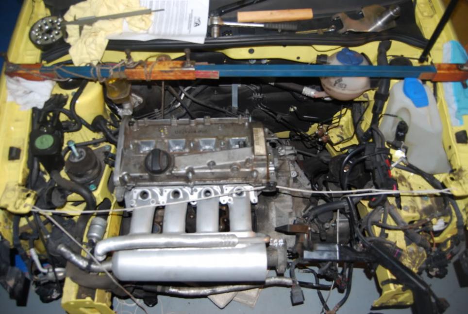

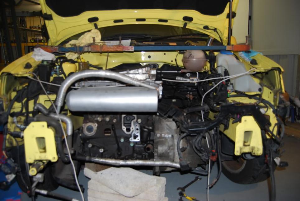

                      This is with both the engine mountings fitted. Now busy with the front engine mount and rear stabilizers. Then we can begin building the engine. Slow going but getting there
                      [IMG][/IMG]
                      [IMG][/IMG]
                      [IMG][/IMG]

                      • #71
                        good news!! keep it up
                        • #72
                          keep it coming, this is looking great!
                          • #73
                            i wouldnt say slow looks like its coming together nicely...
                            • #74
                              What intake manifold is that with the inlet on the passenger side?
                              I could use that to neaten up my rocco intercooling pipework.
                              • #75
                                it is a home made one, used the audi runners and just made the rest. just have to find a good throttle body for the thing now. our crankshaft has finely arrived now to find the correct rods and pistons.
