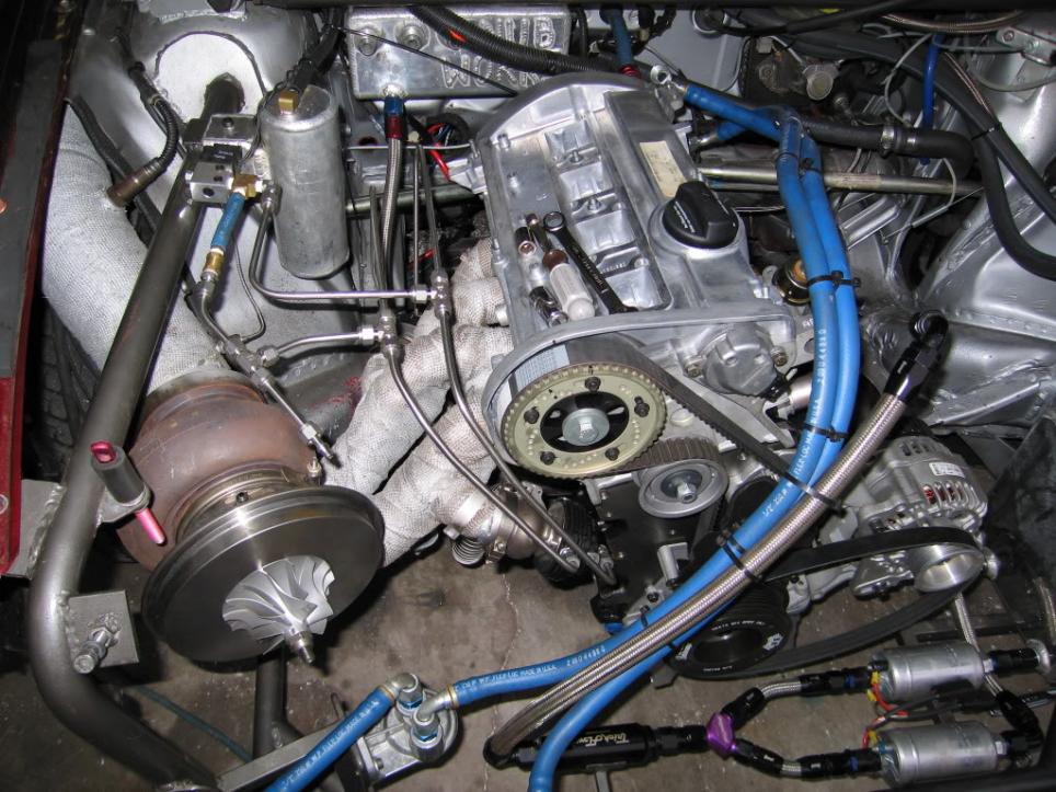

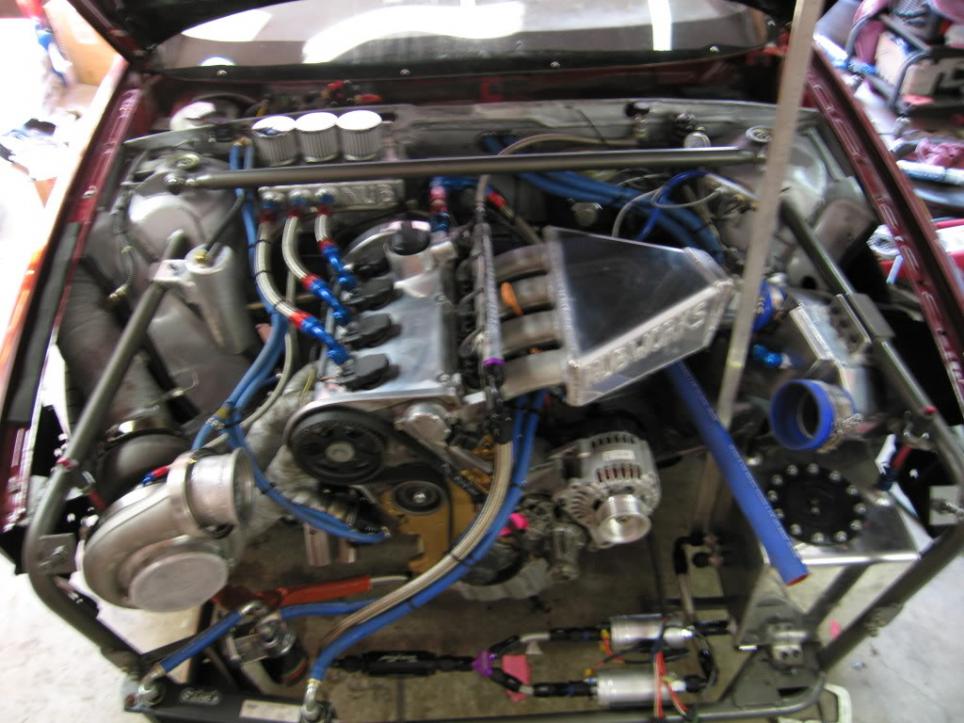

          • I was having a bit of a dig around about others doing the same as you and found this thread: VWVortex.com - pic request: manual tensioner conversion kit from a 16v....
            and LOOK AT THE SIZE OF THIS TURBO!!
            • Cool thanks. I'll have a read of the thread. If its for the engines in the pic, they are 058 longitudinal engines which are different but yeah they probably take the same tensioner.
              I love that integral water to air/plenum - thats sick.
              • no worries, but I figured you'd have already seen that thread, I just lost it when I saw the turbo

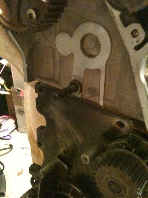

                      • can you post a nice clear picture of the individual parts, and what the stud is meant to look like? surely it's nothing that special
                        • so this is the stud... it shouldn't matter if the stud has the shoulder built in to it, a thick HT washer would do the same job
                          • Rein - 026198243 - Timing Belt Tensioner Stud Kit
                            yeah I just found this. Nut and washer are nothing special so I'm going to be ok there. I just thought that in changing to a different tensioner that maybe face of the tensioner was unique and so used a particular washer but it looks pretty standard fare to me. I'd heard so much about needing a 'stud kit' to go with the roller that I thought it was something special. It may not even need changing as the above Rein part which is listed for the tensioner roller I just bought, doesn't look particularly long. I'll still source something as I don't want to get stuck half way through the job if mine is short. I was thinking the same as you - it wouldn't even really need a shoulder would it as the roller centre is tightened to the head and only the outer ring rotates with the belt, but good practice and all I will try to get the correct shoulder length though.
