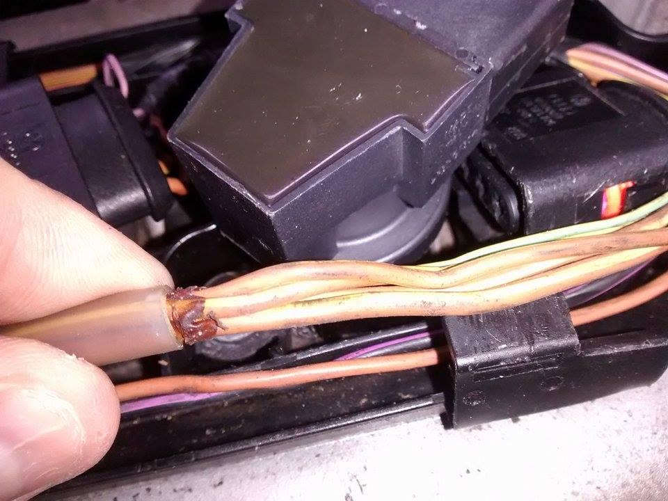

    There does seem to be some sort of after market wiring though.
    This is coming off the connector of the first coil pack.
    I believe this a ground wire being spliced into 4? I have no idea why this is done or if it is stock.

    Those earth splices are std. For each coilpack.
